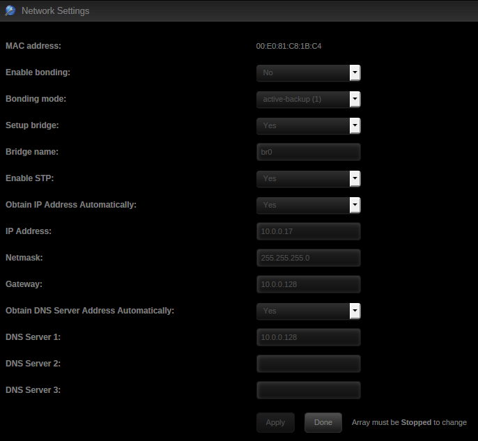

I don't even have IPV6 deployed or enabled on my router or any of my servers. I am perhaps more baffled than you to see it even show up.

I attached the Docker build file used, so you can see there's nothing "custom" in there other than addin in the run time script and install scripts along with the ports and mappings.
I also attached screenshots of the unRAID Network Settings and Docker Settings to show nothing custom there either.
Here's more info from the docker container, which only shows 2 devices using ipv4
root@REAVER:~# docker exec EggDrop ifconfig
eth0      Link encap:Ethernet  HWaddr 02:42:ac:11:00:01
          inet addr:172.17.0.1  Bcast:0.0.0.0  Mask:255.255.0.0
          UP BROADCAST RUNNING  MTU:1500  Metric:1
          RX packets:305 errors:0 dropped:0 overruns:0 frame:0
          TX packets:217 errors:0 dropped:0 overruns:0 carrier:0
          collisions:0 txqueuelen:0
          RX bytes:48737 (48.7 KB)  TX bytes:20590 (20.5 KB)
lo        Link encap:Local Loopback
          inet addr:127.0.0.1  Mask:255.0.0.0
          UP LOOPBACK RUNNING  MTU:65536  Metric:1
          RX packets:0 errors:0 dropped:0 overruns:0 frame:0
          TX packets:0 errors:0 dropped:0 overruns:0 carrier:0
          RX bytes:0 (0.0 B)  TX bytes:0 (0.0 B)

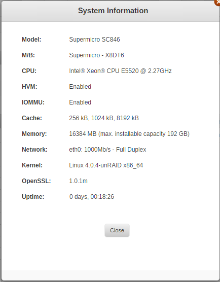

Just wanted to report that System Status is reporting the maximum amount of memory my motherboard can store, rather than the actual amount installed.
Allocated is indicating the actual amount installed.
System Information reports things correctly.
Very minor, but, hey, I like to contribute where I can!
