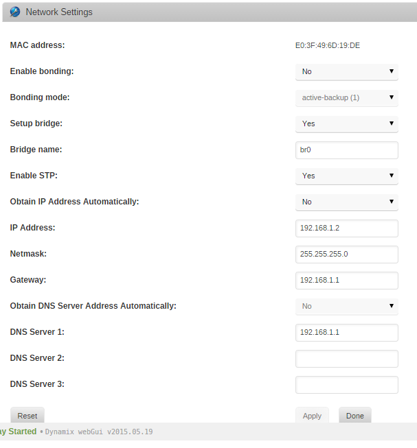

re: docker DNS issue. My server has a static setup. This issue first appeared for me shortly after setting up my first VM's. Part of this initial VM setup was setting up a bridge network "br0" in the unraid network settings. Dockers were running when i set this up.
What did you have to do to get your containers back online?  If you did the Network type host/bridge toggle that would work, but wondering if that's what you did and whether you might have first tried stop/starting containers again.
One thing we added in -rc5 was insisting that array is Stopped to change network settings.  This also ensures containers and VM's are also stopped when network config changes.
I tried restarting the containers and that did not work. Doing the host/bridge thing did work, which is when I created the defect report :)

still no change with the docker dns issue..
Please try these commands and post output:
cat /etc/resolv.conf
cat /etc/hosts
hostname
Then pick one of your containers with no dns and type:
docker exec <container-name> cat /etc/resolv.conf
docker exec <container-name> cat /etc/hosts
docker exec <container-name> cat /etc/hostname
replacing <container-name> with the actual container name.
I have a new docker (RDP-Calibre) that works fine on my local network but can't resolve the server via DNS.  My other dockers do both just fine.
