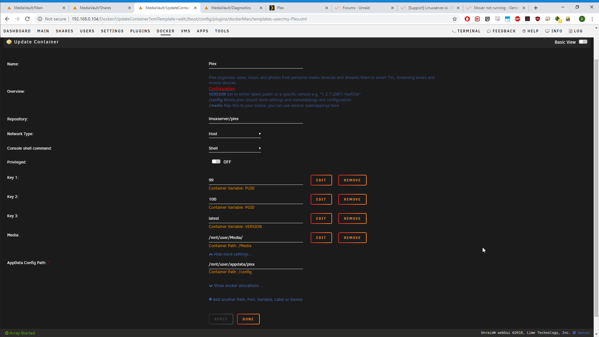

Arcaeus Posted April 20, 2019 Share Posted April 20, 2019 So I reinstalled this after my flash drive died. It installed and connected fine, but now when I try to play back my media, it can't find the file. I tried a Rescan of Library files, but that didn't seem to do anything. Here is the error I get: Thoughts? Quote Link to comment
Squid Posted April 20, 2019 Share Posted April 20, 2019 13 minutes ago, Arcaeus said: So I reinstalled this after my flash drive died. Did you add back to the template any/all of the path mappings which you had originally added to Plex? Quote Link to comment
Arcaeus Posted April 20, 2019 Share Posted April 20, 2019 3 minutes ago, Squid said: Did you add back to the template any/all of the path mappings which you had originally added to Plex? I just put the /Media mapping back as I thought that was all I needed. I didn't have the backup of my config file which was a mistake on my part, so I'm trying to remember exactly how I had the whole thing set up. Here is what I have for the template mappings: Quote Link to comment
trurl Posted April 20, 2019 Share Posted April 20, 2019 2 hours ago, Arcaeus said: Here is the error I get: That means it knows about the file, but can't find it. So it must be seeing your appdata, which is where your plex library is, but you haven't mapped your Media the same as before, so it can't find the file where the library says it should be. 2 hours ago, Arcaeus said: Here is what I have for the template mappings: That looks like it would work, if and only if, that is what you had before. With that mapping for your Media user share, Plex would see it at /Media. It must be exactly the same as you used before, including matching the same upper/lower case you used before. And the fact that it couldn't find anything when you rescanned also suggests you have the wrong container volume, since it is just going to look in the same place you set it up before. For example, if you used /media for the container volume before, then that is where the library thinks it should be, not /Media. Also, you should always have a current backup of your flash drive. Go to Main - Boot Device - Flash - Flash Backup to download a zipped copy of your flash any time you change any settings in the webUI. 1 Quote Link to comment
Arcaeus Posted April 20, 2019 Share Posted April 20, 2019 @trurl So then rather than retrying all sorts of different paths, does it make sense to just delete the libraries in Plex and re add them? because all the files are the same and they've already been named properly and all that, the paths just need to be rebuilt so it can see it properly. Quote Link to comment
Arcaeus Posted April 20, 2019 Share Posted April 20, 2019 Nevermind, I solved it. I had the container path as /Media when it was mapped in Plex as /media. Thank you for your help! Quote Link to comment

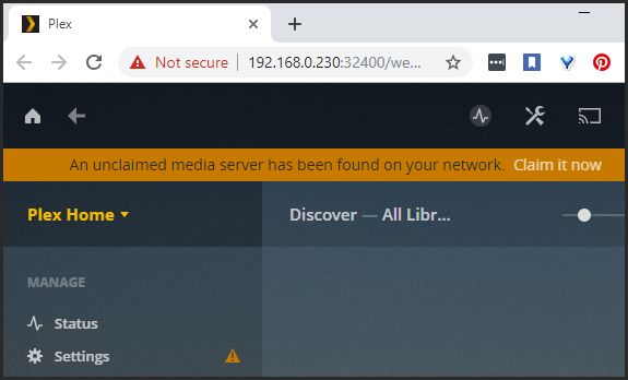

Christopher Posted May 6, 2019 Share Posted May 6, 2019 (edited) I'm having an issue where my Plex Server no longer being recognized. Plex is seeing my server as a new instance with a message on top saying, "An unclaimed media server has been found on your network. Claim it now". My Libraries are missing because it think it's a new server. Here's what led up to this below... 1) I had several cache drive BTRFS errors in my log. Docker apps to would stop or not respond. 2) Searched the forums and found post with similar issues. I tried a few things to fix it with no success. 3) I decided to recreate my cache drive. I disabled docker and VM and moved all cache folders/files to the array. 5) I cleared my cache configuration and deleted partitions on those my 4 cache SSDs. 6) I setup the 4 SSD drives as cache again and formatted. 7) Copied all files back to the cache array. Restarted server. 9) Deleted my docker.img 10) Enabled docker. Docker created new empty docker.img 11) Installed Plex from previous Apps. Config pointed to original folders 12) Started Plex Any ideas? Is there a way to get Plex to see this as my original instance? If I proceed with this new instance and add existing libraries, will Plex automatically use the existing database/files in my config folder? If I proceed with this how will it effect my Tautulli database? Your help is appreciated! Edited May 7, 2019 by Christopher Quote Link to comment
trurl Posted May 7, 2019 Share Posted May 7, 2019 5 hours ago, Christopher said: 7) Copied all files back to the array. Did you instead mean you copied files back to cache? Quote Link to comment
Lyric Posted May 7, 2019 Share Posted May 7, 2019 (edited) I'm having the same issue. My libraries stopped being found so I deleted AppData, etc. Re-installed the Linuxserver plex docker, remapped my libraries and everything is being seen fine. But now I have this same message saying to "claim this server" and I can no longer enable remote access either. How do I go about fixing this? Edited May 7, 2019 by Lyric Quote Link to comment
