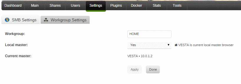

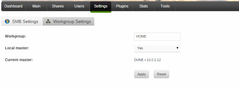

I created an extension to the SMB workgroup settings which checks for the local master browser, and dynamically updates the setting as long as the page is viewed. This allows the user to see any changes in real-time.
See the attachment below.
To obtain the local master browser, I do the following:
# nmblookup -M -- -
10.0.1.2 __MSBROWSE__<01>
The system which has _MSBROWSE_ is the master.
You can also run nmblookup -S WORKGROUP to get a complete overview of all your systems in your network (WORKGROUP is the name of the workgroup in your network).
# nmblookup -M -- -

I added another little item... when the server is the local master browser then an icon in the top right is displayed next to server (see attachment). Again this is dynamically updated so users know all the time their server is local master or not.
