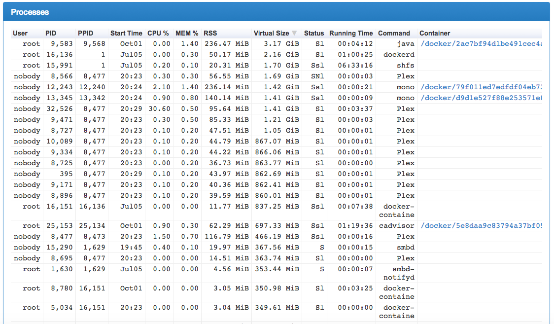

Realize this is an old topic, but wanted to get some advice.
I used cAdvisor to find the largest offenders but am not sure the best way to clean it up, I could certainly do a full re-load, wanted to ask before I went that route.
Thanks!
