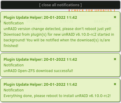

Today I released in collaboration with @steini84 a update from the ZFS plugin (v2.0.0) to modernize the plugin and switch from unRAID version detection to Kernel version detection and a general overhaul from the plugin.
When you update the plugin from v1.2.2 to v2.0.0 the plugin will delete the "old" package for ZFS and pull down the new ZFS package (about 45MB).
Please wait until the download is finished and the "DONE" button is displayed, please don't click the red "X" button!
After it finishes you can use your Server and ZFS as usual and you don't need to take any further steps like rebooting or anything else.
The new version from the plugin also includes the Plugin Update Helper which will download packages for plugins before you reboot when you are upgrading your unRAID version and will notify you when it's safe to reboot:
The new version from the plugin now will also check on each reboot if there is a newer version for ZFS available, download it and install it (the update check is by default activated).

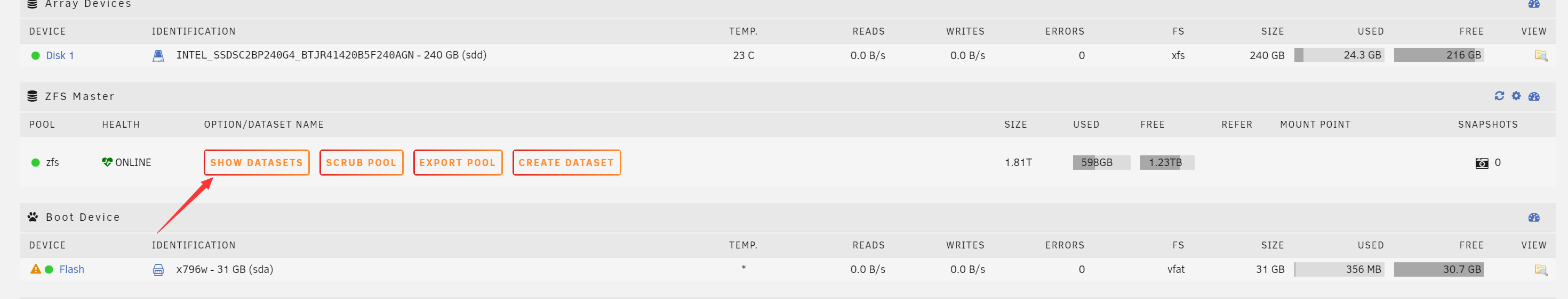

I'm trying to mount an existing ZFS drive that I pulled from a freenas setup (not raid). I  setup a ZFS pool pointing at the drive thinking it would mount the contents of the drive under the pool that I just created. Looks more like it replaced the existing pool with a new one that thinks the drive is empty. Any advice on recovering and mounting the drive?

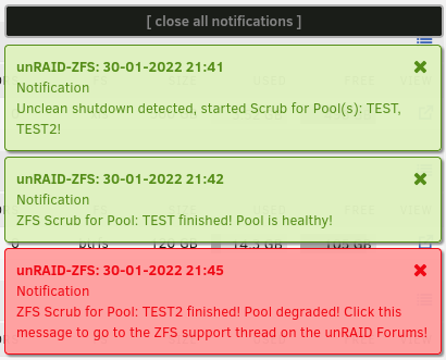

Updated the plugin to v2.1.0 so that it now a scrub from every ZFS Pool is executed after a unclean shutdown of the system and you will be notified when the check for each individual pool finished and if the pool is healthy or degraded, you will be also notified if you have setup individual scrubs from your pools.
If you want to disable this feature execute this from the command line:
sed -i '/unclean_shutdown_scrub=/c\unclean_shutdown_scrub=false' "/boot/config/plugins/unRAID6-ZFS/settings.cfg"
and if you want to enable it if you have already disabled it:
sed -i '/unclean_shutdown_scrub=/c\unclean_shutdown_scrub=true' "/boot/config/plugins/unRAID6-ZFS/settings.cfg"
This feature is turned on by default.
The notifications will look something like this:
Please ignore if you get a message after updating the plugin that the scrub is finished for your pools.

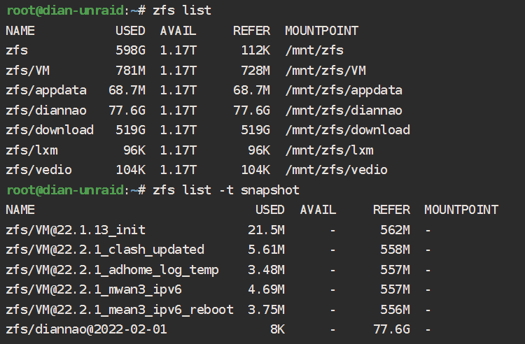

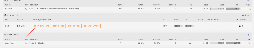

Why can't I display the dataset information in the webui after I updated this version.
No response when i clicking the button. and no useful information in the webui logs.
But the zpool actually contains not only the dataset but also the snapshot.
Edited by diannao
I don't think that this update has anything to do with that since nothing changed that would prevent this.
Is this the plugin from @Iker maybe he can help with that.
That's weird, I already updated zfs to the latest version and never saw that problem; could you please share your ZFS & ZFS Master plugin version?
7 hours ago, Iker said:
That's weird
Yes, I also think so.
Have you tried to reboot the whole server yet?
I've certainly tried restarting the server, but it still does not work

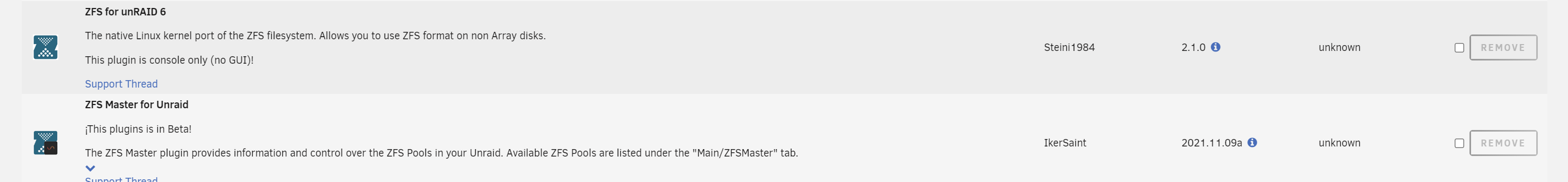

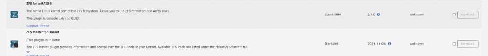

Here is my version
This is really strange, since already said above, nothing was changed that would prevent this, the Kernel module and the applications completely the same, there where only a few lines added and ZED runs now in background but that should not harm the functionality from @Iker's plugin.
Works ok my test system and shows datasets and correct snapshot count.
Edited by SimonF
