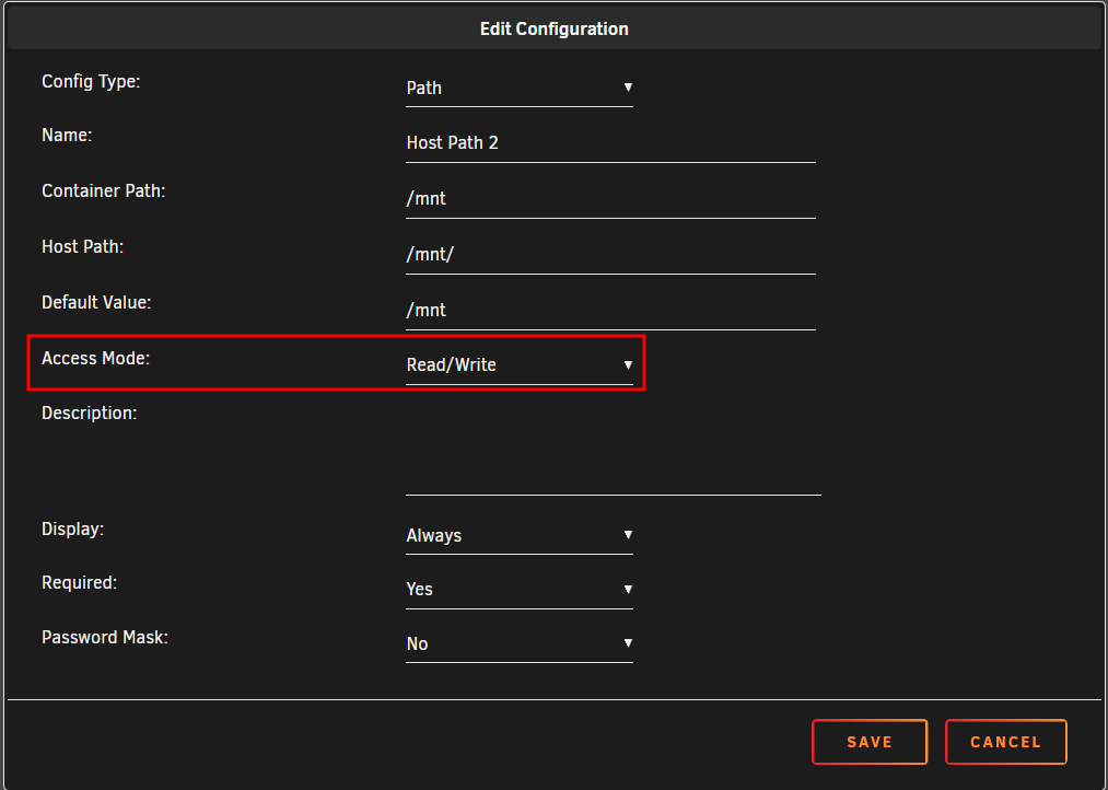

    may start like this   change UID > 99 GID > 100 remove GIDLIST <<<< delete this entry   check /mnt > edit > check if its read / wri

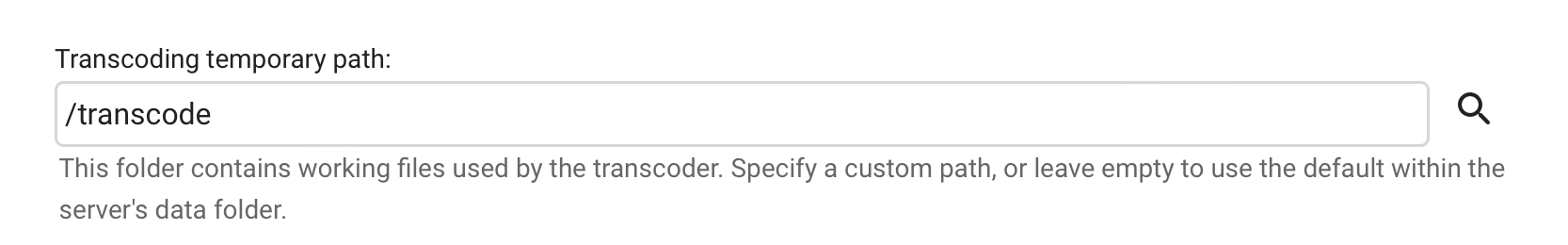

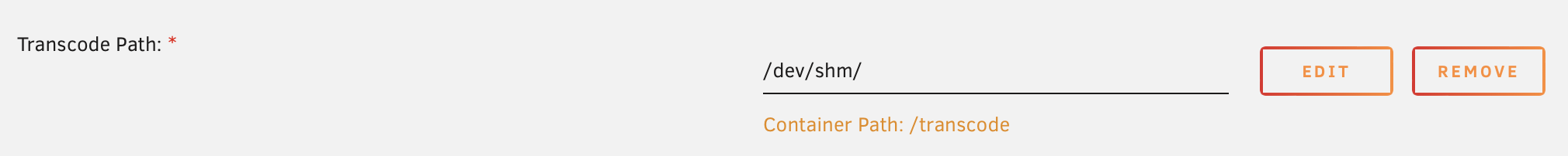

On 12/5/2022 at 8:31 AM, CS01-HS said:
Also consider a transcoding path outside the docker image. I have mine use RAM (to minimize SSD writes) but a path to a cached share works as well.
1025106550_Screenshot2022-12-05at8_14_51AM.thumb.png.e11f75b31471a743565f2c28e75caadb.png
439168156_Screenshot2022-12-05at8_15_27AM.thumb.png.0b26f6c43449dc40a3247286254dcc00.png
NOTE 1: Emby will create the subdirectory transcoding-temp under your specified path. (In my case that's /dev/shm/transcoding-temp)

may also show your mount settings from your docker, they are not set to read only ?

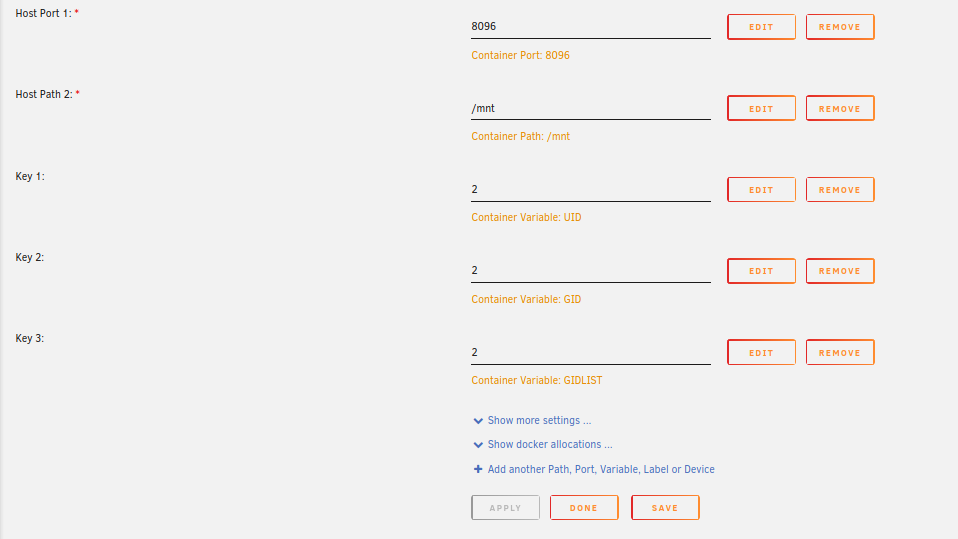

I'm pretty new to Docker, and am confused about how to setup Emby with the right access to view various shares.  I ave this right now, from a fresh install...
So my different media are all in different shared folders.  The container says to choose /mnt as the path, so I left it there.  I can select the folders direct through the disks in Emby this way, but it doesn't have permissions to read the files or write the images and info into the folders.  I add things, and Emby doesn't pull them in.
Is there some user I need to create and grant it access to the share?  Like an "Emby" user, and give it read/write to the various shares it needs access to?
Also, what are these "UID, GID, etc...?  Is that the user to run as?   There is very little information I can find in the interface to tell me how to set up/best practices...  I'm not concerned with any remote access for the time being, I just want it running inside the house.
Any help would be great...
Thanks.
may start like this
change
UID > 99
GID > 100
remove
check
/mnt > edit > check if its read / write or may read only
6 hours ago, alturismo said:
may start like this
change
UID > 99
GID > 100
remove
check
Outstanding!  The UID/GID was the culprit.  Thank you very much!
