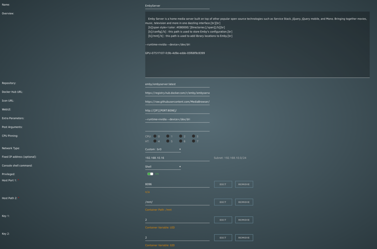

    may start like this   change UID > 99 GID > 100 remove GIDLIST <<<< delete this entry   check /mnt > edit > check if its read / wri
How can I change the docker port mapping for Emby.  I'm trying to change it from the default of 8096 so that I don't have a conflict with my legacy Windows-based Emby server that I want to keep running until I get the bugs worked out of the UNRAID server.
Is this really the emby docker you are using? Doesn't look like this one is in Apps anymore. You can go directly to the correct support thread for any of your dockers by clicking its icon and selecting Support.
I don't use emby but it looks like the 2 versions on the Apps page already have bridge networking, so you should be able to just change the host port (but not the container port).

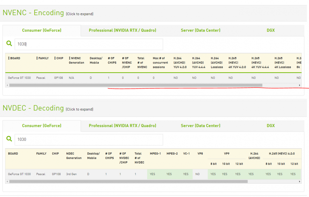

Having issue with Nvidia transcoding. It looks like I have everything setup including --runtime=nvidia  and both nvidia visible devices along with nvidia driver capabilities set and Emby sees the nvidia card but when I run emby from a browser it shows only software encoding not hardware encoding. I do not have VM's nor am I using the nvidia passthrough for any other dockers. Did I miss something?
Edited by mbppg
Thats because your GPU does only support decoding... on the nvidia website you can see that encoding is not supported from your gpu

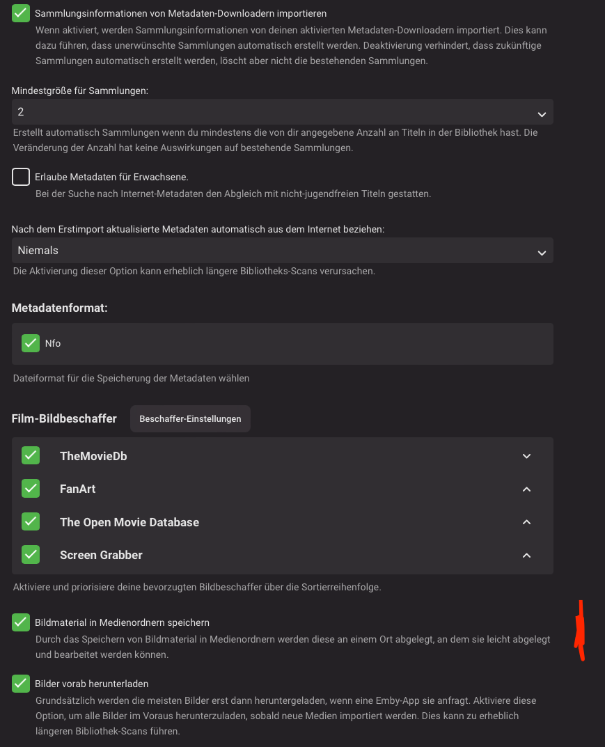

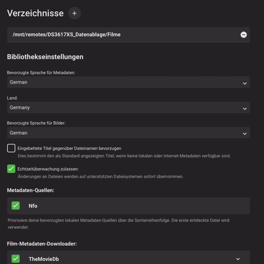

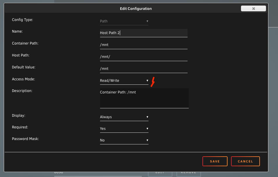

Hello @all
I have the following problem. Emby does not store the meta data and images in the media folders. If I add the data manually to the folders emby loads them without problems. I suspect a permissions problem but can't solve it myself.
Emby is running as a Docker container on a Unraid host system. Here also runs a virtual machine with Xpenology (Synologys DSM) which shares a SMB share with Unraid and provides emby. On it are the libraries of the movies. This SMB share is mounted via Unassigned Device Plugin and here I also looked if there are any READ WRITE permissions, but found nothing.
I have made the appropriate settings in the libraries, see screens:
On the Emby Dashboard page, contrary to the above settings, the paths for the meta data are not traced back to the media directories, but are located in the config folder of the emby Docker container...
When I look at the path in the emby container for the media library everything is set correctly there. I created the whole "mnt" folder for all internal host hard disks from the UNraid host itself and from the SMB shares instead of just the SMB share. Everything together has read and write permissions according to the dialog. See for yourself on the screenshots:
I hope you guys can help me to solve my problem. And yes in futher i will use a native unraid system where the data drives will also connected to unraid and not to a vm ...

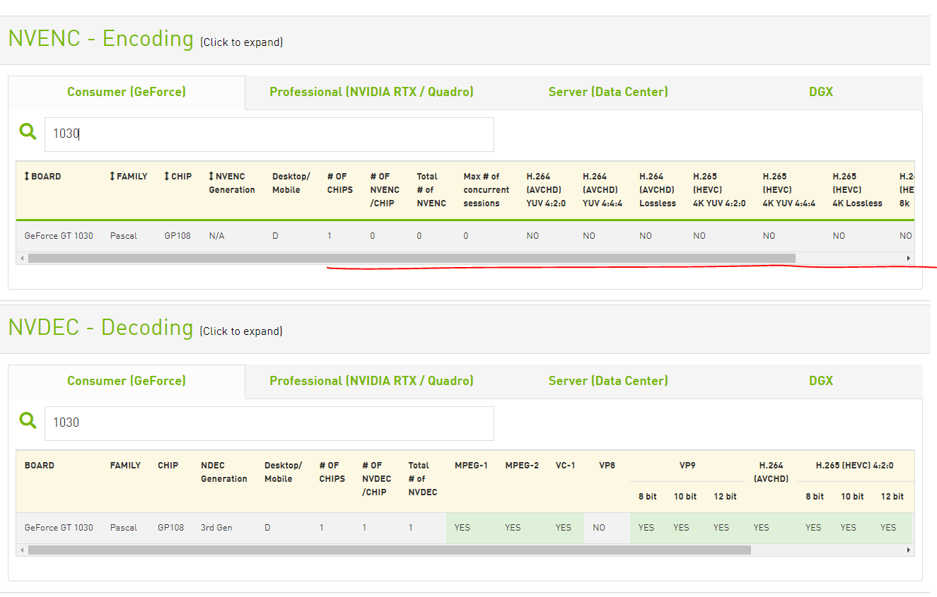

Thank you @WowaDriver for catching that. What is weird is that hardware transcoding works in Plex on the same server. I do have a couple of Nvidia Quadro cards, I just need to find/get the half height brackets for them to install in my server.
the GT1030 doesnt have NVENC so this cant work like described, you may use a intel system and have /dev/dri vaapi active instead ?

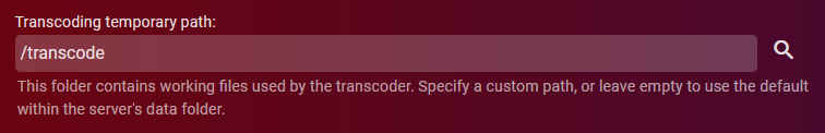

Out of curiosity I would like to try transcoding to ram in emby.
If I have understood it correctly you have to enter the following in Emby Docker
in "Extra Parameter": --mount type=tmpfs,destination=/transcode,tmpfs-size=4000000000
And in Emby in "Transcoding temporary path": /transcode
Is it still necessary to use the script which deletes data after a certain time so that the ram doesn't overflow or has something changed in the meantime?
may check the emby forum if its solved meanwhile
emby transcoded files resist in the path as long as the stream is played, reason from emby team, so you can easy skip back without another transcode.
I found the following on the Emby forum
https://emby.media/community/index.php?/topic/79091-make-sure-i-understand-size-requirements-for-the-transcoding-directory/#comment-804641
In a post from July 8 the admin said the following:
"If the server detects low disk space then it will clean up transcoding segments on the fly as you go in order to conserve space."

Wondering can anyone help/advise me here, I'm having a very intermittent problem with a "Docker Image Disk Utilization of 100%" error popping up for me. I'm on Unraid 6.11.1 (though this has happened to me on previous release versions too), and running the latest Emby as of writing (4.7.8.0, though again, previous releases threw this error up too.) Last night I got an alert about this error, and then ~5 mins later another alert to state the utilization had returned to normal levels, so I wasn't able to check anything really. I feel it's a transcoding issue, and something screwed up with my directory config perhaps? My cache pool is x2 1TB SSD's in a BTRFS pool. I do share parts of my Emby library with select family members, and looking at Emby when the error popped up last night, there was indeed a family member logged in a consuming media.
My setup is as follows:
Folder on cache pool for Emby transcoding is - "/mnt/cache/appdata/EmbyServer/transcode/transcoding-temp"
My Emby server is then configured to use the container path of "/Transcoding" which is pointed to the host path of "/mnt/cache/appdata/EmbyServer/transcode"
If I then play media on my LAN and select a low quality version, I can see the "/mnt/cache/appdata/EmbyServer/transcode/transcoding-temp" starts to become populated with files/folders....so I THINK Emby is correctly transcoding onto my SSD pool, and NOT within the docker image itself?
Can anyone help/advise?
