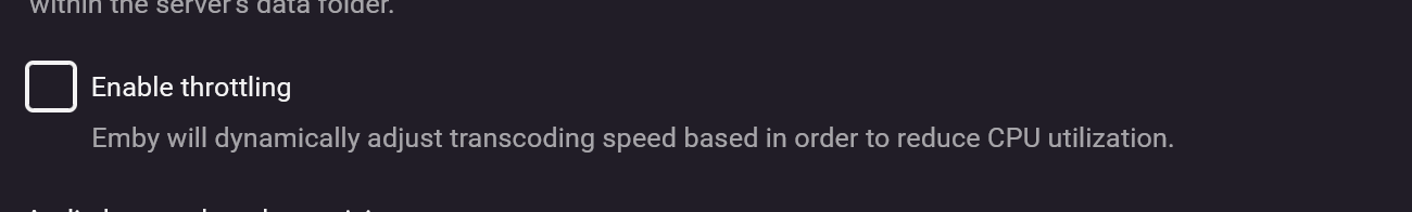

What you're seeing is called transcoding. This happens when your client does not support what you're trying to play. Either the video format, audio format or maybe the subtitle. Here is when transcoding comes in. What it does is change whatever format the client isn't supporting into some format is does support, so it can play the file. This is done by the emby server on the fly and on a default setup is using the cpu of the server. And as you're seeing it takes quite a lot power from the cpu to do this on the fiy. Emby is also setup default to "dynamically" transcode your file which means it will only transcode the first part of a file to reduce cpu utilization (10 min maybe) to begin with so the file can start playing. And when emby sees you're catching up to that point it will start the transcoding again, this way emby always stays ahead a few % not causing the video to buffer.
This dynamic setting in emby is also why you can't skips chapters without causing buffering. Because remember emby only transcodes the first part of the file and keeps ahead a few % at a time. So when you skip chapters the video will start to buffer because that part is not transcoded yet.
You can turn off this dynamically setting in the emby server settings under transcoding. Disable this:
When disabled emby will transcode the whole file from start to finish in one go. So instead of the cpu taking 3-4 min at 80% every now and then it can now maybe take 15-20 min to transcode the whole file. But the nice thing is that you can skip forward as long as the transcoding has caught up to that point.

so you should start what has been pointed already, turn throttle on, turn subs off abd see what happens

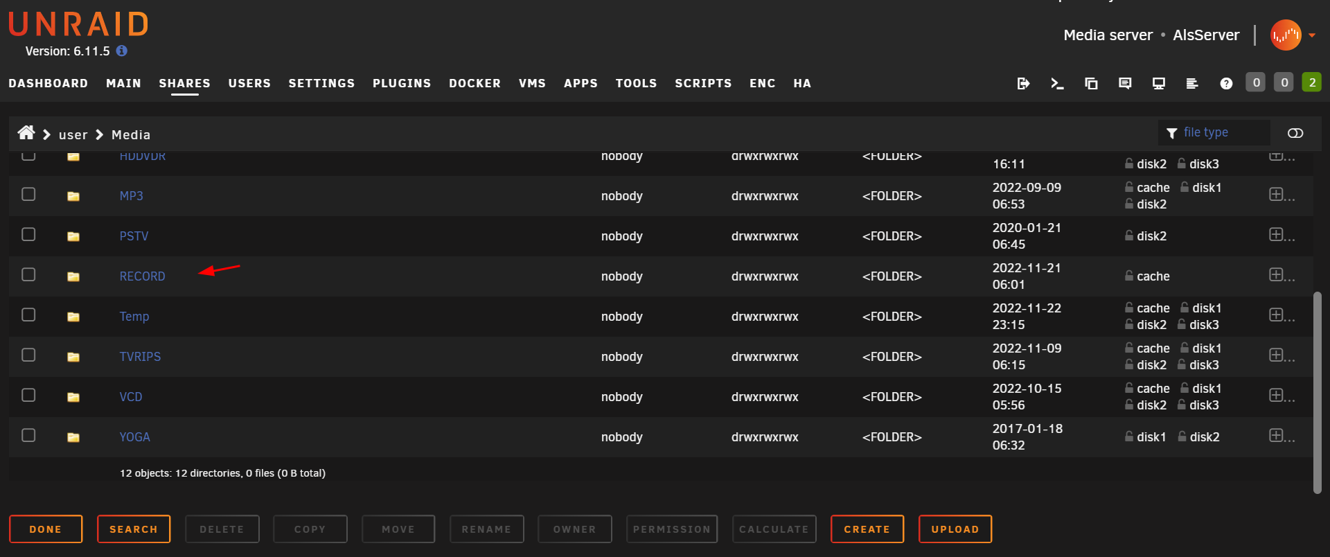

8 hours ago, alturismo said:
may take a look here what permissions are set
and also take a look at the emby log, should be the same message but who knows ;)

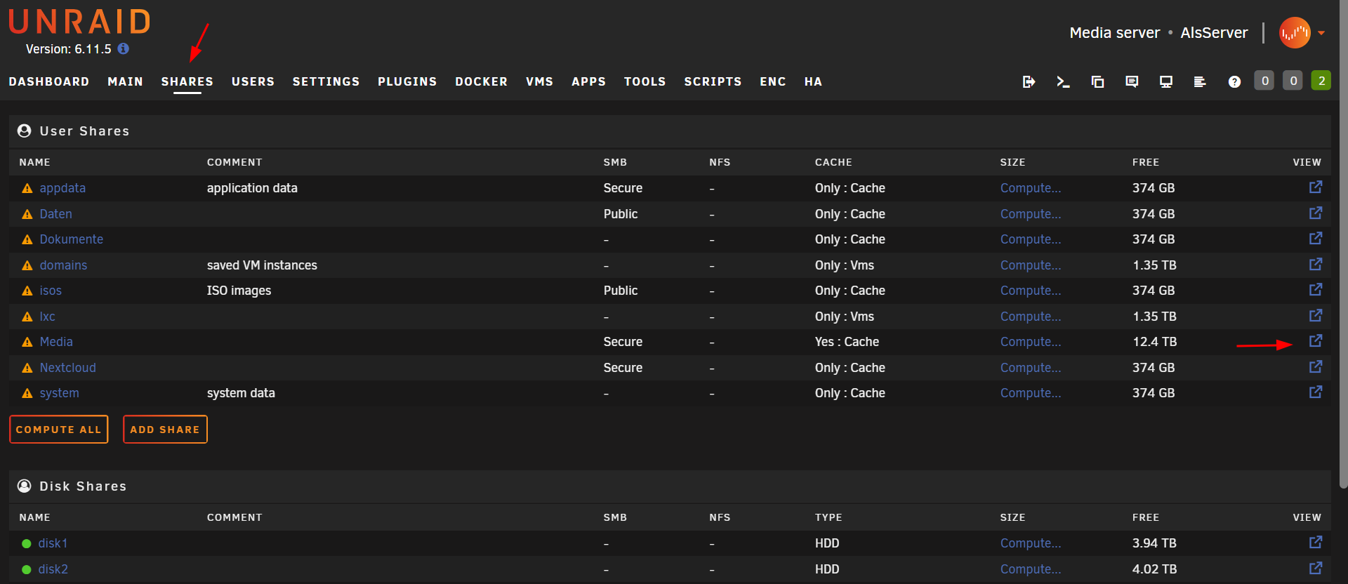

Thank you for the suggestion. I clicked on Shares menu and see a list of my /shares. But how do I get to this screen you have?
klick on the right side to get inside the share
then click though on the left side folder(s)

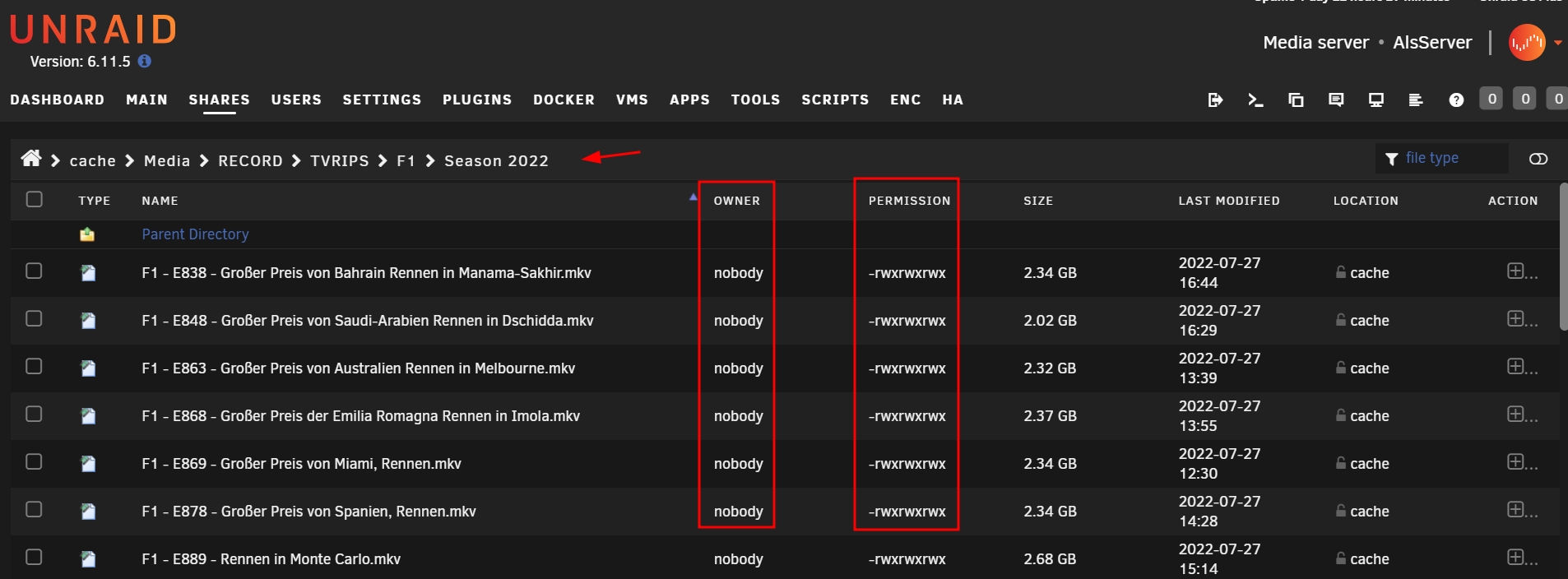

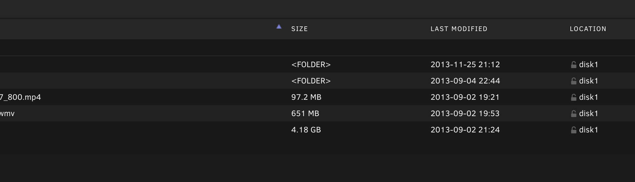

Thank you again, maybe I'm missing something? I got to this screen by clicking into the /shares but the view I'm getting is different from yours. Is there a view setting I missed? I had a look in Settings but don't see anything relevant.

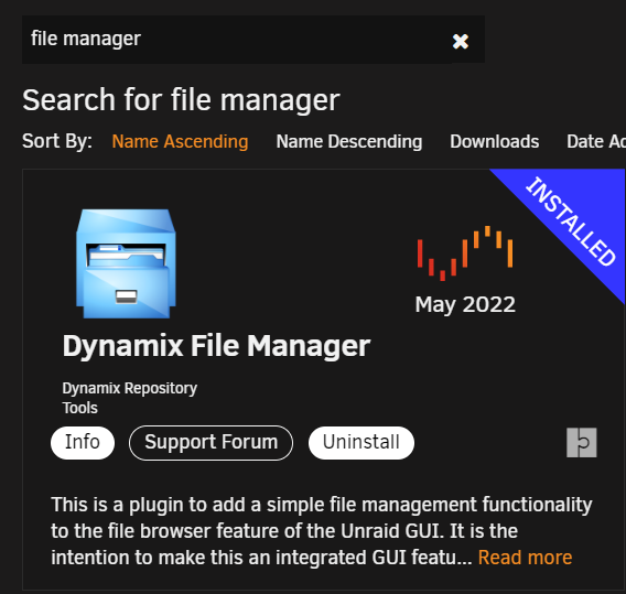

which unraid version are you using ?
The latest, 6.11.5.
1 hour ago, vurt said:
The latest, 6.11.5.
ok, may install this then, this should be it, sorry ;)
i had in mind this is included in the latest unraid version's
otherwise you always also can do something like this from the cli

That's really cool! Installed it. Still not able to do what I need unfortunately.
Eg. the file's permissions were -rwxrwxr-X, i changed them to -rw-rw-rw-, still can't delete the file from Emby.
1. x is the execution permission (also delete is execute)
2. who is the owner, <nobody> ?
--> make a screenshot ...
3. what does the emby logs say ? anything different from "no permission" ?
