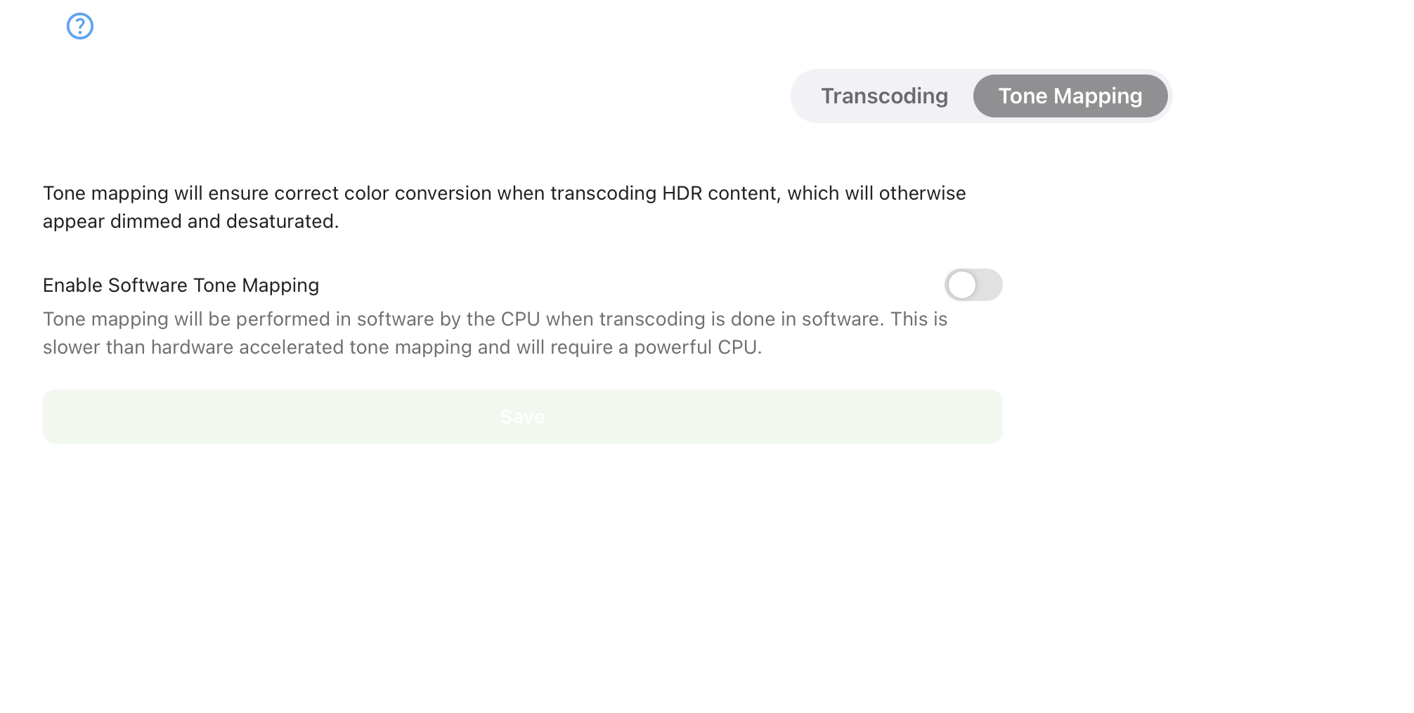

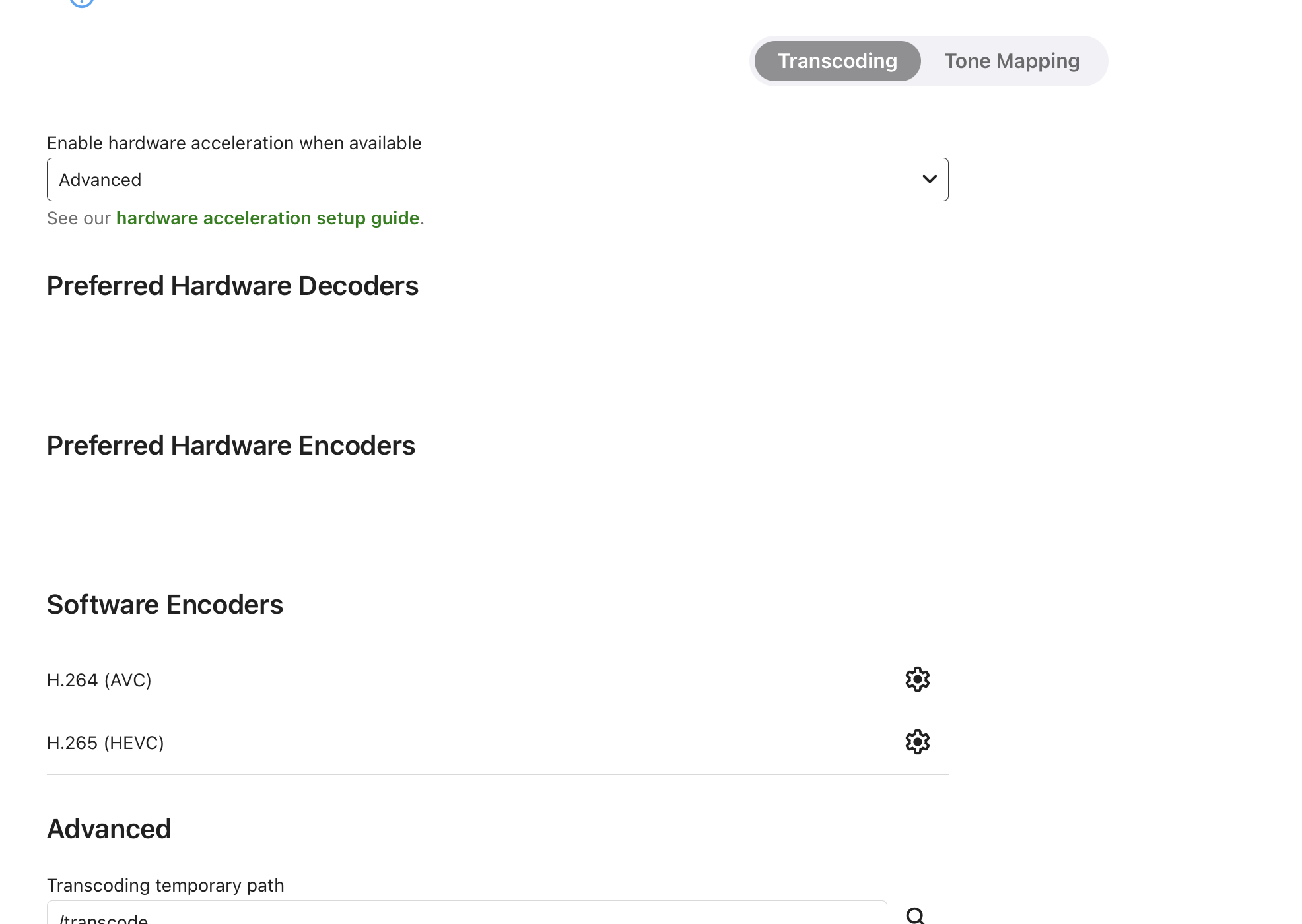

Disable any tonemapping settings, and try again. I found this to be an issue. It works if I turn off tonemapping
I tried disable it but, i still have the error 18 in the log.
With the error, i'm not even seeing the B580 in the webui.
Found this thread. Seems like i'm not alone.
https://emby.media/community/index.php?/topic/135987-issues-with-hardware-detection-failing-on-ubuntu-2410-with-intel-b580/

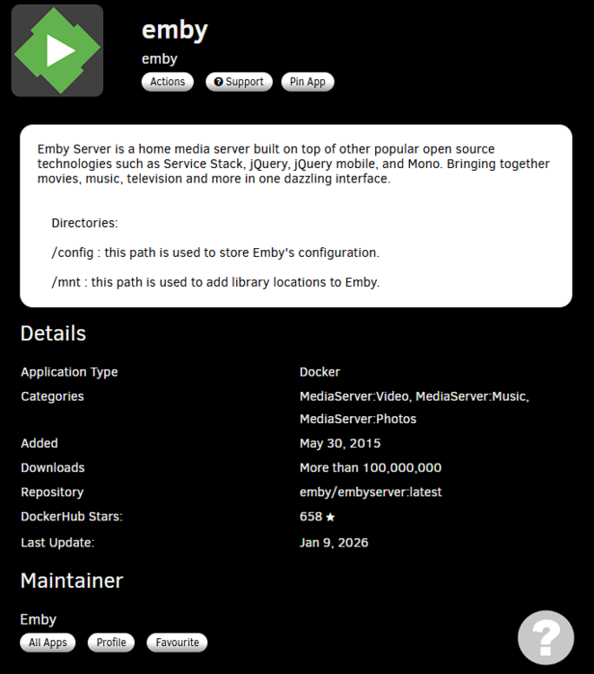

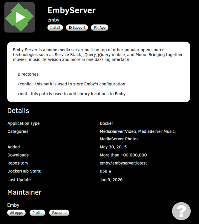

Hi all ... I have Emby installed on my unraid server and very happy with it but when browsing the CA store it only shows EmbyServer instead of emby that I have running as the official version (I know there's a version from linuxserver called emby but that's a different repository).
Info page looks identical for both, should I be switching to the EmbyServer image?
Thanks
Edited by MalH67
Thanks
its the same image and the template is from the same author, I'm guessing at some point the template was renamed, but the old one stuck around for legacy reasons.
in summary, no advantage in trying to use the other template
Thanks for clearing that up, wasn't sure if the name change would affect getting future updates. 👍
