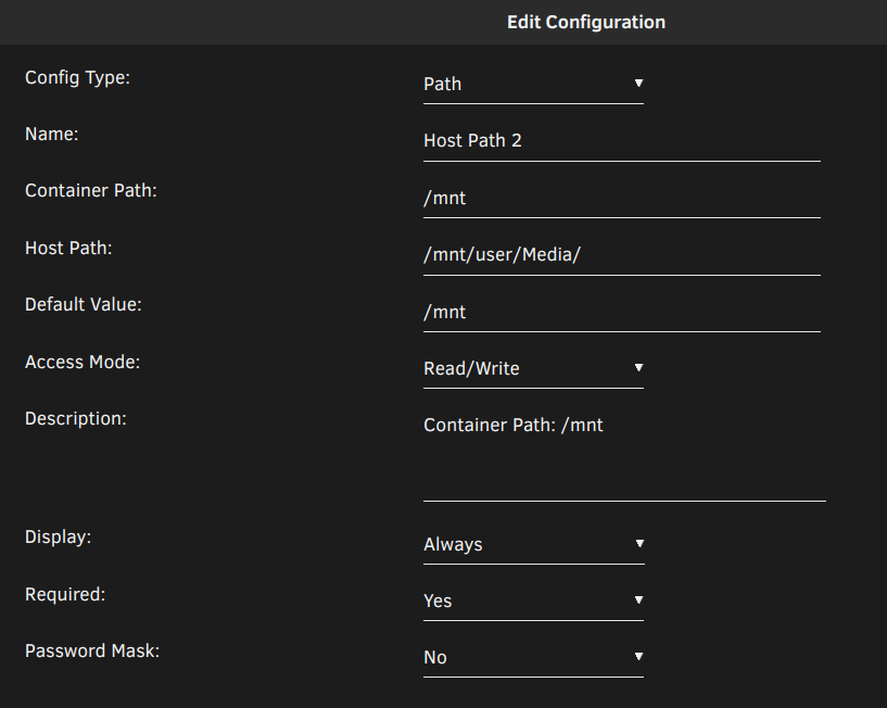

I did try to set my transcode directory to /dev/shm/ and that worked fine until it got full.  So now I need to switch it back to the cache drive but cannot remember what it was.  What does the docker need to be to use the cache drive?  Also what is the container path for Emby?  I swear I've looked for this but cannot find it.  Thanks
8 hours ago, alturismo said:
@ur6969 whatever you mapped in your docker template
This is what I can't remember.  I currently have it on /mnt/cache/emby and it seems to work.  Is that an ok spot?
may post a screenshot from your mapped window, something like this where you configured your cache drive

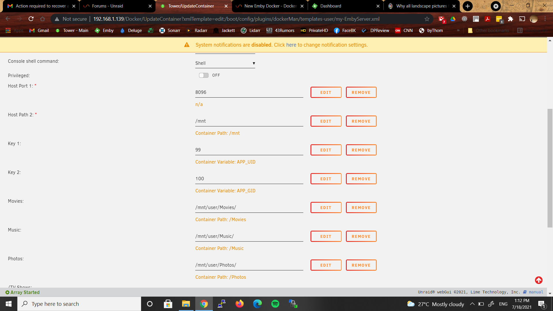

I'm wondering if something recently broke in terms of viewing photos? For some reason Emby is no longer view the jpgs in my photos folder. It was last working a few weeks ago...as far as I recall. I checked the docker config and it's still set to
/mnt/user/Photos/
Container path is /Photos
If I go to the Emby Server library and check the config it's still set to /Photos
I reran an scan of the library. I can see the subfolders for my trips but each subfolder shows no files. They are all jpg.
I even created a new library using /Photos and same thing.
On the unraid tower shares tab and click Photos I can see the subfolders and if I click the subfolders it does see the jpgs.
All my other libraries for music and tv shows which follow the exact same structure all still work oddly.
I am running emby server 4.6.4.0
I even restared the docker.
Am I missing something?
