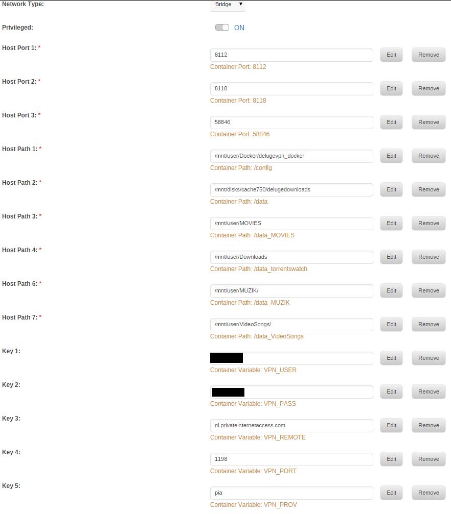

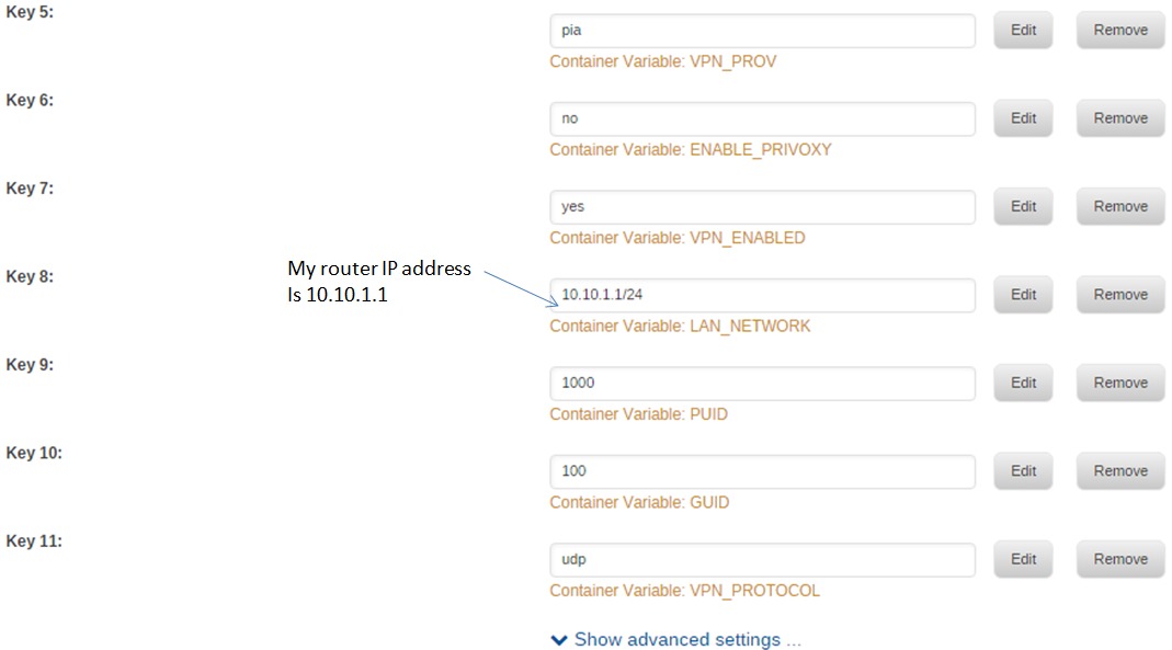

Adding snapshots of my delugevpn docker setup for a fellow user who needs some help. This post is for reference only to share my setup pictures and I am not asking for help!
ok, just so you know the LAN_NETWORK value you have is incorrect, it should be 10.10.1.0/24
binhex - In have set my ip addresses to start at 10.10.1.1. I would think that should be the LAN network value. isnt it?
http://www.subnet-calculator.com/cidr.php
Cool link.... I'm going to have a play around with that.  Thanks jonathan
