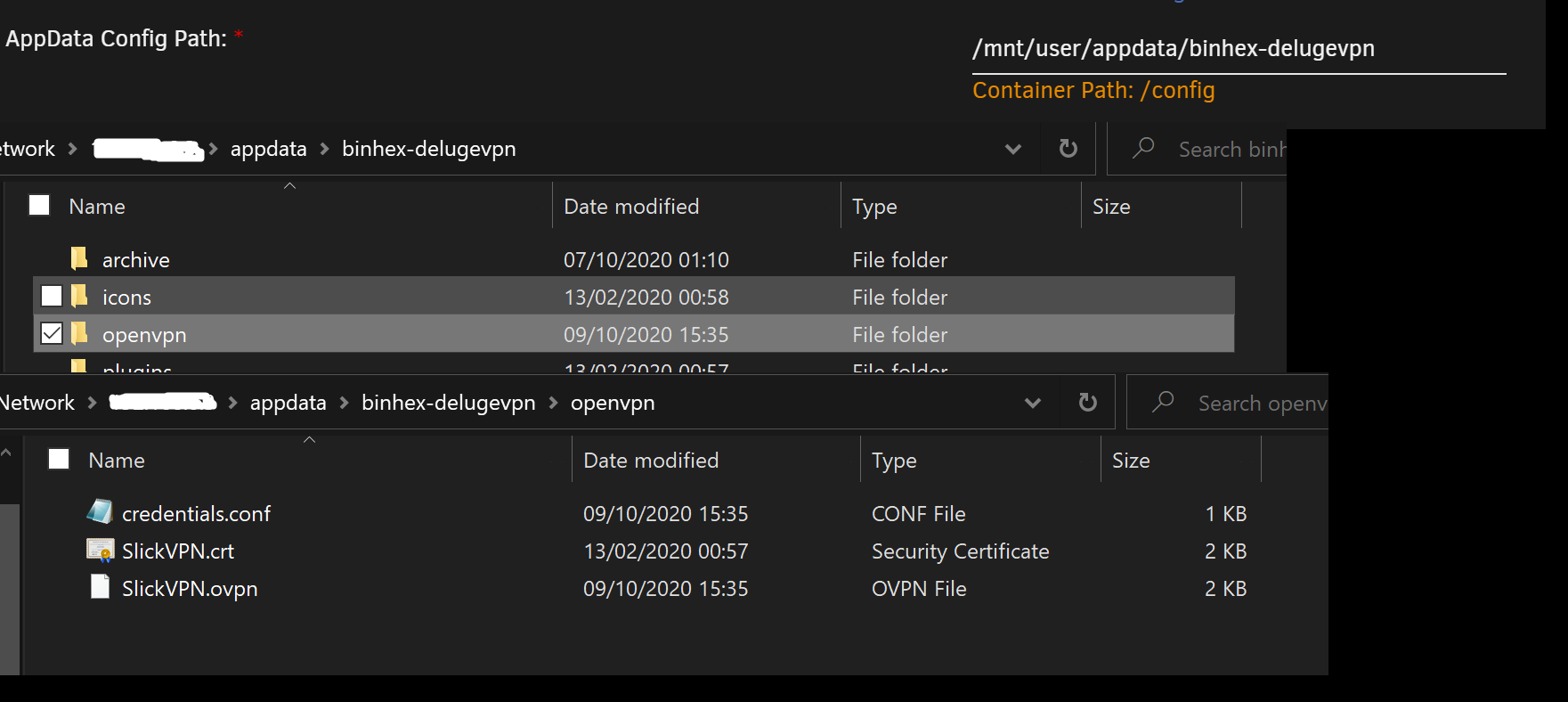

I'm having similar issues, I don't use PIA but I've not been able to connect for a few days.  I can connect using my Windows PC to the same VPN server so I know their server is working.
Attached debug log file, hopefully that helps.
I also have the credential file warning but believe that is just a message to advise the attributes aren't set to restricted user access
*Edit, this log doesn't show the TLS error message shown above but I did see it this morning before making the setting change to debug and uploading here.
its not the same issue, from your log:-
2020-10-09 15:47:53,033 DEBG 'start-script' stdout output:
Fri Oct 9 15:47:53 2020 [VPN] Inactivity timeout (--ping-restart), restarting

Thanks for getting back to me so quickly, I've attached a screenshot of my setup, config path on the docker, openvpn folder within it on the network drive view and then the 3 files required within it.  These files have been there since February when I last changed my vpn provider, the container has been working great until this week.  (I was concerned about the dates being today on the ovpn and credentials files but the docker updates those modified dates when I restart it).
To be completely sure before posting this reply I've just wiped out the folder, re-downloaded the .crt, downloaded a different location server ovpn file and I'm now getting the TLS error in the newly attached log.  Previously I was only seeing it occasionally but now it is repeating frequently.  The TLS error refers to checking your network connection but it must have connectivity as it obtains the IP address of the VPN server in the logs?
delugevpn_log_09102020_v2.txt
from your log:-
2020-10-09 17:06:50,023 DEBG 'start-script' stdout output:
Fri Oct 9 17:06:50 2020 TLS Error: TLS key negotiation failed to occur within 60 seconds (check your network connectivity)
Fri Oct 9 17:06:50 2020 TLS Error: TLS handshake failed
so there are connectivity issues between you and slickvpn, try another endpoint/location, or last ditch is to contact slickvpn, its no doubt an issue on their end, or an internet connectivity issue on your end.

Damn sorry, should have checked that new server I picked from the website locations list was actually working on Windows *rookie mistake!* 😢.  I've switched to a working one and confirmed it works on Windows where it connects fine.  The docker isn't connecting (TLS message has gone now) it sits at the section below for half an hour then tries again and hangs in the same place, I've attached the new log file for this working server).
