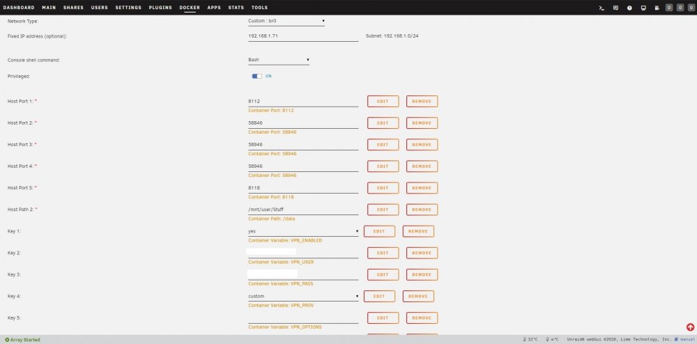

12 minutes ago, nekromantik said:
i tried and same issue so updated original post to remove that line as it happens on both settings
If sonarr and radarr also are on a custom bridge network that's why. They all need to be on the normal bridge. All containers using a custom bridge network are isolated from the host.

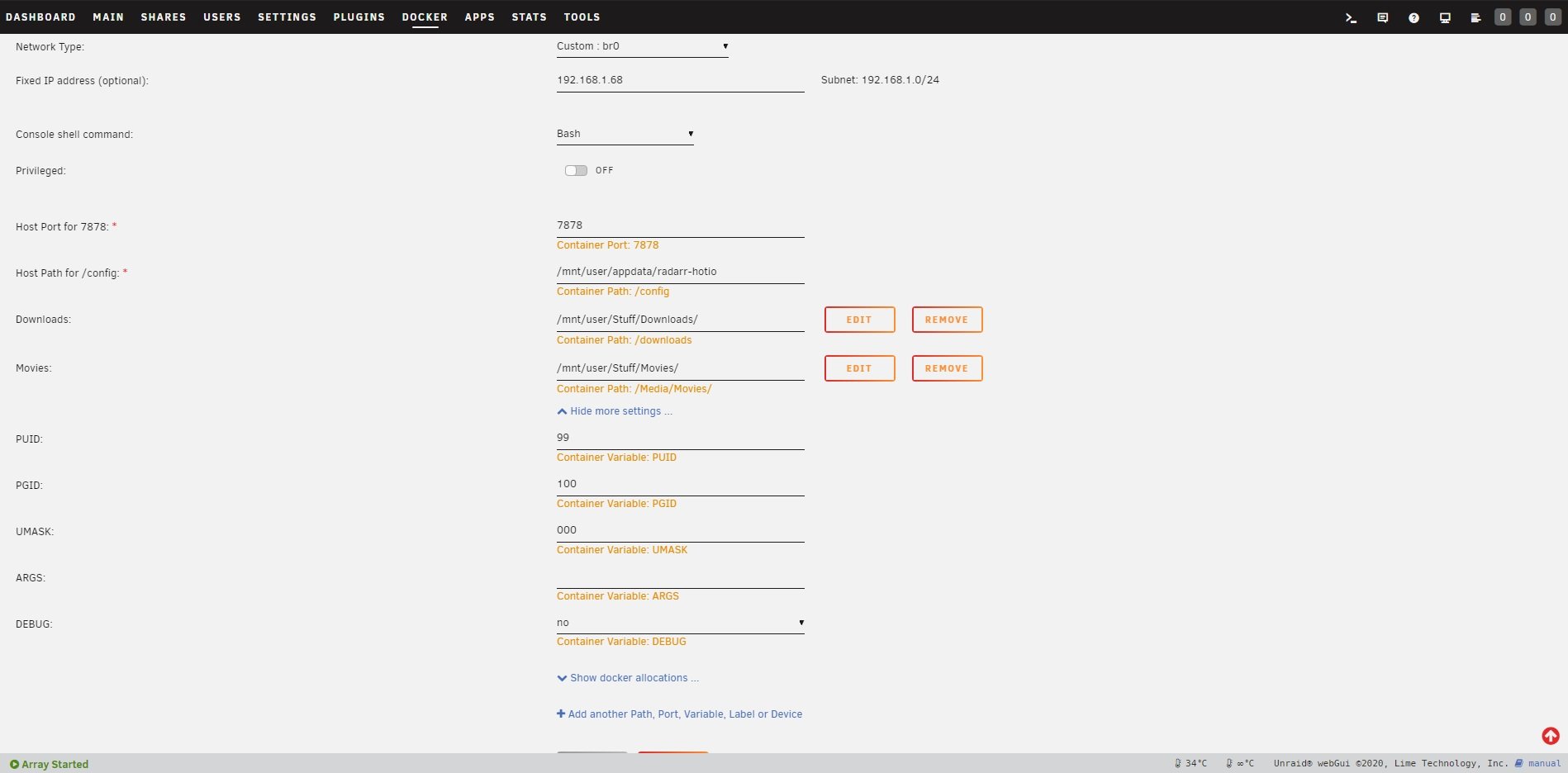

I tried and still same issue, Its not that.
To rule out the custom bridge I downloaded another Deluge container and set up in custom bridge and it worked. Sonarr and Raddar can connect.
So this issue is only on the binhex ones but I prefer binhex as he includes VPN built in.
this is not a issue with host this is container to container. I can access the UI fine. Bridge or custom bridge both. Its just contaner to container that does not work. All containers can connect to 8118 on this but not on 8112.
Edited by nekromantik
I'm sure the other deluge container worked with custom bridge but that doesn't mean this container should too. There are strict iptables rules in place in this container to prevent leakage, which may block the connection. Post your docker run command for delugevpn and radarr and a screenshot of the deluge settings in radarr. Have you confirmed you have a working vpn tunnel? What error do you get trying to connect to deluge?

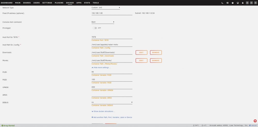

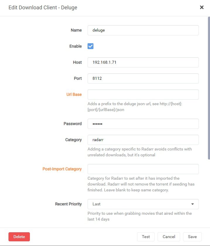

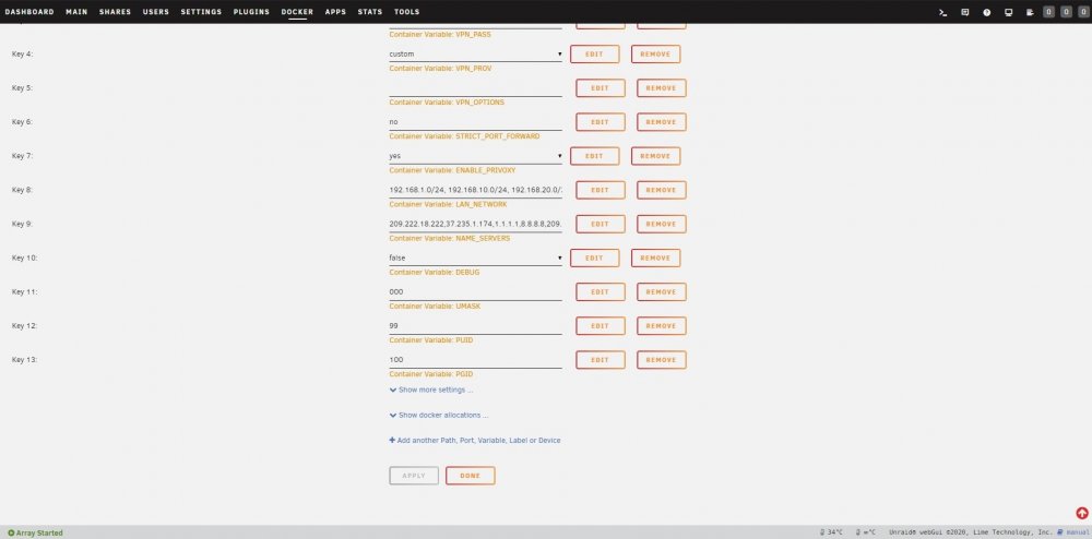

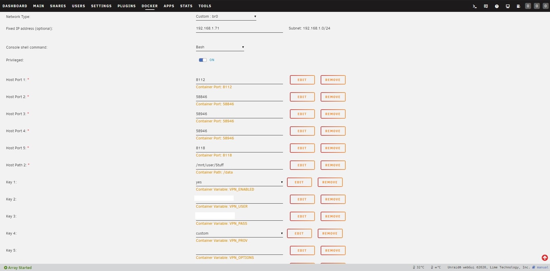

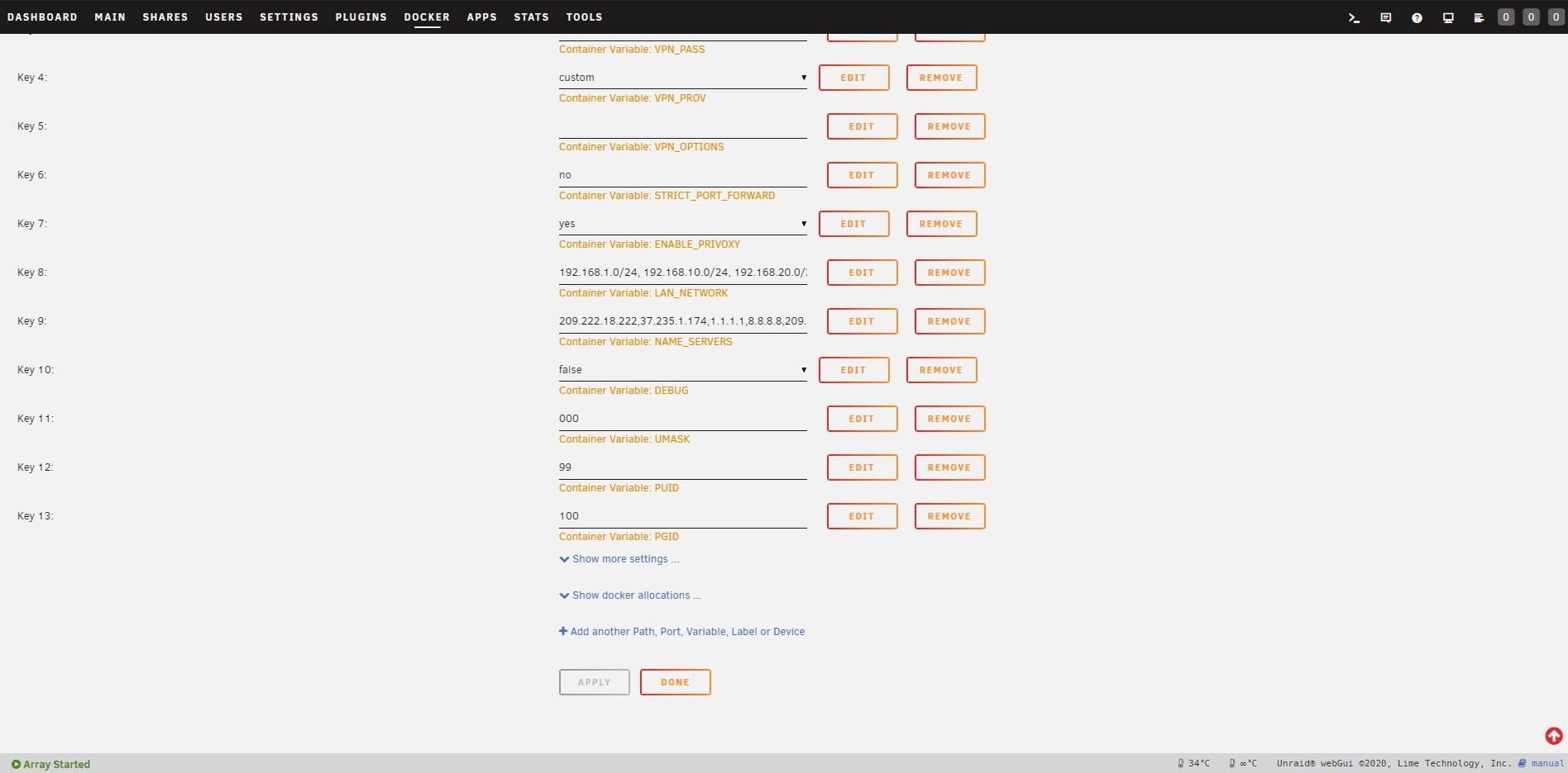

Not sure why iptables would block the webUI port as thats not the port thats used for downloading torrents.
Yes the VPN is running fine.
I did not use docker run as I just used unRaid templates. attached the images
Error is it just times out when connecting to Deluge
Well, you are still on a custom bridge network, which I told you isn't supported by this container. Change to normal bridge on all the containers which need to talk to each other. Then change the IP in radarr/sonarr. You also have issues with your volume mappings which doesn't match so you'll also need to correct that for the containers to work together. I'm referring to your downloads mapping.
Hey Nekromantik, this was exactly the issue I had when I switched the the binhex DelugeVPN docker to solve the PIA issue. You need to have it and Radarr/Sonarr all in bridge mode, not using their own IPs. Once I made that change everything was off to the races again.
ok i will see about normal bridge mode thanks both
