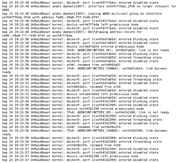

Hello,
I posted about my Deluge issues elsewhere, and did not get the answer I was looking for so I will try this thread.
I have binhex-delugevpn installed, and it works like a charm when the "VPN_ENABLED" option is disabled.
However! when I do enable VPN_ENABLED option on startup, the deluge docker never starts up. I get log errors reminiscent of the below (and attached).
What Is the reason that I am seeing IPv6 references in the log?
I have PIA ovpn files in the ovpn appdata folder as required. I think I have in there the "next gen" option.
Like I said earlier, when the VPN_ENABLED option is set to NO, everything works, the docker starts, and I'm able to get into the GUI.
There is no point to use deluge to download torrents unless I am connected to a VPN.
Any and all help is very appreciated.
Thank you!
-Eli
Deluge_Log_09242020.pdf
Edited by UnBeastRaid

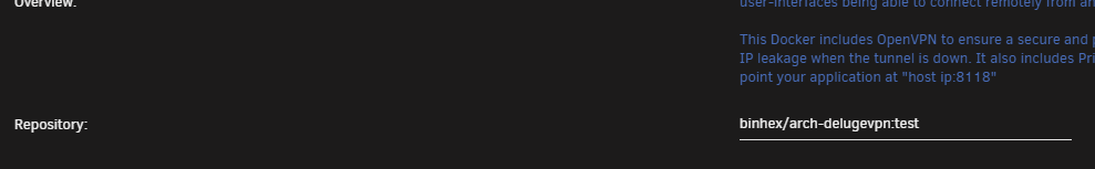

Remember and change the 'Repository' part to show':test:, too:
