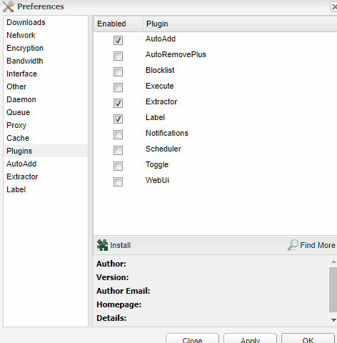

Just no luck with the autoremove plugin on 2.0. What tag should I use to get back to 1.3.x?
Just a note, after the latest forced update everything is working well again.
I use binhex/arch-delugevpn:1.3.15_18_ge050905b2-1-04
Edit- You can see all the tags on the github page.
Edited by wgstarks
This guinea pig like to report.
I had issues when I update this morning with the latest version, as it crashed and created a orphan, which I had to resolve.
downloaded the latest version of OVPN and now I have a connection with France.
I am also getting 100% speed from my ISP.
connected to all my Dockers with no issues
thanks @binhex for a great job
@Nimrad! Use this file. Put it in the config/plugings folder. If restart doesn't help, go to preference -> plugins -> install. Choose the file from the folder.
I too am using it. It should work...
KK
KK
I also had to delete “-py3.8” in the file name.
