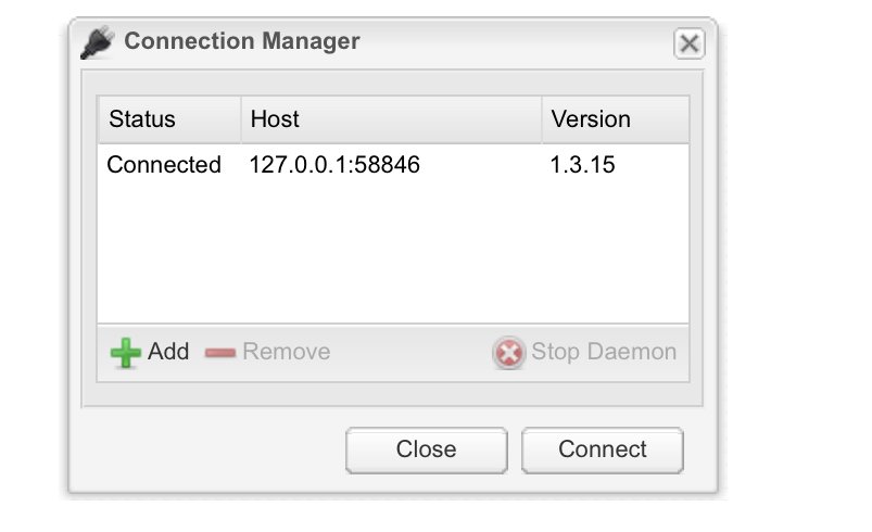

Is this supposed to be v 1.3.x and not 2.0.x? I heard on discord some guy using this had 2.0, so I’m not sure why I have 1.3.3DBDFB13-7949-4800-8F73-64DEF207077D.jpeg.760ab66e913f1990143149e188389dfb.jpeg
it will be 2.x, if you are running 1.x then you are on a old tagged version, check your tag in the repository and/or do a 'force update' to get the latest image.

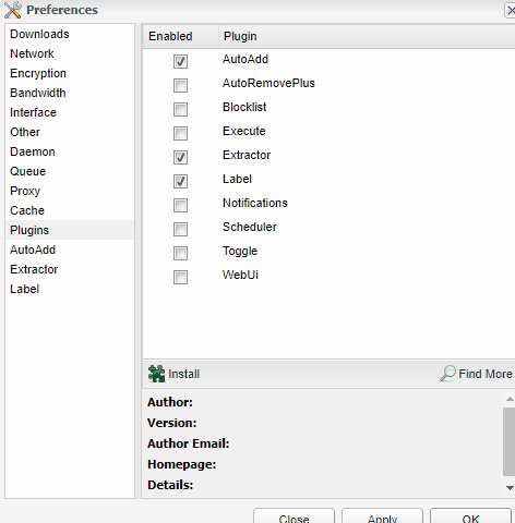

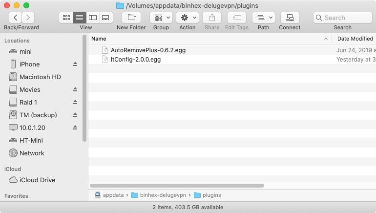

I updated to 2.0 recently, but the AutoRemovePlus plugin is suddenly gone. I’ve tried re-adding it both by uploading the .egg to the plugin folder in the docker appdata and by installing through the webUI. Is this a known issue? It should support 2.x according to the plugin page: https://dev.deluge-torrent.org/wiki/Plugins
I got it to work by removing the py version from the file name and then adding it directly to the plugins folder.
Thanks for the tip. It only kind of worked for me though. It now shows in my Plugins-list, but wont activate when I try to enable it. All other plugins will activate the UI menu item, but this doesn't. And if I apply/reopen the preferences it's unchecked again. Any idea?

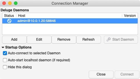

Had to re-install the docker from scratch today and currently re-adding all the torrents. Can't get thin client to re-connect though. Not sure what I'm missing? Remote connections are enabled on the server. Port 58846 is set in the container. Thin client is set to connect to <serverIP>:58846 with user admin.
