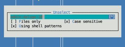

2 hours ago, strike said:
use midnight commander if you're unfamiliar with the command line. just type mc and hit enter, navigate to the auth file and press F4 to edit it
I must be doing something wrong. When I hit F4 I get the popup window in the screenshot. Enter the text which is shown and hit Return. Restarted the container but these credentials aren't being used.
Edited by wgstarks
Then the edit button must be something else on your keyboard. There should be a menu at the top and the bottom. The bottom menu correspond to the F keys, at least on my keyboard. Since it obviously isn't the same on yours I won't even try to guess what key you should press to edit the file.
But another thing you can do is to quit mc then when your back at the command line type nano auth, this will open up the auth file in the nano editor. It requires you to be in the config folder of delugevpn which you should be when you quit mc. If not you have to type nano "path to auth file"
To save in nano is ctrl+o and to exit is ctrl+x (on my keyboard at least)
I found the key to access the pull down menu and did it that way. Thx for the help.

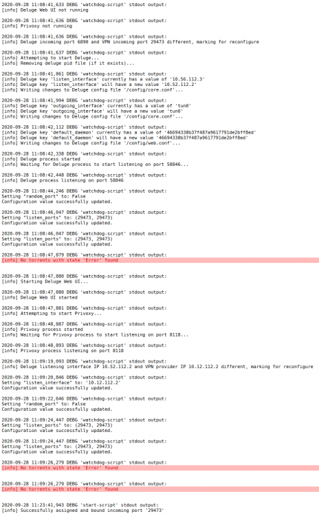

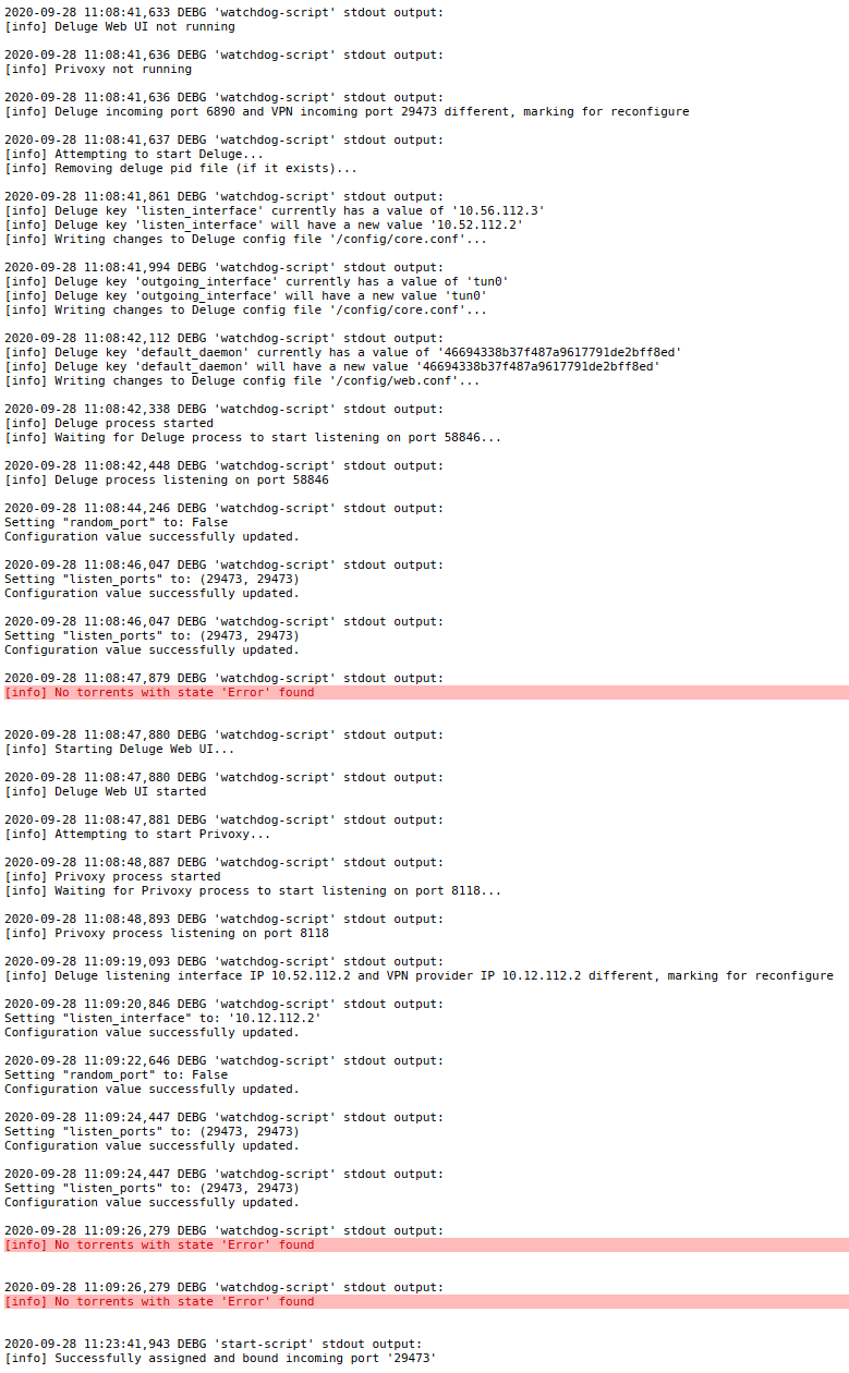

Not sure what is going on with my Binhex Delugevpn. Docker was working flawlessly in :test connected to Montreal with next gen config. I was getting up to 10MB/s down speeds.
Unfortunately, I had to restart my Unraid server, and upon bootup and re-supplying the VPN files to reconnect, Delugevpn would establish a VPN connection, I would login to the GUI and input URL for download, however, nothing would happnen. Torrent would stay at 0.0% indefinitely.
Any help is greatly appreciated.
Here is partial log screenshot of established connection:
Progress stays halted:
Client connection:
- Thanks
Edited by UnBeastRaid
missing infos
