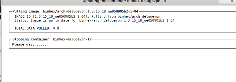

Binhex, I was a guinea pig running the :test version, have the changes for nextgen now made it into the standard code?  I don't recall seeing a call out saying it's good to change back...but I could be blind.
Apparently, I don't know how to force an update...can someone tell me the command for that?
Edited by Merijeek
Set “Advance view” in the top right corner of the docker page and you should see “force update” below the version info for the docker.
Thanks. Looks like I'd already updated (at one point I did a remove/add) so I guess I'm on the newest.

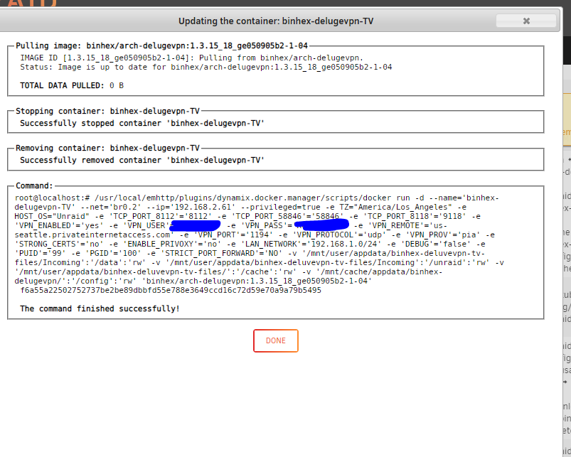

3 hours ago, binhex said:
you aren't, that is the still the old image, click on force update as instructed.
OK, well, in that case I did follow the force instructions. I'm showing: 1.3.15_18_ge050905b2-1-04.
I run the force update and I see:
...ending with:
...and then just the same loop:

@Merijeek - edit your docker container and change your tag to latest instead of the 1.x branch.  Your on a pre 2.0 client

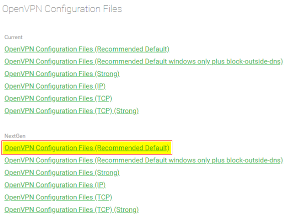

By looking at your log you are showing the List of PIA Endpoints associated with the OLD open vpn config
Here is the new link for the "NEXTGEN" config
https://www.privateinternetaccess.com/openvpn/openvpn-nextgen.zip
I literally realized this 12 hours ago after bashing my head for a few hours on why qbittorrent wasnt working
nextgen has a lot more end points
Edited by Cytomax
It looks to me as if you have set a tag for this docker in the repository field. Is it set to "latest". If it's set to 1.3.15_18_ge050905b2-1-04 then it won't install the latest update. You'll need to change the version to latest and install the current version on Deluge v2.

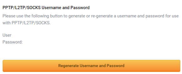

I downloaded the nextgen files via the instructions form Q19 in the VPN Docket FAQ.  I removed the old ovpn and cert files and replaced them with the nextgen files.  I also changed the STRICT_PORT_FORWARD variable to 'yes' since it was set to 'no' while using the legacy files.
When I try to start my docker I get the following error in the log:
2020-10-02 10:11:11,741 DEBG 'start-script' stdout output:
Fri Oct 2 10:11:11 2020 AUTH: Received control message: AUTH_FAILED
I saw Q16 in the VPN Docker FAQ which states my VPN_USER and/or VPN_PASS are not correct.  I regenerated my username and password from the PIA account site and updated them in the docker settings, but I am still receiving the error.  I even failed back to legacy ovpn files, setting STRICT_PORT_FORWARD to 'no', and everything works fine.  So I am thinking my user ID and password are good/valid since they work with the legacy files just fine.  A couple of questions to those with PIA and have it working with nextgen files:
1. Did you download the NextGen zip from the link labeled 'OpenVPN Configuration Files (Recommended Default)'?  The step in Q19 doesn't specify which set of files to use, but I was assuming the top link.
2. Are you using the 'PPTP/L2TP/SOCKS Username and Password' from PIA?  I wasn't sure if I should be using a different username and password for VPN_USER and VPN_PASS for the NextGen setup.  This is what works with my legacy ovpn files.
3. Are there any other settings you need to change outside of what is stated in Q19 from the VPN Docket FAQ?  I am assuming no or else it would be called out in those steps to switch over to NextGen.

2 minutes ago, Burizado said:
OK, I have been reading through all the new posts regarding the nextgen setups.  I updated my docker which was successful.  I can connect successfully using legacy ovpn files from PIA.
Deluge: 2.0.4.dev38
PIA ovpn files: legacy
Port Forward: no
Errors: none; connects fine and everything resumes
Well, hell, I didn't even know that was as thing. I have no idea how I had a specified version when I didn't even know that was something that could be done.
Thanks for the help, that did it and I'm up and running now.
