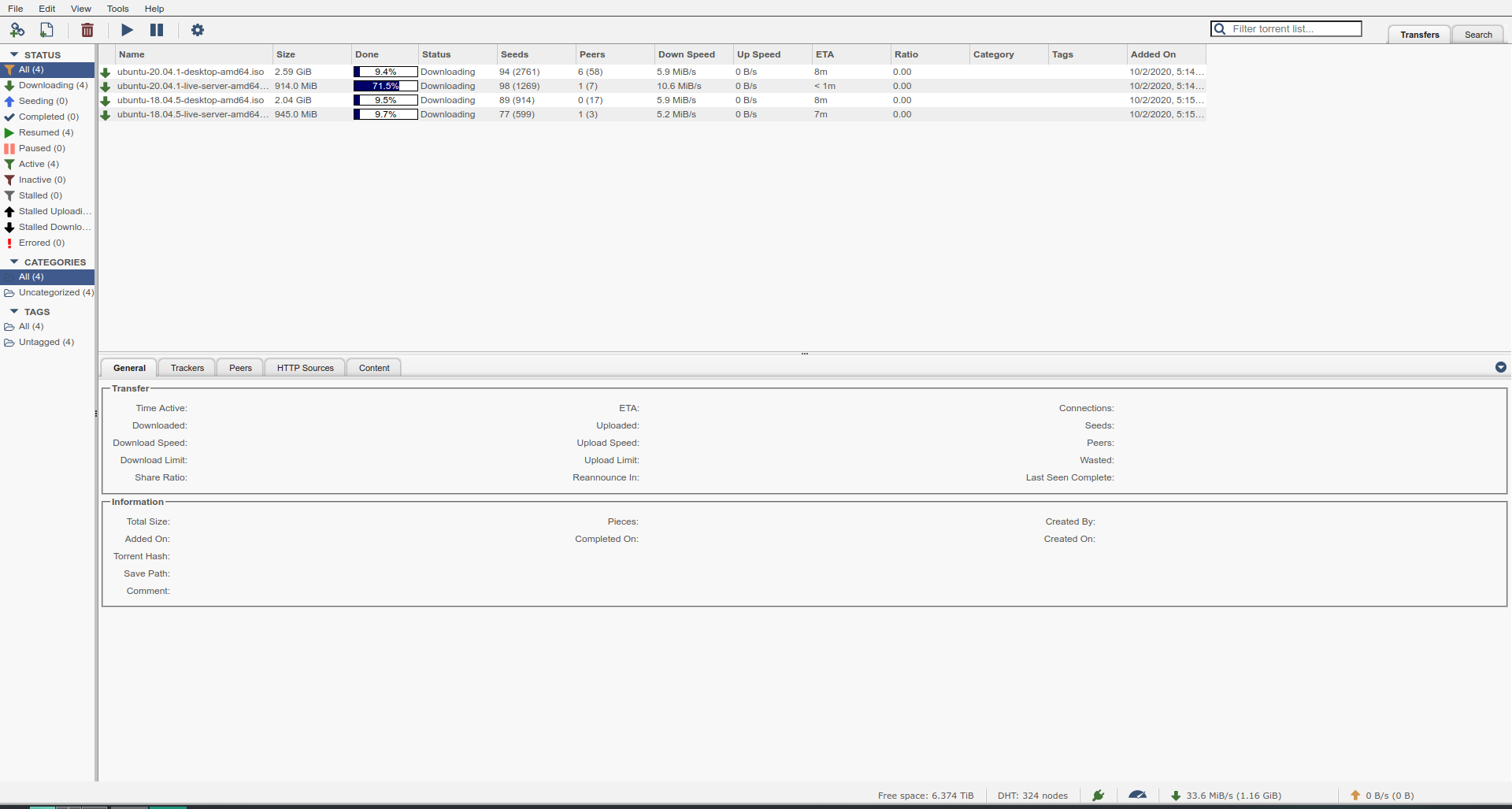

welp that settles it...
i only changed from qbittorrent because i was too dumb to realize i needed the nextget vpn files and not the old files
so i tried deluge and got like 8 megaBytes per second
went back to qbittorrent and downloaded 4 Ubuntu ISO's and got to 32 megaBytes without breaking a sweat
its absolutely possible different times of the day may of caused this bottle neck but w/e i like the interface of qbittorrent better anways
Thanks binhex for great work!
I can confirm I am seeing slower speeds with the nextgen servers. Apparently qbittorrent is pulling data down faster even with nextgen servers. Is there something we can change to increase our speed to what it should be for deluge?

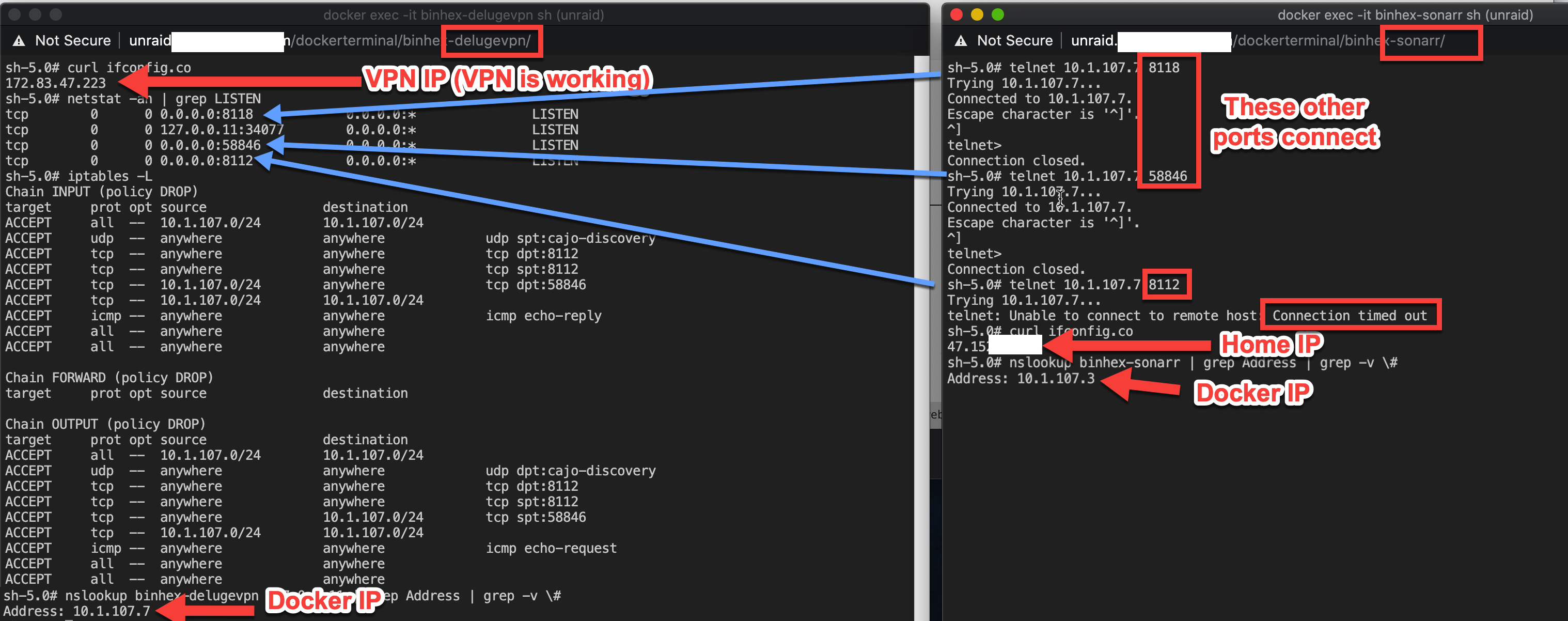

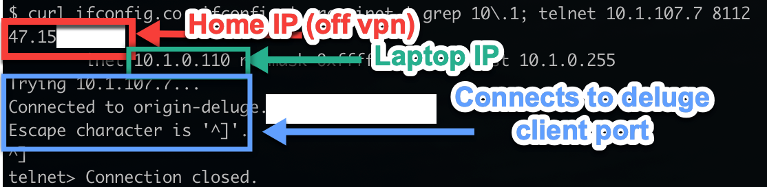

On 3/23/2020 at 4:05 AM, tehtide said:
I've got both networks in there. I'm able to ping the deluge docker VPN from both networks, but radarr/sonarr won't connect to the json feed if they are on the same network.
Unknown exception: The operation has timed out.: 'http://10.10.50.22:8112/json'
@tehtid, did you ever fix this or anyone else know how to get it working? I'm having the exact same issue.
Something stranger is that the VPN port (8118) works but the Deluge port (8112) doesn't work. I'm testing by telnet'ing to the port from the Sonarr docker. Telnet was installed by issuing `pacman -S inetutils` after connecting to the Docker's console.
I tested the other port (58846) and that one connects. For some reason 8112 won't connect.
Connects fine from other networks (eg: my laptop)

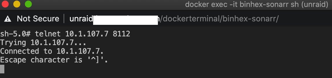

If I set vpn to off in delugevpn, the Sonarr docker can now reach 8112/tcp on delvugevpn. My laptop can still connect to delugevpn on 8112/tcp.
Edited by MrLinux
Clarified which docker I was trying to telnet from to test the port
