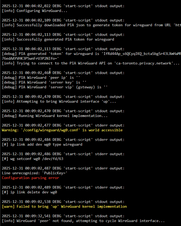

I have the same issue as the one presented here: [help needed] binhex-qbittorrentvpn + PIA : r/unRAID
It started some time in the past few months. Everything was working great with wireguard before that, and openvpn before that.
I have tried the following which produced the same result
- Deleting the /config/wireguard/wg0.conf file
- Switching to USERSPACE_WIREGUARD = yes
- Disabling the Tailscale container integration
- Switching to openvpn then back to wireguard
- Switching to a different PIA endpoint
Nothing that I have found in this thread, nor in the VPN nor VPN Docker FAQ pages have helped. No matter what the configuration, it seems that the Address and PublicKey fields are never populated in the produced Wireguard config file.
I've attached the supervisord file and the unraid command execution with PID censored. Any help is greatly appreciated, thank you!
command_execution.txt supervisord.txt
Edited by elys_k
duplicate image
This indeed seems to be the issue. I don't use PIA or wg, but is the PIA wg generated token for an endpoint always the same? If so, you can just edit the wg0.conf file yourself and add the token to the public key. You should, in any case, delete the wg0.conf file again since you posted your private key in the screenshot.
