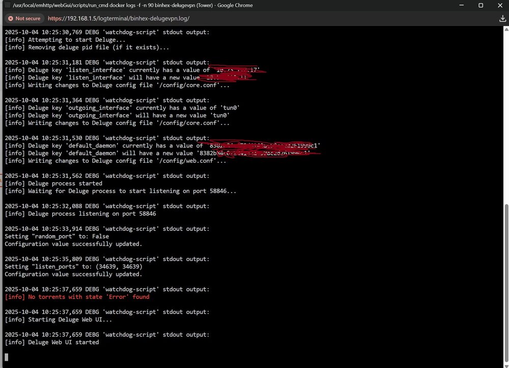

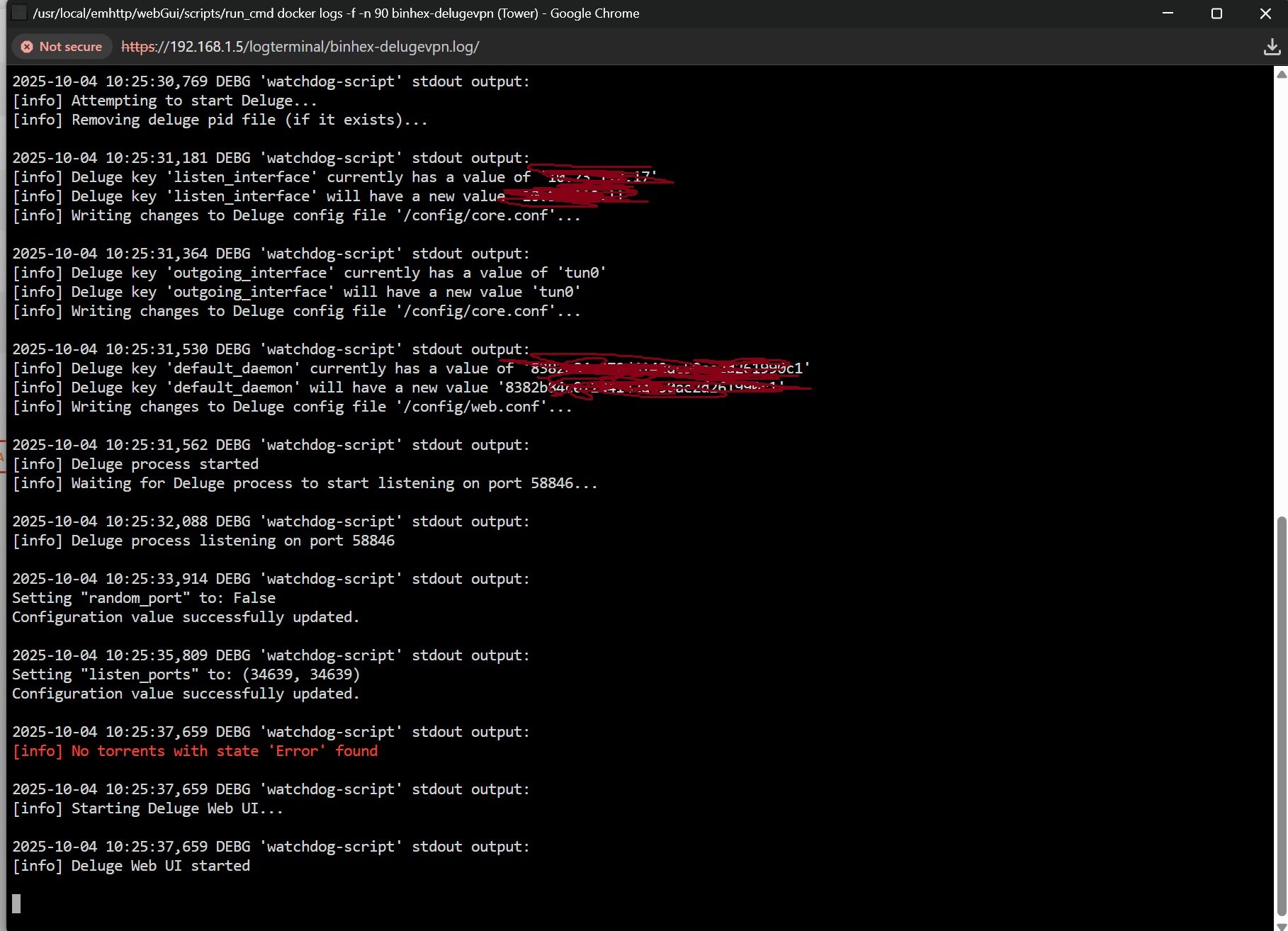

I have been using this container for awhile but suddnely somtime this week I have been unable to connect to the container like normal.
I get this error
I am not sure how to fix it? i tried reinstalling the container but still same errors and unable to connect
When i updated the contain to :test - I now get this far - but when i go to the webgui to the deluge i get the error "error connection timed out"
Edited by Appok

About 1 1/2 months ago my web UI stopped working on my Deluge as well as back end connections from my downloaders. I'm just now getting around to looking into it. VPN appears to connect fine, can ping the docker IP from my Unraid console, but no other connections are allowed. It's as if the firewall rules on the container aren't fully taking.
My internal IP subnet is 192.168.12.0/24 and I've tried multiple hosts. My main host being 192.168.12.7. Is there anyone that sees anything wrong? I've attached my execution and supervisor logs. Thank you!
supervisor.txt executionCommand.txt
If you set STRICT_PORT_FORWARD to no can you reach the webui then? It looks like you have an old template, so you need to add the variable yourself to the template. Add a new variable, set the key to: STRICT_PORT_FORWARD and value to no
That was it! Thank you so much. Yeah I've had this running since maybe 2016? It just always has worked so I rarely have to tinker with it lol.
Great, then we know what the issue is, and it's related to port forwarding. For port forwarding to work, STRICT_PORT_FORWARD should be set yes. But since your webui won't load when set to yes, it means either the endpoint is not supporting port forwarding anymore, or more likely, it could be because you're running an old version of delugevpn, which maybe has an old link for fetching the port forwarding supported endpoints. I noticed in your log a warning that the url was down. It may be down, but I don't think it has been down for 1 1/2 months..
And without port forwarding, your speed will suffer, so you should definitely fix it. Start by updating the container to the latest version. Set STRICT_PORT_FORWARD to yes again and see if you have the same issue. If it works, then it's fixed. If it won't load again, you could try to download a new ovpn file and pem file. The Netherlands is a good choice.
