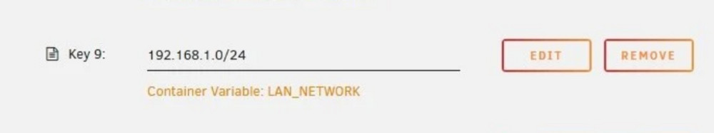

Hi @binhex,
I have recently had my VPN go wibble; I was using an openvpn config file that worked fine for ages but just started getting errors about AES-256-CBC cipher. I've had this before and managed to fix it with a new config file, but thought it would be a good time to switch to Wireguard.
So I created the new wireguard config file, changed the config in unraid, uploaded my config file, and rebooted the Deluge docker follwinf the instructions at Q21 here. The logs see to show the wireguard connects fine and it loads the GUI according to the logs (attached below).
However, I can't access the GUI from my within my network - it just times out. I suspect I need to change a variable in the unraid docler config, but I'm not sure which. Screengrab of me setup attached too.
Any help much appreciated!

On 4/7/2025 at 10:28 PM, PitRejection2359 said:
Hi @binhex,

what is the ip address of the machine running the web browser?
192.168.0.3
