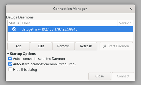

Hey guys,
I wanted to create torrents so i tried setting up a thin client. I created a new entry in appdata/delugevpn/auth, which looks like delugethin:[pw]:10 and added a host in my thin client (my local ip as hostname, default port and the username and password i set in auth), but can't connect to the daemon running on my server. Remote connections are allowed.
What am i doing wrong?

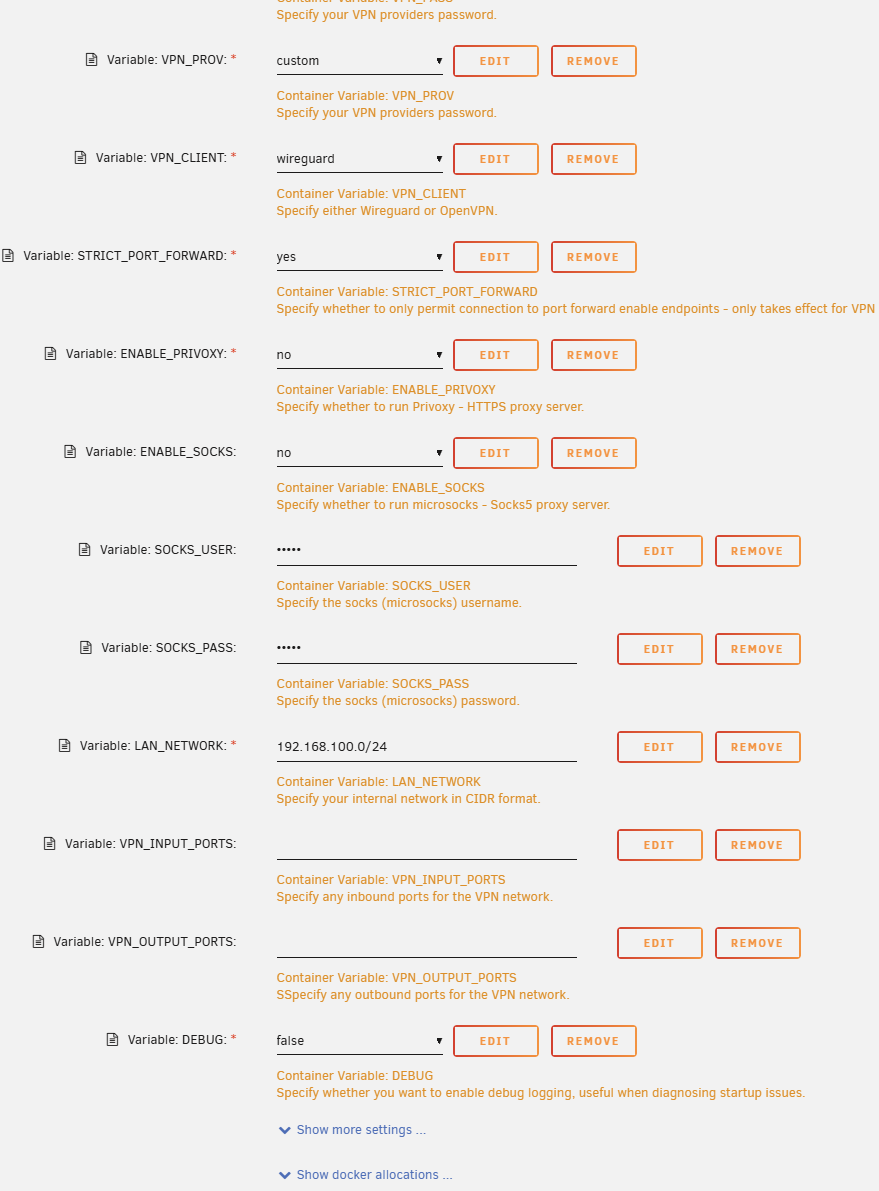

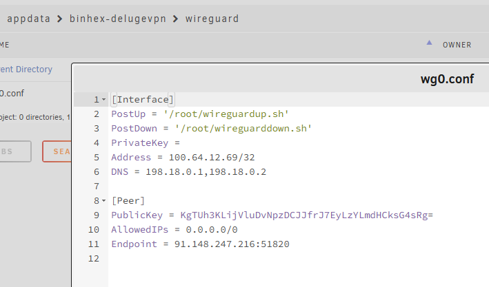

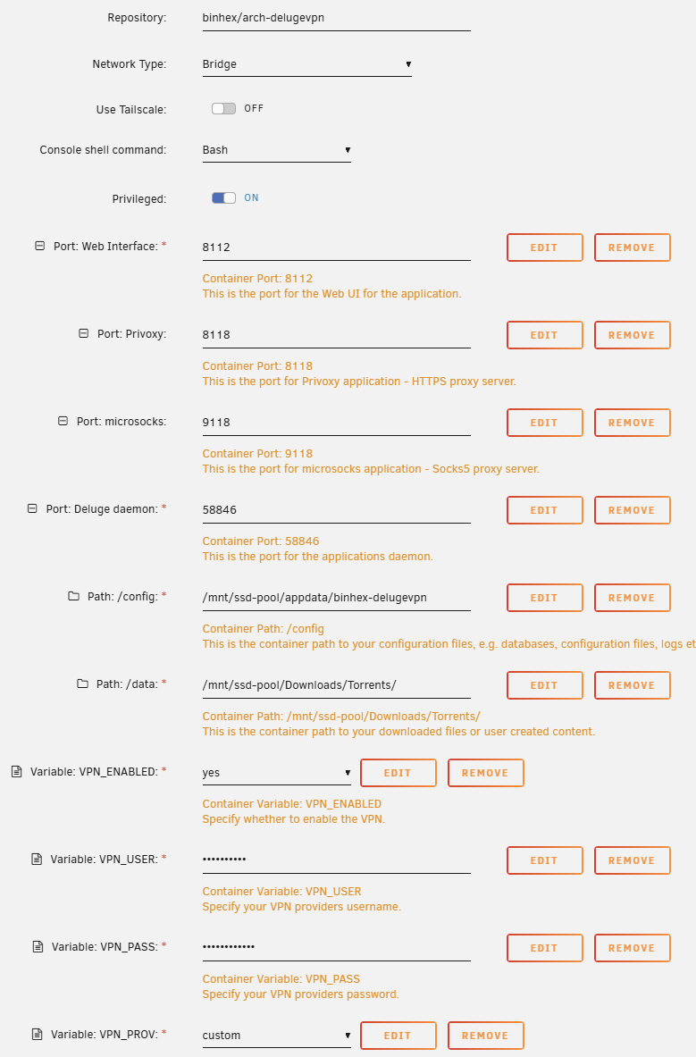

My DelugeVPN docker does not start anymore, since a while, while is was working before.
2025-03-21 12:52:06,064 DEBG 'start-script' stdout output:
[warn] WireGuard interface failed to come 'up', exit code is '1'
2025-03-21 12:53:36,380 DEBG 'start-script' stderr output:
Warning: `/config/wireguard/wg0.conf' is world accessible
The wg0.conf file is renewed with the latest VPN info from my provider. Docker is running in privileged mode.
Can you guide me into the right direction?
