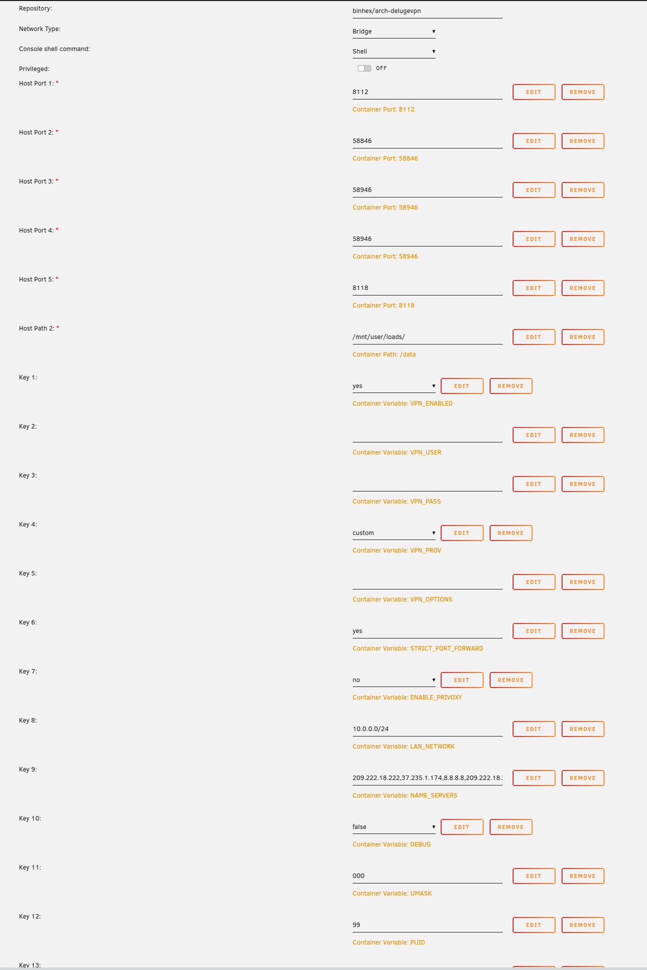

Hello, I'm unable to get  deluge started. I select it to start and then it still doesnt run.
log post somethen about needing root access. how can i fix?
2024-12-29 09:57:03.630478 [info] Host is running unRAID
2024-12-29 09:57:03.665275 [info] System information: Linux f0e1f52cdfa8 6.1.106-Unraid #1 SMP PREEMPT_DYNAMIC Wed Aug 21 23:36:07 PDT 2024 x86_64 GNU/Linux
2024-12-29 09:57:03.704186 [info] Image tags: BASE_RELEASE_TAG=2024122301,INT_RELEASE_TAG=2024122301,IMAGE_RELEASE_TAG=2.1.1-8-03
2024-12-29 09:57:03.748600 [info] PUID defined as '99'
2024-12-29 09:57:03.851624 [info] PGID defined as '100'
2024-12-29 09:57:03.979097 [info] UMASK defined as '000'
2024-12-29 09:57:04.019746 [info] Permissions already set for '/config'
2024-12-29 09:57:04.072243 [info] Deleting files in /tmp (non recursive)...
2024-12-29 09:57:04.132440 [info] VPN_ENABLED defined as 'yes'
2024-12-29 09:57:04.177262 [warn] VPN_CLIENT not defined (via -e VPN_CLIENT), defaulting to 'openvpn'
2024-12-29 09:57:04.223295 [info] VPN_PROV defined as 'custom'
2024-12-29 09:57:04.283710 [info] OpenVPN config file (ovpn extension) is located at /config/openvpn/ca1465.nordvpn.com.udp.ovpn
2024-12-29 09:57:04.399649 [info] VPN remote server(s) defined as '37.19.213.142,'
2024-12-29 09:57:04.438394 [info] VPN remote port(s) defined as '1194,'
2024-12-29 09:57:04.478018 [info] VPN remote protcol(s) defined as 'udp,'
2024-12-29 09:57:04.521848 [info] VPN_DEVICE_TYPE defined as 'tun0'
2024-12-29 09:57:04.566743 [info] VPN_OPTIONS not defined (via -e VPN_OPTIONS)
2024-12-29 09:57:04.608373 [info] NAME_SERVERS defined as '209.222.18.222,37.235.1.174,8.8.8.8,209.222.18.218,37.235.1.177,8.8.4.4'
iptables v1.8.10 (legacy): can't initialize iptables table `filter': Permission denied (you must be root)
Perhaps iptables or your kernel needs to be upgraded.
2024-12-29 09:57:04.656396 [crit] iptables default policies not available, exiting script...
post screenshots of your container config - unraid webui/docker/left click container and select edit then screenshot all settings and post here, ensure you  remove the username and password for your vpn provider.
ok, last line key 13 is 100
not sure why it wont start.
Thank for the help in advance.
you have set privileged mode toggle to off, the default is on.

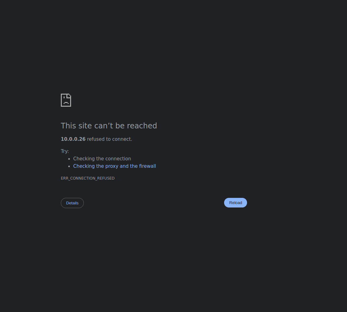

I didnt make any changes but I have urned it on and it runs but I cant connect to it.

So for some unknown reason my downloads have started crawling or just stalling. There are lots of peers so I don't think that's it. Also I tried downloading something again from a week or so ago and it's crawling. Any ideas? Let me know if I can add logs or something.
For the life of me, i can't get wireguard to work with PIA either with Deluge or Qbitorrent. Everything should be correct and it works perfect with openvpn but the speeds are slow. It works with VPN off also.
The problem is the UI goes to 'This Site Can't Be Reached', even though in the logs it looks like the UI should be started.
Any chance someone could point me in the right direction with this? I've configured the wg0 to the closet region but still no luck.
