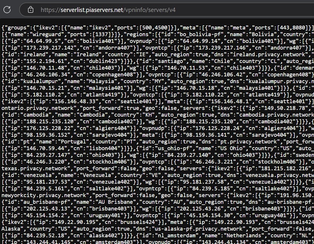

Should I just turn off STRICT_PORT_FORWARD?  I recall you had me turn it on in the distant pass or maybe it's in your Q&A?
I get a page that looks like this.
PIA was running and the deluge was up before I upgraded the container.  So I was connected to PIA before the upgrade.  I tried to get a connection for about an hour and a half.  Any ideas?
Thank you binhex.

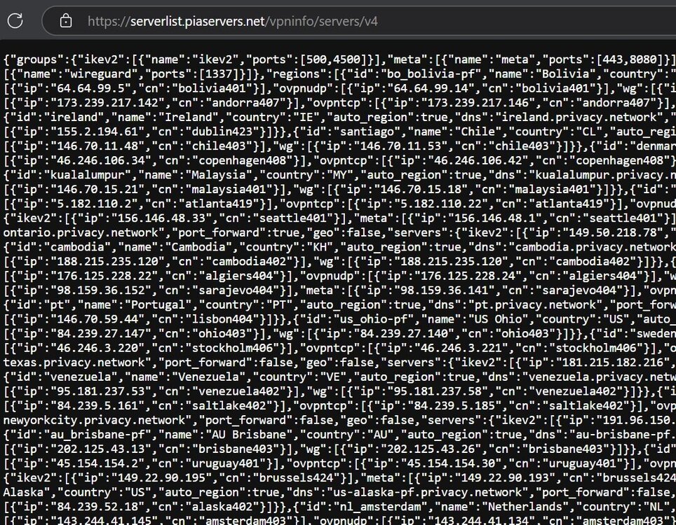

Similarly I'm able to hit that endpoint via my own PC & browser no problem. I was even able to use terminal on my Unraid server to curl against that PIA endpoint. However, trying to curl within the delugevpn container is giving me a curl: (35) TLS connect error: error:00000000:lib(0)::reason(0).
I am running Tailscale and tried disabling the MagicDNS with no success either. Again, though, I've had that on my Unraid for a long time with no changes and Deluge was working fine until recently.
Any ideas? Thank you so much for your help!

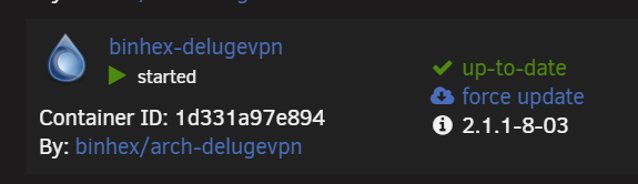

I am still having the issue and have had to fall back to continue running version 2.1.1-8-03.  I hope binhex figures this out because at some point trackers will no longer allow an older version of deluge.
Thanks for any help binhex!

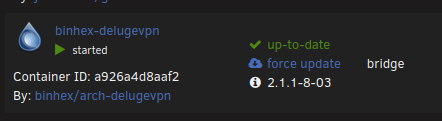

I also had this problem (using PIA), reverted back to v2.1.1-8-03 and I was able to access the UI.
I created a new container with latest version and different ports, and that works!
Deleted my old container and I'm using the new one with the old port numbers.
