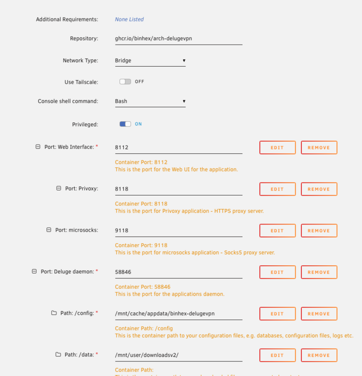

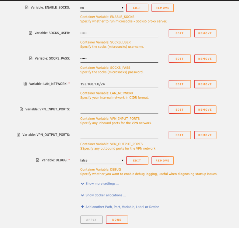

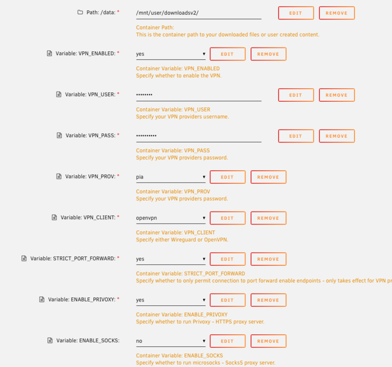

Woke up this morning to Deluge ui not showing, I see no errors in the logs, I use PIA, and the logs show an address being assigned, and deluge looks like it's doing what it's supposed to be doing (as per logs) but no UI.
The "watchdog" keeps running, and all it's checks appear good to go. (i.e. the VPN is up, listening to ports, etc.)

Please do this: https://github.com/binhex/documentation/blob/master/docker/faq/help.md
1 hour ago, strike said:
Thanks Strike, See attached.
It seems to be stuck here (in the logs) no other logs are being written.
I did re-install the app, but I did NOT delete the appsettings directory, maybe a bad file there?
Also at this point it's using 3.5% processor, (nothing else is as typical home server nothing to do)
Let me know. Thanks!

It looks like it doesn't even try to start the web-ui. First, try to back up your appdata somewhere and start with a fresh config, just copy in your wigeguard files.
If that doesn't work, according to your docker run command, the container is set to use the "sinclairnet" network. It's not really supported to use custom networks in this container. Sometimes it works, and other times it doesn't. If you want to use a custom network, you should switch to using the thin client of deluge instead of the webui. Or if you want to continue to use the webui, switch to the bridge network.
But as mentioned, it doesn't look like it's even trying to start the webui, so it could be some corrupt files, so try starting fresh first. If it works, copy back you files for your torrents from the backup.

Yep, reinstalling it from scratch fixed it.
Thanks for the assist strike
