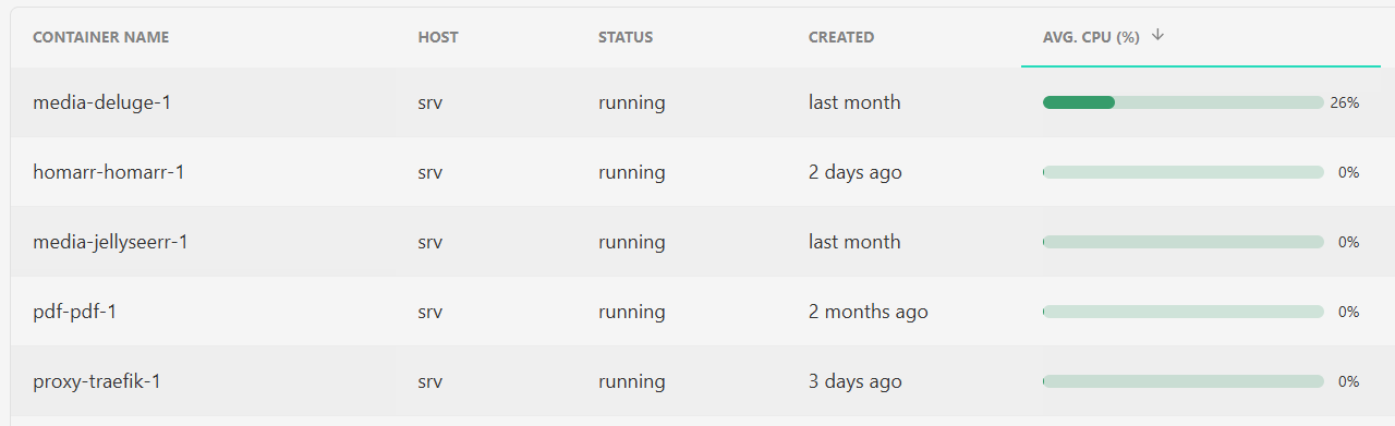

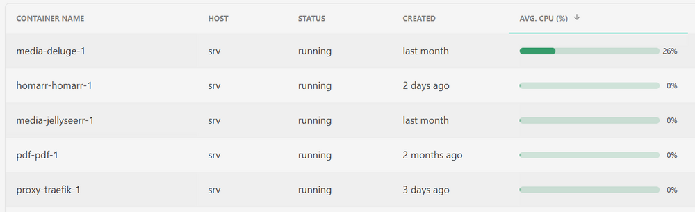

(I am here because I have a question regarding DelugeVPN, but unrelated to Unraid, hope this is still the right place)
I use DelugeVPN for years on a Debian server (so not Unraid). It works great.
I noticed that it uses quite a lot of CPU, nothing spectacular but still 3-5 times the usage of other containers.
This is not a problem but I am curious if this is expected. I can imagine that the CPU usage comes from the en/decryption of the traffic but I checked right now and it is south of 0.5 Mbps.
Again - everything works fine, it is more a curiosity from my side (and who knows, maybe something to tweak to bring the number down?)

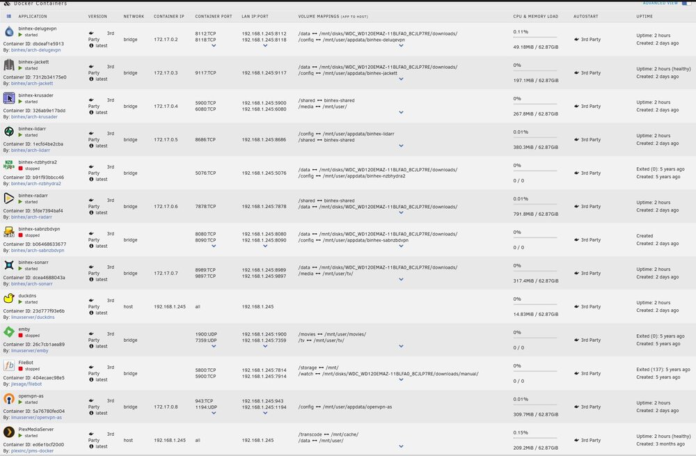

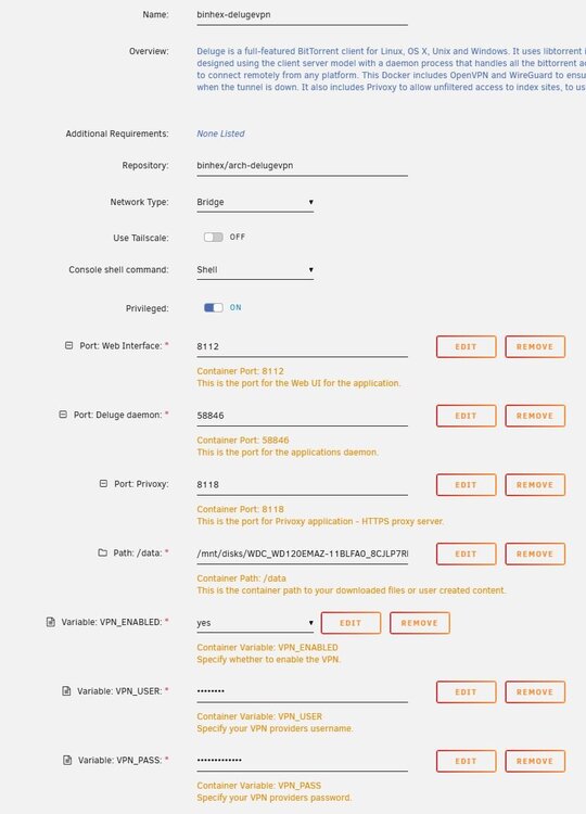

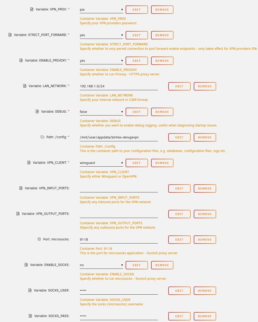

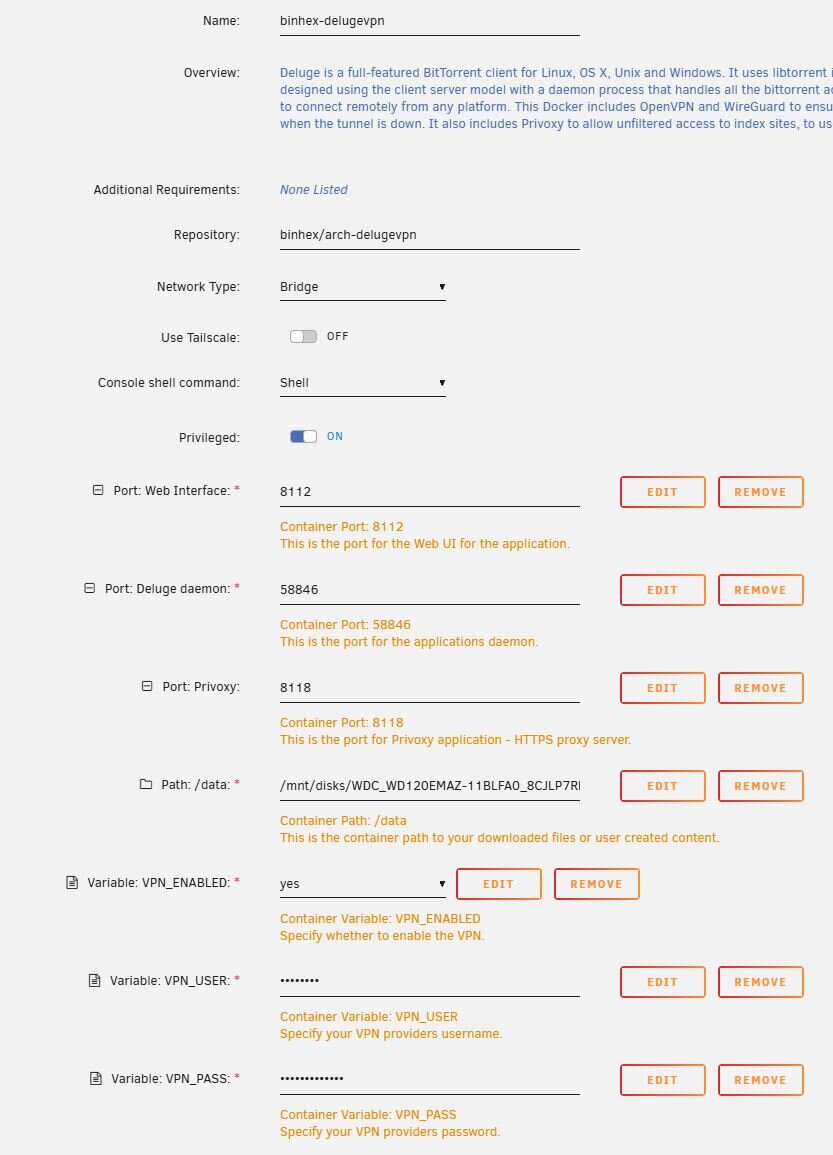

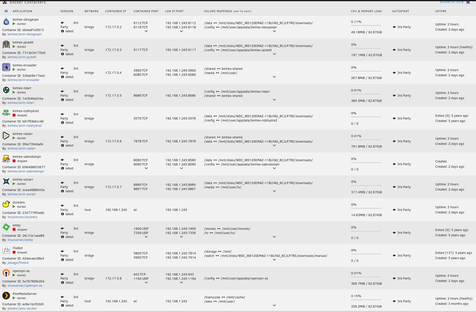

Hello guys,
I have had Unraid version 6.8.0 hosted on Supermicro X9DR3-F Version 0123456789 running very stable without any issues since 2019.
Couple of days back, I've noticed I couldn't pull up binhex-delugevpn docker container in UI.
So, I thought of upgrading to latest stable version. So, as part of upgrade process, I've upgraded all the plugins and docker container whatever they could upgrade. Since not all of them were backwards compatible with 6.8.0 version.
The default version presented by Unraid to upgrade to was 7.0.1 -which I did.
I have searched few forums and decided to backup and reinstall the docker image and reinstall all the containers.
Looks like OpenVPN is deprecated and I have installed WireGuard-Docker in it's place.
I've re-installed deluge first and later sabnzbdvpn containers.,
After the upgrade, I've noticed the following issues:
1) binhex-delugevpn UI comes up, but its not downloading any torrents. For some torrents, the download speed is at 1kb/sec....but literally there is no progress.
I've tried reinstalling again with OpenVPN with copying latest credentials, but still it isn't downloading any torrents.
I suspect it might be incorrect configuration with ports or keys of wireguard vpn / Open vpn.
2) binhex-sabnzbdvpn is the only container that did not start. It's logs also doesn't show anything. Currently it's stopped.
sabnzbdvpn failed and the log states
"Bind for 0.0.0.0:9118 failed: port is already allocated."
When I checked deluge configuration, it's using this for microsocks.
Container Port: 9118
This is the port for microsocks application - Socks5 proxy server.
How do I resolve this conflict / sharing of 9118 port between deluge and sabnzbdvpn.
I've attached the log and the docker allocation of ports
deluge_log_071425.txt
Edited by KevinImf
simple, you change the port on the host side to be a non conflicting port number, for example 9119 (assuming 9119 is not in use by another container).
i would suspect /mnt/disks/WDC... is not healthy or not mounted, check that you can write to it.
When I upgraded unraid, looks like the change the share/mount name of my Unassigned drives.
Reversering the mount /share name back to the previous one, fixed the deluge issue.
Also, assigned a different port to sabnbzd and it's also working fine now.
I really appreciate your suggestion. I would have never thought it would have been drive mounting issue. I was focused on ports and vpn configurations.
Thank you!!
