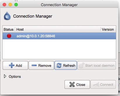

I'm having some difficulty with couchpotato/remote gtk as well. I'm not actually interested in CP but all the documentation references it so I thought if I could get that working the GTK stuff would fall in line.
Daemon port is set to 58846 and 'allow remote connections' is checked. These settings are reflected in core.conf
I've set a credential in the auth file as 'deluge:badpassword:10' to keep things simple.

3 hours ago, jonathanm said:
Did you add your desired login to the auth file, set the LAN_NETWORK, and enable remote management like it says in @binhex's FAQ? The GTK client connects in exactly the same way as CP in this example.
That doesn't seem to work. I haven't changed the default credentials so I just used them.
deluged.log.txt
Edit- Last two lines in the log show this.
[INFO    ] 14:03:52 rpcserver:206 Deluge Client connection made from: 172.17.0.1:47084
[INFO    ] 14:03:53 rpcserver:226 Deluge client disconnected: [('SSL routines', 'ssl3_get_record', 'wrong version number')]
Edit2- I have Deluge version 1.3.15.1 installed on the desktop. Can't find a version number for the docker though.
Edited by wgstarks

Got it fixed. Looks like default user/password doesn't actually exist in the auth file. Had to add them.
That was mentioned in the FAQ jonathanm posted, but i will make it more clear :-), glad you got it working.
