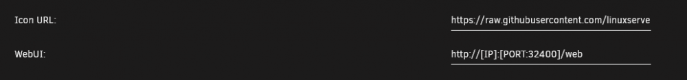

when I start the plex docker the option for the Web GUI isn't shown.
Do you have a WebUI entry in the Plex docker container settings? Enable Advanced View
If it is not there, no WebUI option will show up when yo click on the Plex icon.

2 Reasons I see for that
1  When playing around getting Plex back working, you inadvertently edited Plex and changed the WebUI entry on it
2  The flash drive has dropped offline.  (Probably no "Edit" option in the drop down either - or if hitting it will bring up a message akin to "Was this container created with ..."

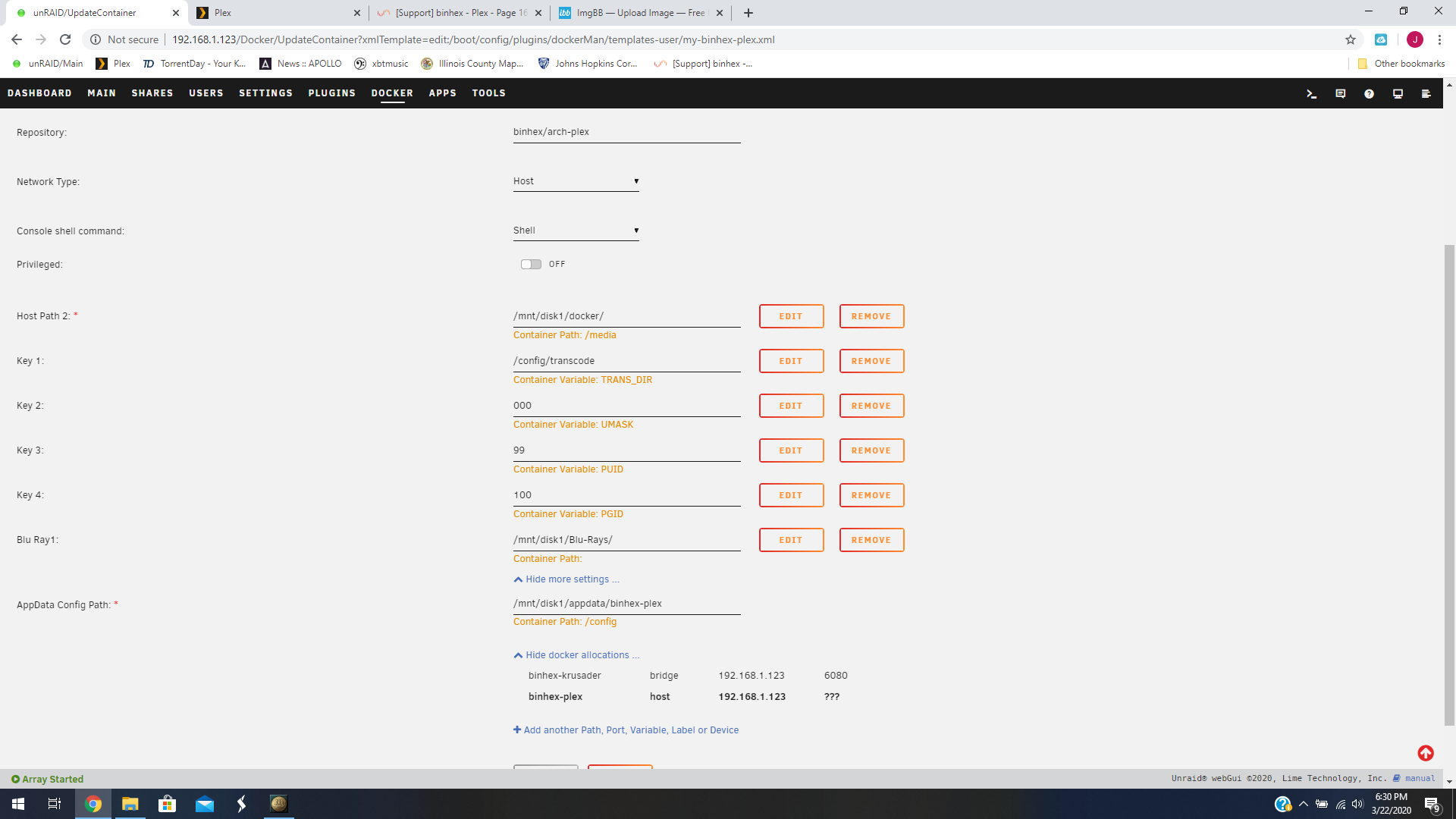

Thanks for the response.  Issue I have is I had already deleted the original and tried installing the "official Plex" version, Couldn't get it to work.  So I deleted it and downloaded the "binhex" version.  I have no idea what any of my paths were, And I deleted some of those folders thinking it was causing issue with the new version download.  So, This video doesn't help me much.  Can I just install "binhex" and set it back up?  I tried setting the file paths in plex to the locations of all my media.  However, When I go into the Plex GUI, I have no idea how to find the drives.  I have clicked on everything but they are not present.
Also, To better understand what happened.  I'm not much of a tech person so I don't touch this stuff much because I have no clue what I'm doing.  Needless to say, My unraid system OS had not been updated in most likely 2 years or so.  I updated the OS and that's when everything when bat shit crazy and plex stopped working.  I tried updating it, Did not work.  That's when I began to install other plex applications, Needless to say I have not been able to get them to work.  I'm not even sure during the initial install what I'm supposed to check or set.  I did figure out adding "paths" to my media drives in the plex docker setup.  I have 10 media drives with various folders and plex has a path to them all.  Again, However when I go into the web GUI and try to setup a "movies' folder or whatever it asks for me to pick my drive/folder.  When I go into this option, I cannot find my pathed drives.  Again, I'm not much of a techie, Don't know shit about networking so maybe I'm missing something.

Here is my current settings, Have no clue if this is correct or what some of this stuff even is.  You can see at the bottom I added a path to the a Blu Ray movie folder, Which I can't seem to find in Plex GUI when driving to add a drive/folder.
Edited by bloodlust

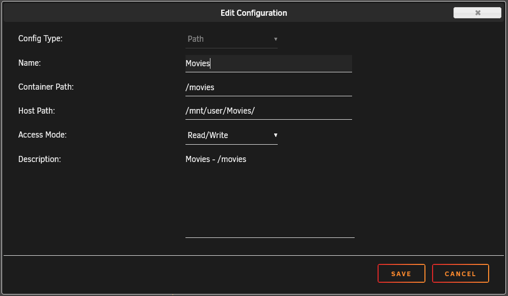

And you never will find it in Plex as currently configured.  You have not specified a container path.  The container path is what is used in Plex to tell it how to access the media.  For example, you might call the container path something like /BRMovies.  When you browse for a folder to add to Library in Plex you would look for /BRMovies.  That would map to /mnt/disk1/Blue-Rays and Plex would know where to find the media.
Here's my /movies mapping in the Plex container as an example:
Is there a reason you are using disk shares instead of user shares?  Perhaps you want to organize your media on specific disk(s).  That can also be done with user shares.
There is a likelihood of losing data if you ever copy files between disk and user shares.  It should always be user share to user share and disk share to disk share.  You may know exactly what you are doing, but, I thought I would point it out.

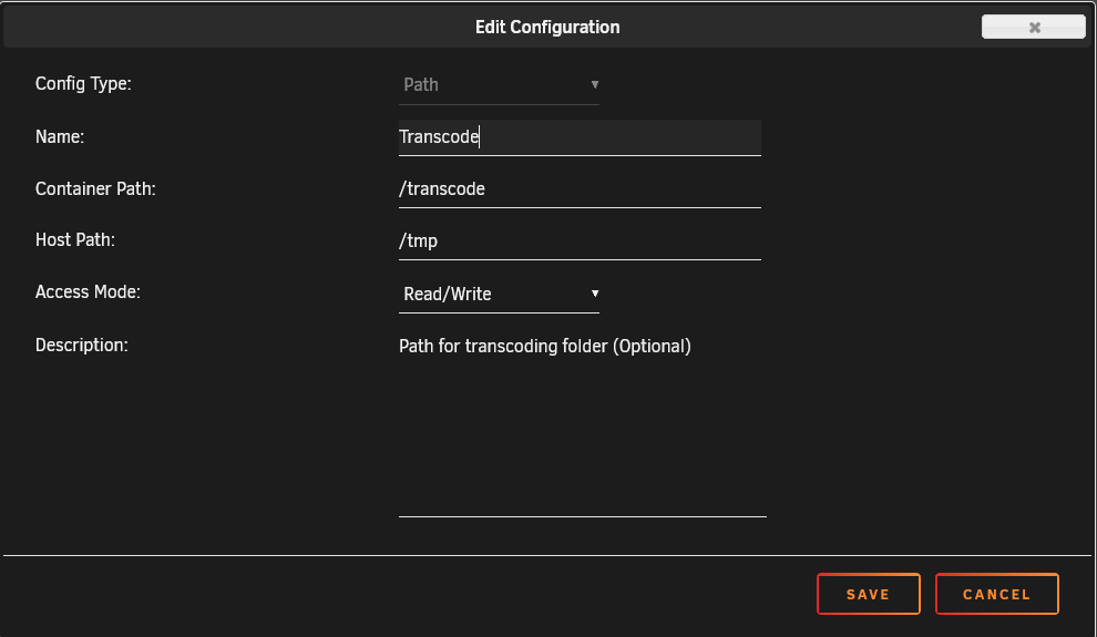

I noticed my transcoding to ram stopped working.   I checked the docker log and I see this.
2020-03-22 21:10:26.031500 [info] Permissions already set for volume mappings
2020-03-22 21:10:26.052399 [warn] TRANS_DIR not defined,(via -e TRANS_DIR), defaulting to '/config/tmp'
However, I DO have the TRANS_DIR set via the volume mapping.
container path: /transcode
host path: /tmp/transcode
Am I doing something wrong?

No that this is the problem but you do not really need to specify a transcode folder under /tmp.  Plex will automatically create /Transcode/Sessions folders under the designated host path.  Your setting would result in a path of /tmp/transcode/Transcode/Sessions.  Sessions is where the transcoding files will actually appear when transcoding is taking place.
The warning you saw indicates the docker container may not have properly passed in the TRANS_DIR variable in the run command.  Edit your TRANS_DIR path and apply the changes so the docker container restarts and pay attention to the resulting run command that appears on container restart. Make sure TRANS_DIR is being recognized as a valid variable when the container starts.

that is a volume mapping NOT an environment variable, you need to define the volume mapping AND set the value for TRANS_DIR to the volume mapping you defined, see Q1 from the link below for explanation:-

However the FAQ (and when I searched for the question in this thread) says to set the value for TRANS_DIR but does not say how to set this value.   Is this just a custom variable (key/value) in the container configuration in Unraid?   I'm not trying to be difficult, just want some clarification as it's not described anywhere in the thread or the FAQ.

nope its not an custom variable (you mean additional right?), its present in the template and should be there by default, unless you downloaded the template a LONG time ago (years) then it will be there, screenshot from my config:-
hmmm... I don't have that.    Can I add it manually?
k, I removed the config and kept the image and re-added the container and now its there.   Now it makes sense.   I must have had the container from ages ago right before you added it in. go figure.

cool :-), and btw yes you could simply of just added it as an additional variable.
