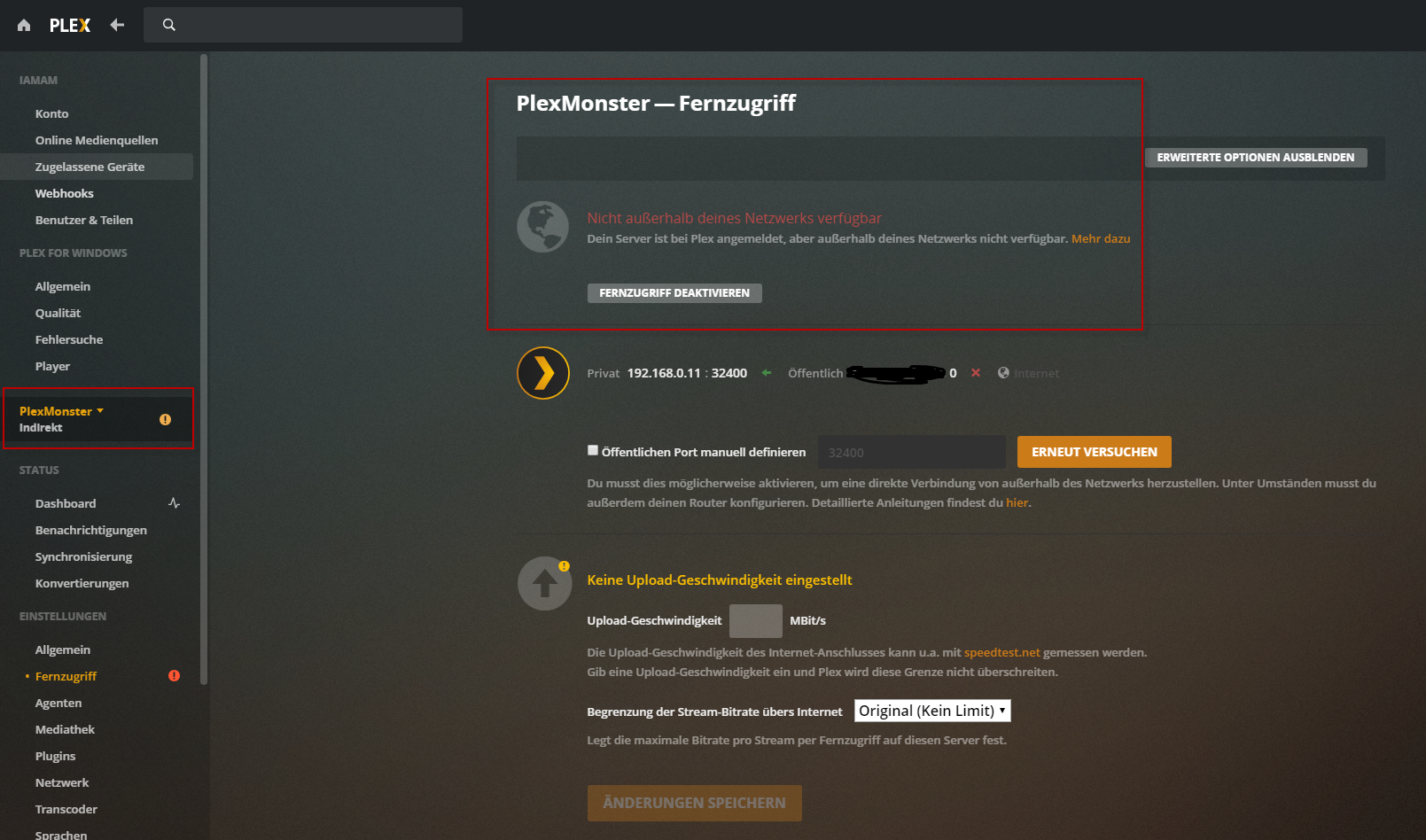

Hello all
I could need your help. As you can see on the attached pictures, my PlexMediaServer is not accesable from outside. Did I missined something?
Edited by DiniMuetter
1 hour ago, DiniMuetter said:
Hello all

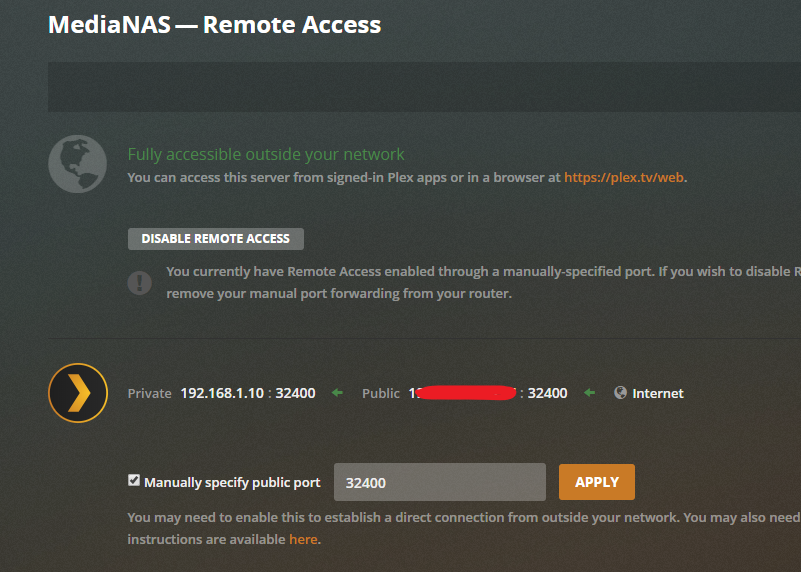

Does your router support UPnP (and if so is it enabled?) or did you set up a port forwarding rule in your router?
You might try setting up a manual port forward in Plex even if you are using the standard port 32400.
That's what I do as I have disabled UPnP and set up a port forwarding rule for 32400.
Edited by Hoopster
Also, if you are behind a VPN service, most block open ports unless you are with a VPN provider than allows you to open ports for redirects (like I do with Mullvad).

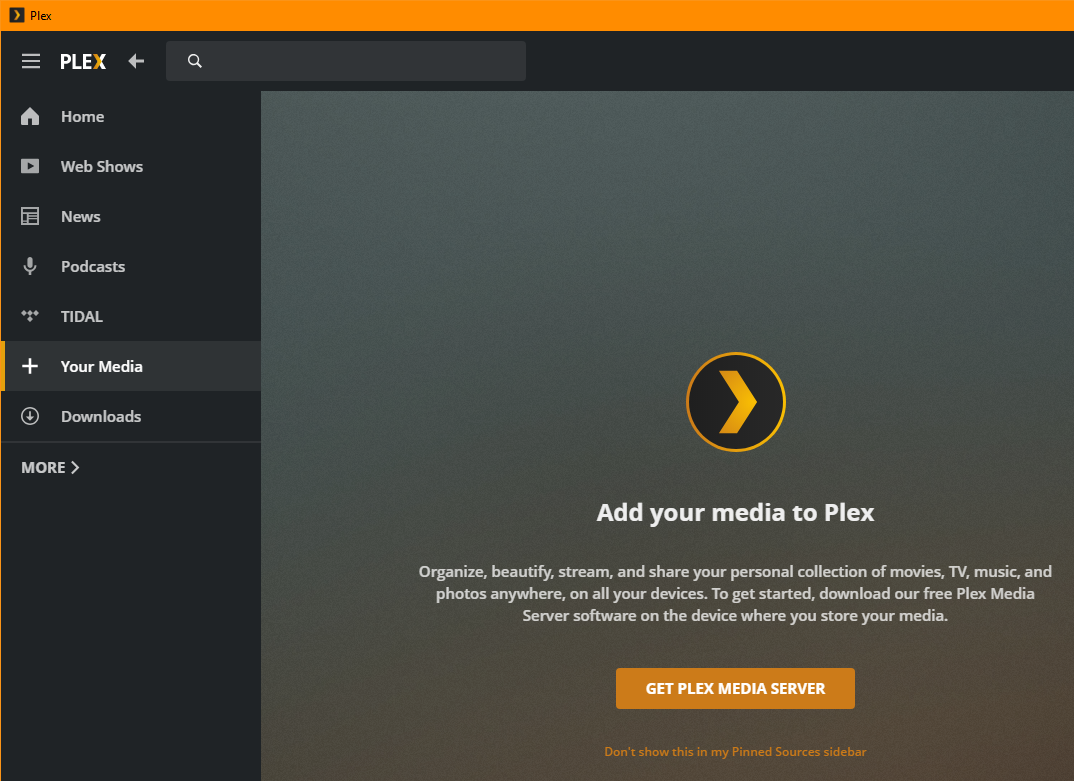

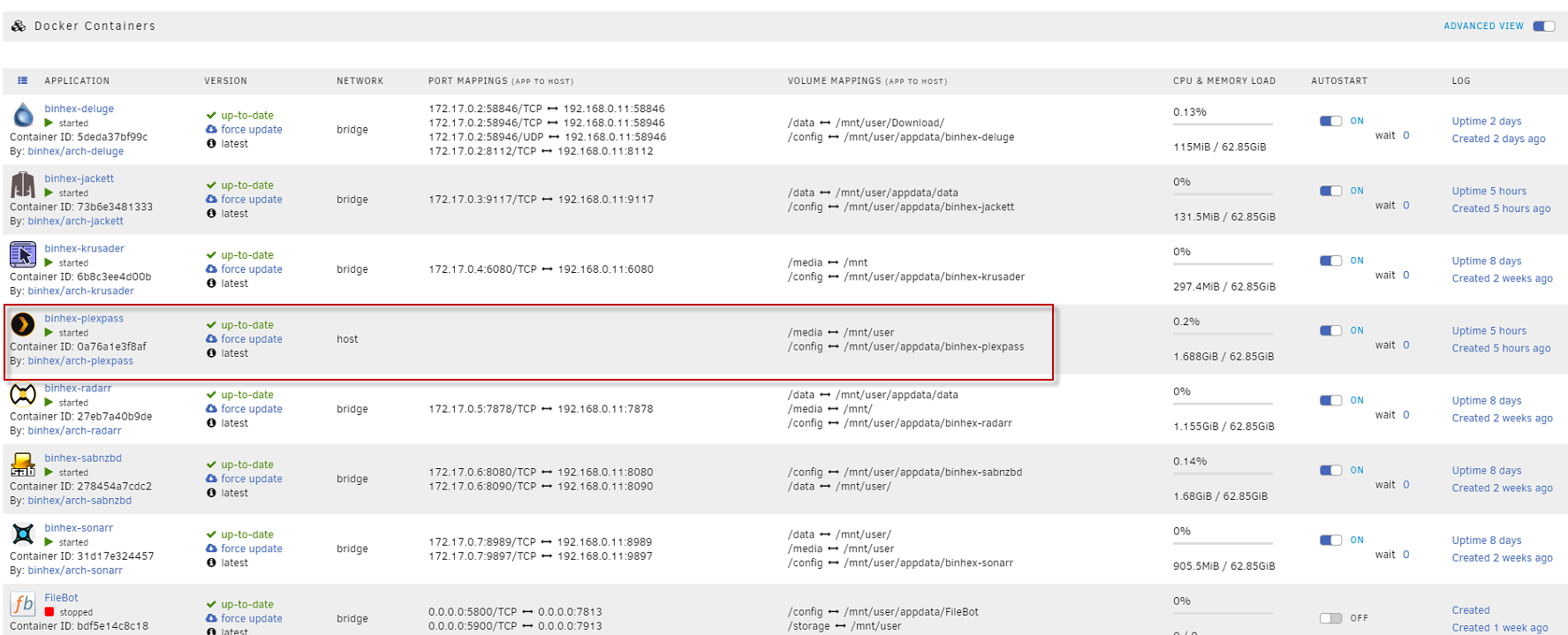

I'm pobviously missing something so basic a that I feel like a fool asking this question.
I've installed the docker, fired it up, all seems to be running, no obvious errors in the log files.
When I go to the WebGui and click on My media I get the following:
Add your media to Plex
Organize, beautify, stream, and share your personal collection of movies, TV, music, and photos anywhere, on all your devices. To get started, download our free Plex Media Server software on the device where you store your media.
I'm running the container so obviously I have PMS running.  I have an account registered on Plex but I haven't subscribed to any service which require payment yet.  I wanted to see how it goes with my devices before doing that.

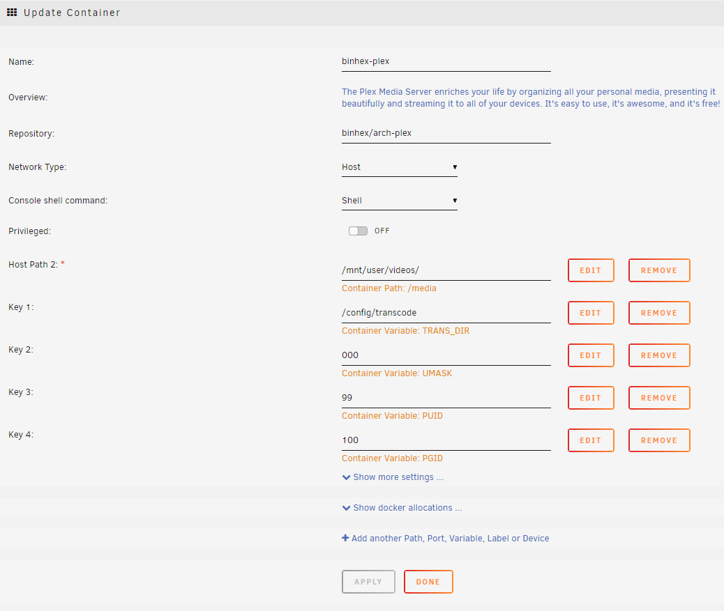

Attached is the PMS log and below the docker config screen shot.  I know there's something obvious and basic I'm missing, but I don't know what.

Not sure I understand.
Have you ever used Plex?
Did you try to add any of your media? Adding media in Plex is something you do from within the Plex application, regardless of how you have mapped it in the docker.
Maybe a screenshot of what you are seeing in Plex would help me better understand.
No, never used Plex before so there's no doubt I'm doing something stupid.  Always used Kodi but Santa dropped off a Smart TV early that has a Plex app so I thought I'd give it a go.
I see the following from the Web interface (http://my.server.ip:32400/web/) and from the Windows client I've installed (screen shot below).  I can't see where I can add my media to Plex.
That looks like the screenshot from your Windows client instead of from the server. I just opened mine and it looks like you can do it from there but I always just use the webUI to manage plex.
On the left, it is showing your pinned content. So far you only have the builtin web content (I actually unpin most of that).
Click on MORE >
That will show all of your content, and at the top will be your servername. There will be a + next to it (mouseover if you don't see it). Click that and it will bring up the Add Library wizard. Just work through that, using the container paths from your docker mappings to find your media. In your case you just have the one mapping, which gives your video share at /media inside plex.
Click on MORE >
It was the same behavior from the webgui on the server.  My servername never appeared at the top left above the content.
I have it up now, but with the official container from Plex.  I tried the linuxserver plex container and had the same behavior as this binhex one.  I then installed the official plex container and it finally showed me where I could add media.
The only difference between the 3 dockers that I could see was the official one made you "claim" your server.  Not sure if that matters or not but I'm up.
