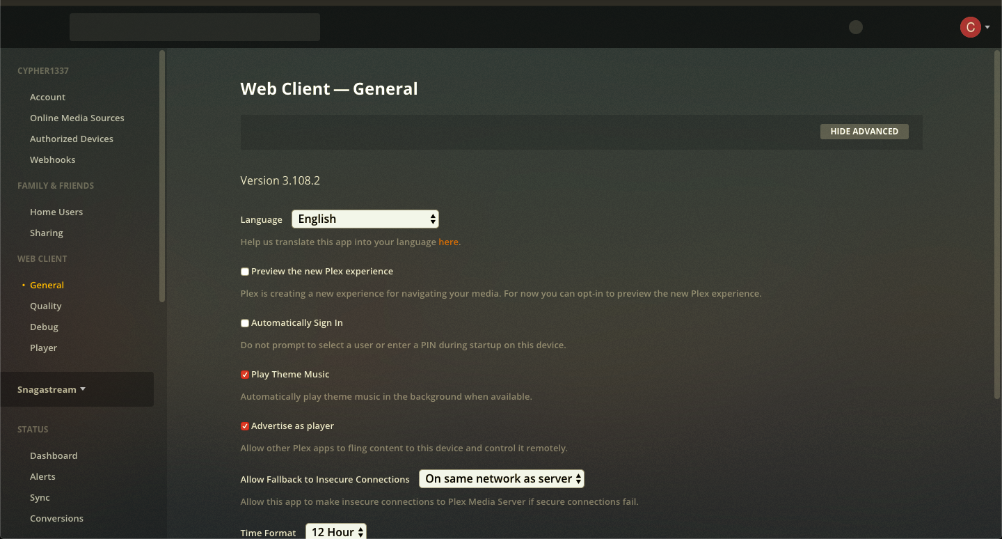

so this started happening with This recent updated of Plex.. It is missing all the buttons.. I have removed and reinstalled about 100 times.. still missing.. HELP!!!
I had an issue where my parity disk disabled. The fix was to restart, stop the array, unassign the disk, restart the array with the disk unassigned, stop again, reassign the disk and start. Once I did that, the array started building.
Since the parity drive was lost, all of my Docker containers lost their settings. The appdata is still there, but Plex (nor any other docker container) doesn't find the settings. The linked thread shows what I mean. Please let me know what other details might help resolve this.
I've stopped and restarted Docker, I've adjusted the network from host to bridge back to host, and still Plex doesn't see the server.
you sure you are running my image?, from the screenshot above you are running web client version 3.108.2, that looks very old, current version is 4.8.3 and which buttons exactly are we talking about here?

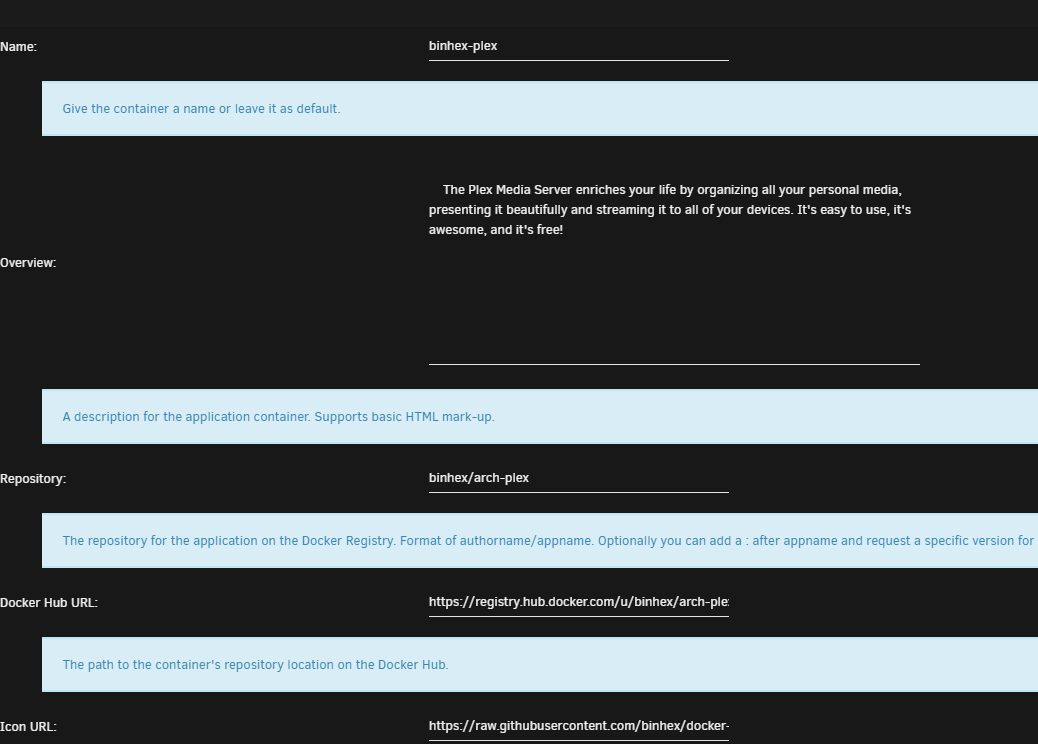

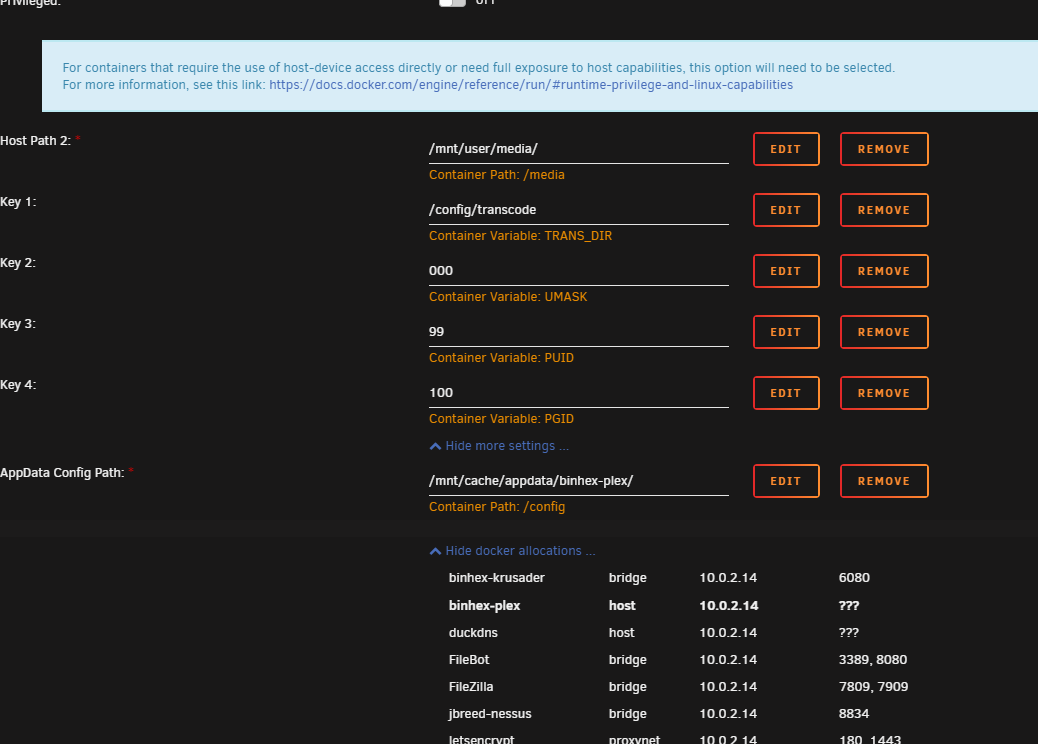

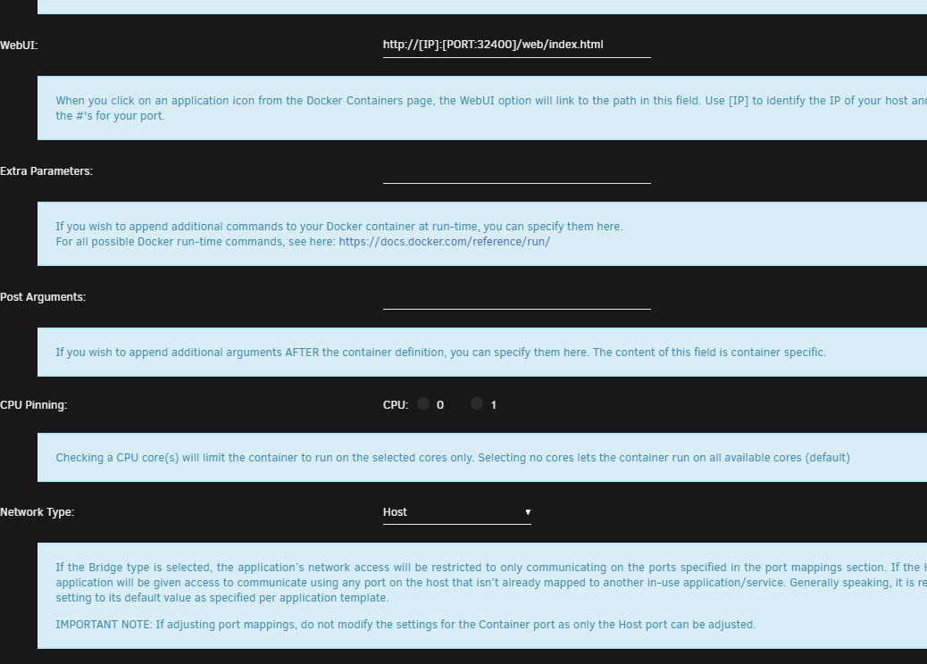

can you go to unraid web ui/docker tab/left click plex and select edit, then screenshot ALL the settings making sure to also expand 'show more settings' and make sure to toggle the switch top right for 'advanced view'
18 hours ago, binhex said:
this is simply not possible, there is no data stored on the parity drive, its purely used for parity calculations only, there is no file system on that drive, so something else caused the loss of settings, my guess would be 'mover' has moved your settings somewhere else.
Yeah, thanks for looking. Attached are those screenshots.
ok so that all looks well defined, i see nothing wrong there, so your loss of configuration could be any of the following:-

I'm no longer seeing my cache drive, I just noticed this. I'm not sure if it's been gone since this occurred. I've shut down the machine, reseated the cache drive and powered back on. Still not seeing it. I've stopped the array, and am unable to find the ssd that was my parity drive.
I'll try another disk as cache and see what happens then.
and life is good. Needed to replace the sata cable for the cache drive. Don't know why I didn't see that earlier.
