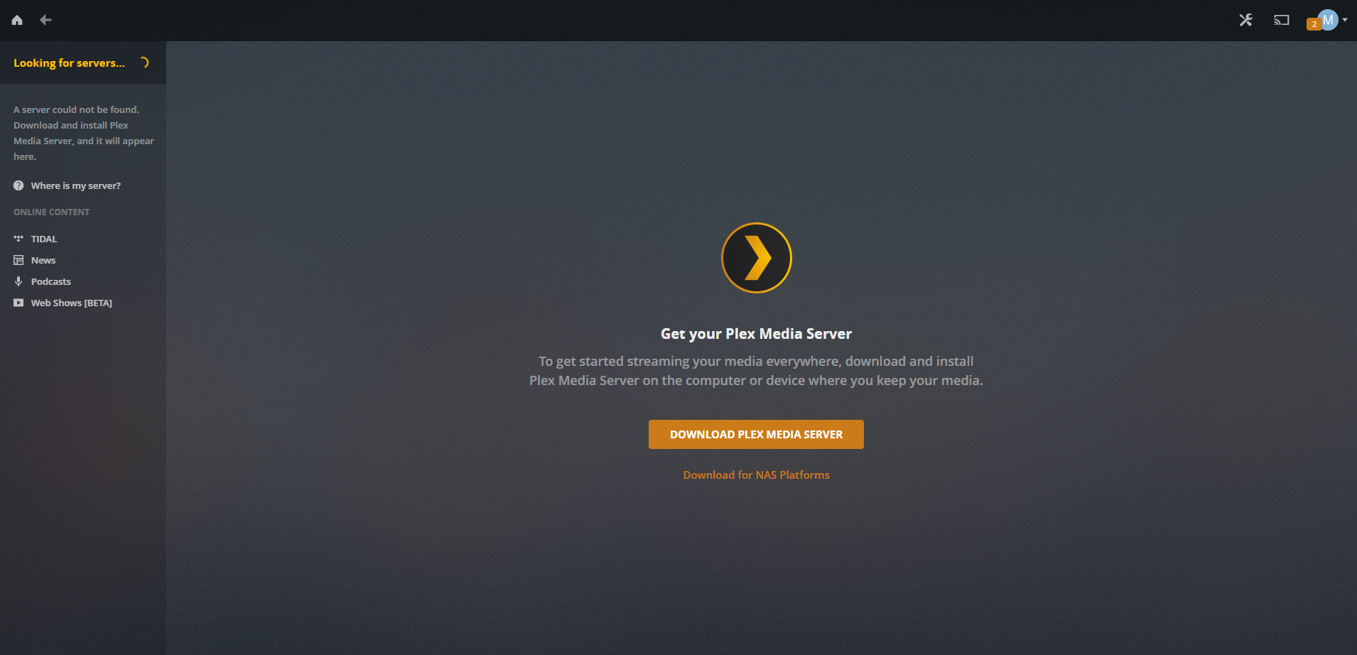

I've installed the binhex PlexPass docker.  I assumed (there's that word) that it would install Plex Media Server on my Unraid system (6.6.6).  So, I install the docker, and open the webui and it tells me it can't find a PMS (really??) and...
"Install your new server
Excellent. Check your download location for Plex Media Server and install it. Once it's running, check back here and we'll get you set up."
I don't know if it makes any difference, but I am running Unraid in a VLAN.  All my media is already installed and ready to be imported into Plex.
Is this normal?  If so, which version do I have to download?  Or, more likely, which step did I miss that's keeping me from installing PMS?
Thank you for your help (and your really nice dockers--I'm using quite a few of them right now).
I use a different Plex docker, but, I am sure the concept is the same with this one.  The docker installation is the Plex Media Server.  You do not download and install PMS separately.
When I installed the Plex docker, I got the same message about installing a server, but, after a few minutes, it sorted itself and presented the name of my unRAID server as the Plex server.
When you say you are running unRAID in a VLAN, what does that mean? Do you have a static IP address assigned to your unRAID server?  Did you install the docker in host mode so it is just piggy backing off the same server IP address, or, did you install the docker on a custom network/Docker VLAN and specify an IP address on a different subnet than the unRAID server?
It might help if you posted your docker run command.
Thank you for your response.  I have a managed switch with my Unraid server in Vlan 30.  I assigned it a static IP address of 10.0.30.200, and I've been able to get all my other dockers to run without issues (except for Unifi, but that's my lack of understanding).  According to the docker page, the network is set to HOST.  I just stopped and restarted the docker, and the webui takes me to the same screen as before--unable to find a server.
I don't know how to generate the docker run command that you asked about.
Here is a shot of the most recent log
Got it. Thanks.

Hoopster
I attached the docker run command to my previous message.  I still cannot get the PMS to come up
4 hours ago, Moose_Flunky said:
Hoopster
I don't see anything unusual in your docker run command.  Everything looks to be normal.
I wish I could tell you why the WebUI is not finding your Plex Media Server.  As I said, I run a different docker app for Plex, so, perhaps someone also running Binhex Plex has seen something similar and can help.
It almost appears as if somehow the webUI and the PMS/docker are not communicating because of some networking issue.  It is possible with docker VLANs to isolate dockers from the unRAID host such that they do not communicate, but, that does not appear to be an issue here.  Your Plex docker is in host mode on unRAID.
Does the installation need any particular ports to be open?  I know I have to do some port forwarding from my router to get some things communicating from the server to the big, wide world.
So, is PMS actually installed buy inaccessible, or is it stalling out during the installation?  Is there any way to tell?
yes it does need ports open to be visible on your LAN, but for this particular image you dont need to define them as it runs in "host" mode and thus do not need to (and cannot) define the ports for the container.
As far as incoming ports then yes if you want to connect to your plex server outside of your network then you will either need to turn on uPnP on your router or set a static port in plex and manually create the port forward on your router, the choice is yours as to which you do.
PMS is most definitely installed and works with the current latest image (i eat my own dog food), if you are having problems accessing the server then its most probably LAN related in some manner, so just check things like vlan, firewall, router etc and make sure its not being blocked.
@binhex
Thanks! I finally got it running.  It took quite a bit of installing and un-installing to get it running.  I eventually had to take my unRaid box out of my vlan (which was a pain, since the vlan was providing DHCP and routing), attach the box to a stand-alone modem that I could configure with the correct dhcp range, and then re-install.  Once I did that, the Plex library came up.  Interestingly, I was then able to put my Unraid box BACK into my vlan in it's former configuration and everything worked like a charm.  Something about the vlan was keeping the library from initializing, but once configured it had no issues.
Great package, btw.

2019-04-06 18:29:42,062 DEBG fd 8 closed, stopped monitoring <POutputDispatcher at 22464114988168 for <Subprocess at 22464114988240 with name plexmediaserver in state RUNNING> (stdout)>
2019-04-06 18:29:42,062 DEBG fd 10 closed, stopped monitoring <POutputDispatcher at 22464114990256 for <Subprocess at 22464114988240 with name plexmediaserver in state RUNNING> (stderr)>
2019-04-06 18:29:42,062 INFO exited: plexmediaserver (exit status 255; not expected)
2019-04-06 18:29:42,062 DEBG received SIGCLD indicating a child quit
2019-04-06 18:29:43,064 INFO spawned: 'plexmediaserver' with pid 59
2019-04-06 18:29:43,210 DEBG fd 8 closed, stopped monitoring <POutputDispatcher at 22464131352336 for <Subprocess at 22464114988240 with name plexmediaserver in state STARTING> (stdout)>
2019-04-06 18:29:43,210 DEBG fd 10 closed, stopped monitoring <POutputDispatcher at 22464114465896 for <Subprocess at 22464114988240 with name plexmediaserver in state STARTING> (stderr)>
2019-04-06 18:29:43,210 INFO exited: plexmediaserver (exit status 255; not expected)
2019-04-06 18:29:43,210 DEBG received SIGCLD indicating a child quit
2019-04-06 18:29:44,212 INFO spawned: 'plexmediaserver' with pid 64
2019-04-06 18:29:44,410 DEBG fd 8 closed, stopped monitoring <POutputDispatcher at 22464131352336 for <Subprocess at 22464114988240 with name plexmediaserver in state STARTING> (stdout)>
2019-04-06 18:29:44,410 DEBG fd 10 closed, stopped monitoring <POutputDispatcher at 22464114971856 for <Subprocess at 22464114988240 with name plexmediaserver in state STARTING> (stderr)>
2019-04-06 18:29:44,410 INFO exited: plexmediaserver (exit status 255; not expected)
2019-04-06 18:29:44,410 DEBG received SIGCLD indicating a child quit
2019-04-06 18:29:46,413 INFO spawned: 'plexmediaserver' with pid 69
2019-04-06 18:29:46,546 DEBG fd 8 closed, stopped monitoring <POutputDispatcher at 22464131352336 for <Subprocess at 22464114988240 with name plexmediaserver in state STARTING> (stdout)>
2019-04-06 18:29:46,546 DEBG fd 10 closed, stopped monitoring <POutputDispatcher at 22464114465536 for <Subprocess at 22464114988240 with name plexmediaserver in state STARTING> (stderr)>
2019-04-06 18:29:46,546 INFO exited: plexmediaserver (exit status 255; not expected)
2019-04-06 18:29:46,546 DEBG received SIGCLD indicating a child quit
2019-04-06 18:29:49,550 INFO spawned: 'plexmediaserver' with pid 74
2019-04-06 18:29:49,697 DEBG fd 8 closed, stopped monitoring <POutputDispatcher at 22464131352336 for <Subprocess at 22464114988240 with name plexmediaserver in state STARTING> (stdout)>
2019-04-06 18:29:49,697 DEBG fd 10 closed, stopped monitoring <POutputDispatcher at 22464114971856 for <Subprocess at 22464114988240 with name plexmediaserver in state STARTING> (stderr)>
2019-04-06 18:29:49,698 INFO exited: plexmediaserver (exit status 255; not expected)
2019-04-06 18:29:49,698 DEBG received SIGCLD indicating a child quit
2019-04-06 18:29:50,698 INFO gave up: plexmediaserver entered FATAL state, too many start retries too quickly"
My settings are the same with the exception of I don't have privileged on have you tried without it on
turned off privileged and still nothing :/
Edited by JohnGrosshans
spelling
I got impatient and deleted the old docker, renamed the appdata folder for it old-binhex-plexpass and reinstalled. It's chugging through my libraries now. Weird.
It's possible you have corruption of your metadata if I were you I would make a backup of your Plex folder once it's finished indexing all your media I have a weekly cron job that does just that for me or use the backup plugin
