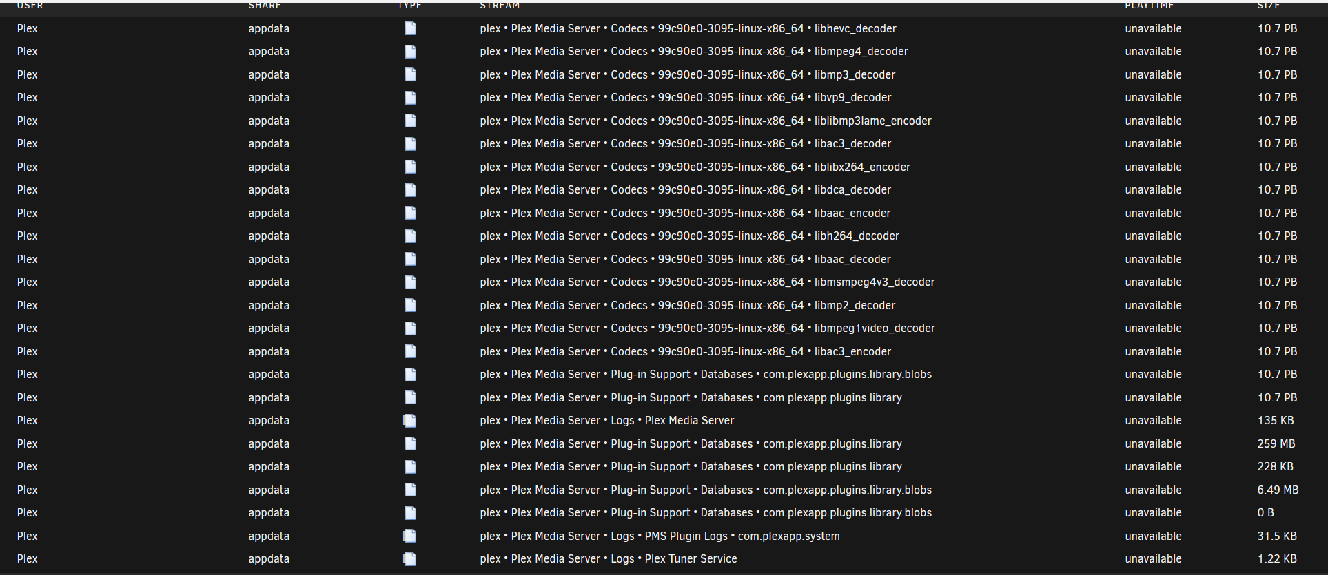

Hey guys!
After watching Spaceinvader One's video about migrating Plex library with rsync, I tried it last night.
After the procedure I started the docker back up and had no troubles. But checking Active Streams, I realized that a lot of Plug-In Support and Log files were being read or written.
I tried erasing those Log and Plug-ins but finally I broke my Plex. I pointed the container to the old Appdata and everything was fine as before the rsync.
Also, with the old appdata folder, no file were being read or written.
What do you think could be causing this?
Thank you!
1 hour ago, Sanches said:
Hey guys!
possibly incorrect or missing rsync options would be my guess, what rsync command did you issue?
im not really sure what you mean by this, i would expect log files to be written to, so this sounds normal to me.

Thanks for your reply
I'm using "sudo rsync -avh source destination"
All other containers worked fine after the migration. Only Plex is having this issue.
There's a Plug-in for Unraid that shows active files in the server.
When Plex runs using the old location and I check this plug-in, no file shows as being used (unless while playback).
When I point the container to the new location, a bunch of files start to be read/written.
Hope I've explained a little better.
For some reason after the copy Plex is reading and writing this files nonstop.
Today I'll try to copy the appdata using "cp".
I'll let you know tomorrow
Cheers

Same thing:
Another information: I'm going from a XFS Unassigned disk to the BTRFS cache.
Cheers
Edited by Sanches
LOL
Probably this plugin Active Streams doesn't show opened files from Unassigned Devices (where my old Plex appdata has located)
Once I started the Plex docker with the appdata in the cache, this files are now showing up but that doesn't mean they were not being used before.
If that's the case... just LOL
