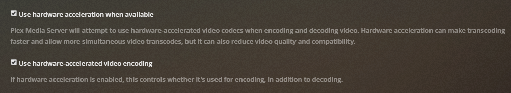

Follow this guide to get hardware transcoding going with the iGPU.

3 minutes ago, Uggers said:
Quick follow up, is Plex Pass mandatory then?
Yes, no hardware transcoding without Plex Pass.  You can still transcode in software (CPU) without Plex Pass.
Here is a link to the Plex page outlining the requirements for hardware transcoding and the first thing mentioned is an active Plex Pass subscription:
https://support.plex.tv/articles/115002178853-using-hardware-accelerated-streaming/
I don't think these options even show up in Plex unless running a Plex Pass version:

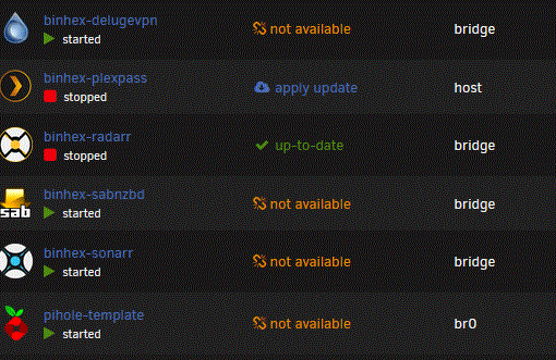

I have started getting a problem with all my Binhex containers. I have deluge, plexpass, radarr, sabnzbd and sonarr. I updated recently now keep getting update available message. Also containers keep showing as "not available" in version. Image attached. Its not consistent though. If I refresh the page the message often moves to a different container. Im also having trouble connecting to the Plex container from some devices.
I just ran an extended test using fix common problems and am getting the message:
Unable to communicate with GitHub.com - Reset your modem / router or try again later, or set your to 8.8.8.8 and 8.8.4.4 Also make sure that you have a Gateway address set up (Your Router's IP address). Additionally, this may also mean that GitHub is currently down. This error means that you may not be able to update your OS or plugins
I have a gateway address set.
trying doing a 'ping github.com' from unraid host terminal, i would assume it will fail, in which case you need to figure out why its failing, check dns, firewalls, router, modem etc.
