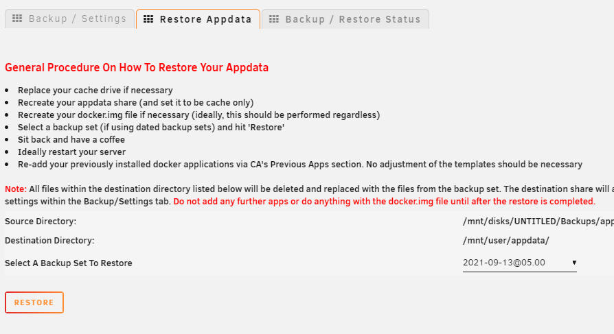

I still have the CA Backup from 2 days ago. I'll wait for the disk rebuild process to finish and then I'll try to restore the appdata folder.
I'm guessing the process should be as simple as this:
But I might recreate the docker.img file before. Just in case.
Hi binhex.

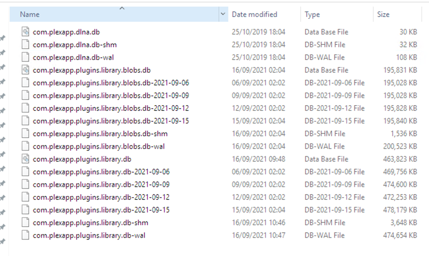

So I recreated my docker.img file and restored my backup from 3 days ago (when Plex was still working fine). Unfortunately, after installing Plex again, it now says this:

Checking Plex Media Server.log I get this:
Sep 16, 2021 10:17:03.606 [0x146a37ab1b38] INFO - Plex Media Server v1.24.2.4973-2b1b51db9 - unknown PC unknown - build: linux-x86_64 redhat - GMT 01:00
Sep 16, 2021 10:17:03.606 [0x146a37ab1b38] INFO - Linux version: 5.10.19-Unraid (#1 SMP Sat Feb 27 08:00:30 PST 2021), language: en-US
Sep 16, 2021 10:17:03.606 [0x146a37ab1b38] INFO - Processor Intel(R) Core(TM) i7-4790K CPU @ 4.00GHz
Sep 16, 2021 10:17:03.606 [0x146a37ab1b38] INFO - Compiler is - Clang 11.0.1 (https://plex.tv e0c29d5827bc4eaaa2ceb882cbeed224b0960173)

So there is still database corruption, even though this is restored from a past backup.
I'd love to try the method of using one of Plex's own backups, but when checking mine, the blobs files have different dates?
So I guess I'm stuck with Plex's own guide, even though I can't seem to get sqlite3 to run..
they will have, that is the date of the backup, the ones shown in the FAQ are examples.
I do understand that, but is it normal to not have a library.blobs.db and a library.db files backed up during the same day?
no thats not normal, you should see the same date for both the library.blobs.db and library.db file, from my system:-
I figured as much.
