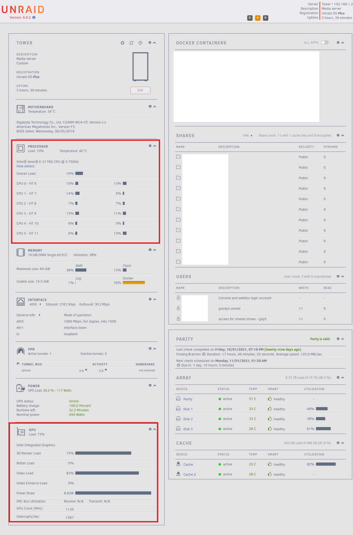

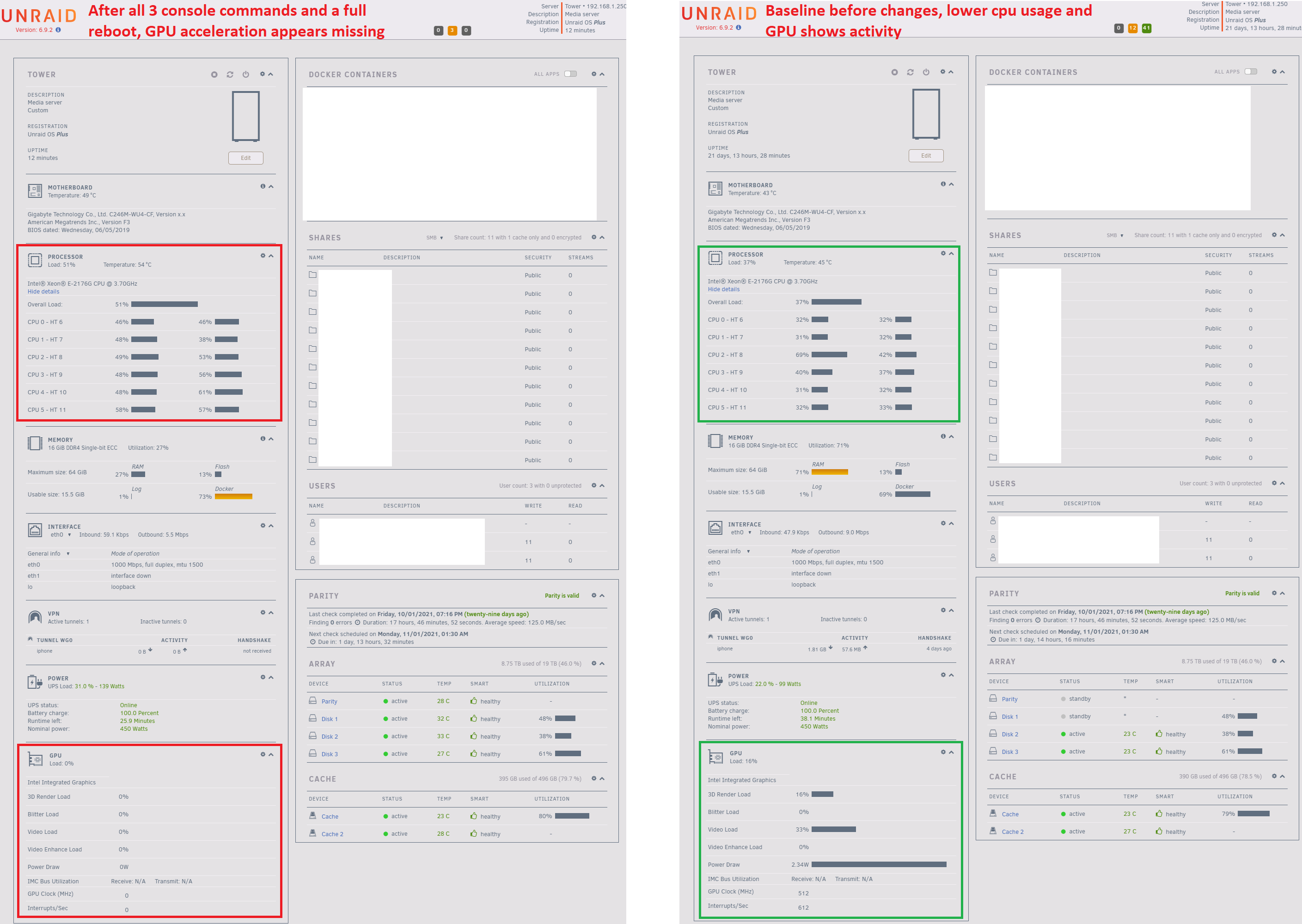

Hey @binhex, quick update.
so I tried both the first post's suggestions:
pacman -Syy && pacman -S ocl-icd --noconfirm
pacman -Syy && pacman -S intel-compute-runtime --noconfirm
and
export aur_packages=intel-opencl-runtime && aur.sh
(which took a little while but I didn't notice any errors.
I rebooted the container between each and also my unraid server entirely at the end. My testing up until now had just been 1080p HDR files, so I wanted to better match what @thatsthefrickenlightning was doing by throwing a 4k HDR file at it. I connected by iPad to a vpn (to send the traffic outside of the local network) and forced transcoding to 1080p 10mbps (as it was happily playing via direct play till I did so.
At this point I could confirm that transcoding was occurring for both audio and video. I also noticed that within Plex is looked like my CPU usage had gone up from +/- 40% (it bounces around of course) to 50-60%. I also see changes on the Unraid dashboard, attached is a screenshot of that. On the right is my baseline screenshot which is the "vanilla" plex container.  Cpu usage roughly matches what plex reports and you can see that GPU usage, at least as reported via the "Intel GPU TOP" plugin has disappeared. This absence of gpu usage is similar to if I remove "/dev/dri" device from the container. I did reboot in case something about the package change required a full reboot.
My system can keep up with HDR in realtime (probably due to the number of cores, it's a decent chip) but it does appear those commands seemed to have removed whatever gpu offloading was already occurring for me.
so just to be clear, are you saying that after those packages are installed that hw tone mapping is taking place for your igpu?, if so im not sure why this is not the case for @thatsthefrickenlightning im assuming you guys have different cpu's.
edit - ahh i see reading your screenshots the wrong way around, so applying those packages makes things worse not better right?, hmm. ok this is getting a little painful, im basically shooting in the dark here guys, feel free to take a look through Arch repo and Arch User repo (AUR) and try installing any other packages, if you happen against the magic sauce then let me know.
@binhex Correct! yes sorry I should have flipped those images hah :)
Yes I'll dig around. I BELIEVE that i'm seeing at least partial acceleration but (based on @thatsthefrickenlightning's reporting) with your container as delivered but I think that it's not utilizing all the hw acceleration capabilities for intel gpus.  I'll keep digging around the threads
Question to help me troubleshoot:
https://forums.plex.tv/t/package-beignet-required-for-hardware-transcoding-of-hdr-content-hdr-tonemapping-now-supported/655048/26
If you look at that post, when Plex is installed/updated it looks like it tells you if the 2 packages it needs are found? Is there a command line I can run in your container to force plex to update/install over itself? I don't THINK the install log is saved to a file or at least I couldn't find the location. I was hoping that (as shown in the post above) the install would identify which (if any) of the intel packages are found or if any are missing. I THINK the beignet package is the one it can't find.
I don't want to pull the container again as I think I'll  lose the changes we made and I wasn't sure of the command in Arch to do so.
I'll also install the linuxserver container as a comparison against by baselines as it does appear people are having success with mapping and acceleration with intel igpu's all the way up to gen 10.

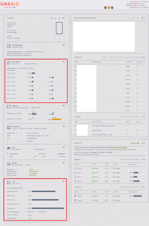

Hi @binhex @thatsthefrickenlightning !
Just a quick post, wanted to confirm that linuxserver's container shows much lower cpu usage and much improved igpu utilization with the same video file I was testing on binhex-plex.
This test was done:
- with the same 4k HDR 20gb video file I was testing in the binhex-plex container in the post above where I shared unraid dashboard screenshots
- forcing transcoding to 1080p 10mbps
- Transcoding is occurring in Ram (/tmp)
During heavy transcoding activity (filling up the 60 second buffer):
- Unraid dashboard now shows cpu usage is around 10% with linuxserver-plex, down from 40% with binhex-plex
- "Intel-GPU-TOP" plugin on the dashboard reports GPU video load of 70-80% with linuxserver-plex, up from 30% with binhex-plex
Once playback has buffered and transcoding is just "topping off":
- Unraid dashboard now shows cpu usage mostly idle (under 10%) with linuxserver-plex
- GPU video load has short spikes every 5 seconds to 20 or 50%  with linuxserver-plex
So far I'm really impressed with the performance and quality of the tone mapping being done for about 8 watts of power. I'm probably going to stay on this container for a little and see if I run into any issues.
I will keep my eyes out for any more information about what the team that supports the LS container may have done to get this working. I have a feeling there are also some changes made in the intel compute or beignet packages themselves, maybe this didn't get carried over to the Arch Linux versions? I think this may have improved support for older/less common device ID's as intel's GPUs didn't change a great deal for a number of years so chips like Kaby Lake could be made to support it as well (vs Coffee Lake and above).
Perhaps the packages simply aren't available for Arch yet, or they're not in the right working condition. With LSIO's container running on Ubuntu (if I'm not mistaken), that's a different ball game. Maybe @linuxserver.io can weigh in on this: are there Arch equivalents of ocl-icd-libopencl1 and beignet-opencl-icd available and are they working? We're having some trouble with this over here (no HW tone mapping on Intel). Thanks much.
Edited by thatsthefrickenlightning
