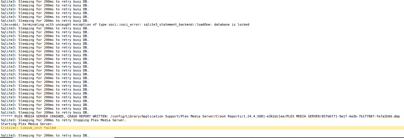

I'm getting this error all the time now: Critical: libusb_init failed
Any idea how to solve it? Can't get into my Plex GUI and watch movies.....
Ever able to resolve this? I am having the same issue.
Ignore that message it is not critical and is caused by a bug in plex, check your Plex log, probably database corruption would be my first thought as this is quite common
Sent from my CLT-L09 using Tapatalk
EDIT - just to expand on this now im not on my phone, see Q4 and Q5:- https://github.com/binhex/documentation/blob/master/docker/faq/plex.md
You're right. I uninstalled and installed again. Now working. Thanks.
