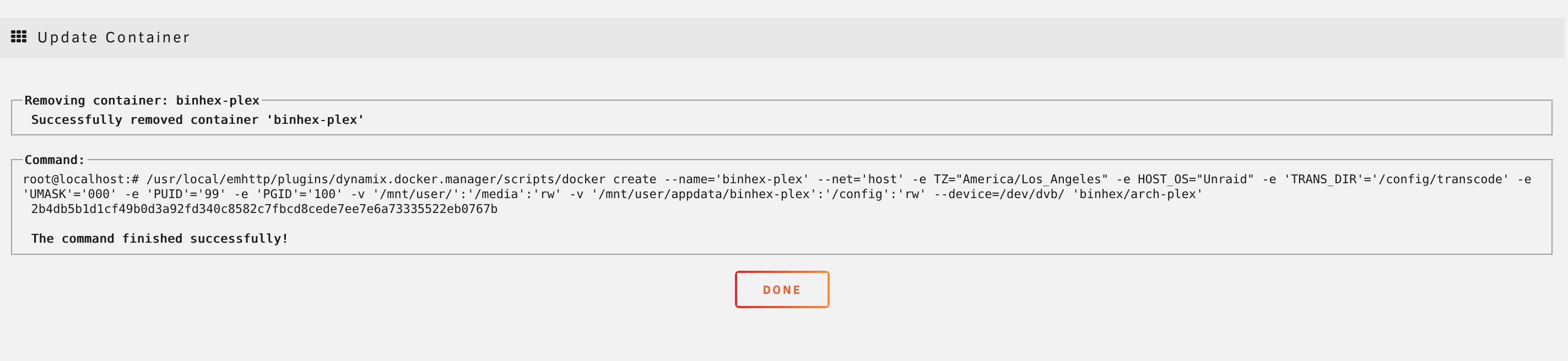

Hi there,
Long time user of Binhex Plex and have always loved it. Recently however I have had an issue where if I update Unraid Plex will no longer start. I get an "Execution Error". The logs only seem to show this e":"No such container: f1df187df544"}
If I revert to the prvious version of Unraid Plex works again.
Here is the Docker run command.
Any help would be greatly appreciated and my apologies if I didn't provide enough detail.
