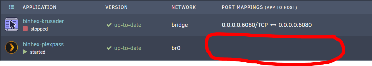

I do have another question with this version of Plex.  Is this normal to not see ports being used in the docker tab?
Yes it's in host mode.
Sent from my CLT-L09 using Tapatalk
Sorry, but is there a way that i can change it so that i can see it or is that just how the docker was created. (new to docker and unraid ;-) )
Your can switch it to bridge but then you will have to define all ports for Plex, and yes there are a lot of them, I don't know the port numbers so you would need to find that out yourself.
14 minutes ago, jonathanm said:
Here is a port list.
https://support.plex.tv/articles/201543147-what-network-ports-do-i-need-to-allow-through-my-firewall/
It's much easier to allow plex to manage them in host mode than to add them all manually.
Thanks.
I'm currently using custom br0 so that i can assign it a different IP address in that same subnet.  Is that why I'm not seeing anything there?  Plex is working fine (all ports seem to be open) and I can access the site by manually typing it into the web browser...just wanted another way to get to the WebGUI.
