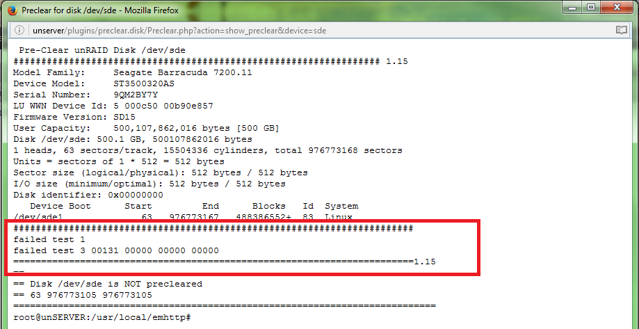

OK; after starting with a 'test'...I get this
Is that all she wrote; no need to even go further? Bad disk??
Post SMART attributes for the disk

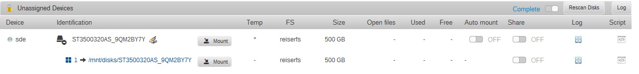

OK, sorry; how do I do that...for an unidentified device?
Click on it where it says "sde" in your screenshot.

That's a dead area trurl; but when I clicked on ST3500...
I got this?
Are you on latest version of Unassigned Devices?
How did you run preclear. It looks like you ran a preclear test.
Updated Unassigned Devices; still don't see smart report.
Screen shot?
Screen shot?
Works for me. Not sure what the difference is.
Read the v5 sticky linked in my sig for the old way of getting SMART.
Are you testing a disk before preclearing it? This test is to confirm the disk was correctly precleared, it will always fail before a preclear.
