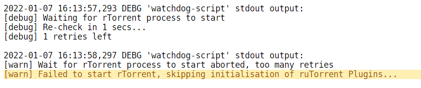

2022-01-04 10:58:50,407 DEBG 'watchdog-script' stdout output:
[warn] Wait for rTorrent process to start aborted, too many retries
[warn] Failed to start rTorrent, skipping initialisation of ruTorrent Plugins...

2022-01-04 10:59:31,589 DEBG 'watchdog-script' stdout output:

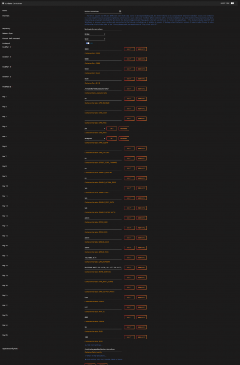

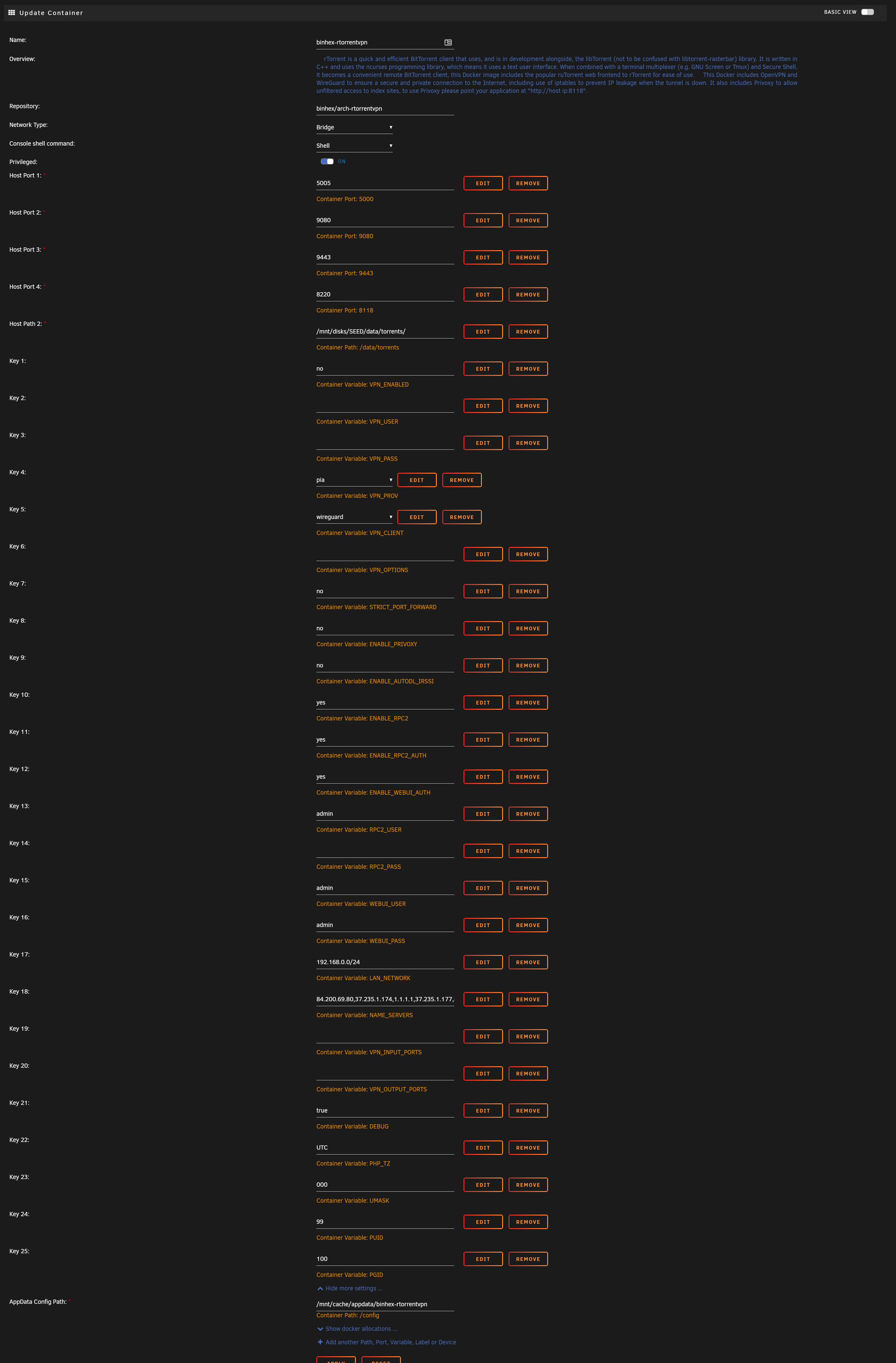

On 11/30/2021 at 5:19 PM, casperse said:
Almost ready to give up and move on to another solution but I must admit I have most trust on Binhex and the security built in these dockers...Can anyone give any input on why this isnt working? Cheers
I really need some help trouble shooting this!
1) I got the delugevpn working but I would like to use the rTorrent 🙂
2) I had this working a year ago, but after doing a total re-install I cant get the rTorrent to run? (No VPN or Strict port forwarding)
My configuration is as shown below:
Log:
Error log:
1641568550 C Caught exception: 'Error in option file: ~/.rtorrent.rc:61: Bad return code.'.
The access rights is fine (even did a chmod 777, just to make sure)
1 hour ago, casperse said:
Error log:
can you attach your rtorrent config file, it should be located at /config/rtorrent/config/rtorrent.rc
Thanks for helping me!
I did a remove all docker templates and docker image and did yet another re-install and I also removed the "perms.txt" just to make sure perms where not the problem and I got the UI to start! 🙂
But my speeds are really slow?
So I wonder if I am missing any portforwarding?
So far I thought I only needed the wireguard port 51820/UDP?
Should it be the whole range 51820 - 65535 UDP?
Other ports shouldnt be needed when I only want it to use the Wireguard VPN right?
I Also have Strict Port forwarding set to yes...
So close now... LOL

On 1/4/2022 at 5:27 PM, ReDew said:
I'm not sure what's going wrong with the initialization, but it is not starting and keeps looping.
I am currently having a very similar issue. The container works on first run after barebones install & basic VPN config, but any subsequent restart of the container or the Unraid host causes the startup loop that you posted.
/mnt/user/Media is mapped to /data in the container, permissions look OK, I'm a bit stuck now and would appreciate any advice. Thanks.
