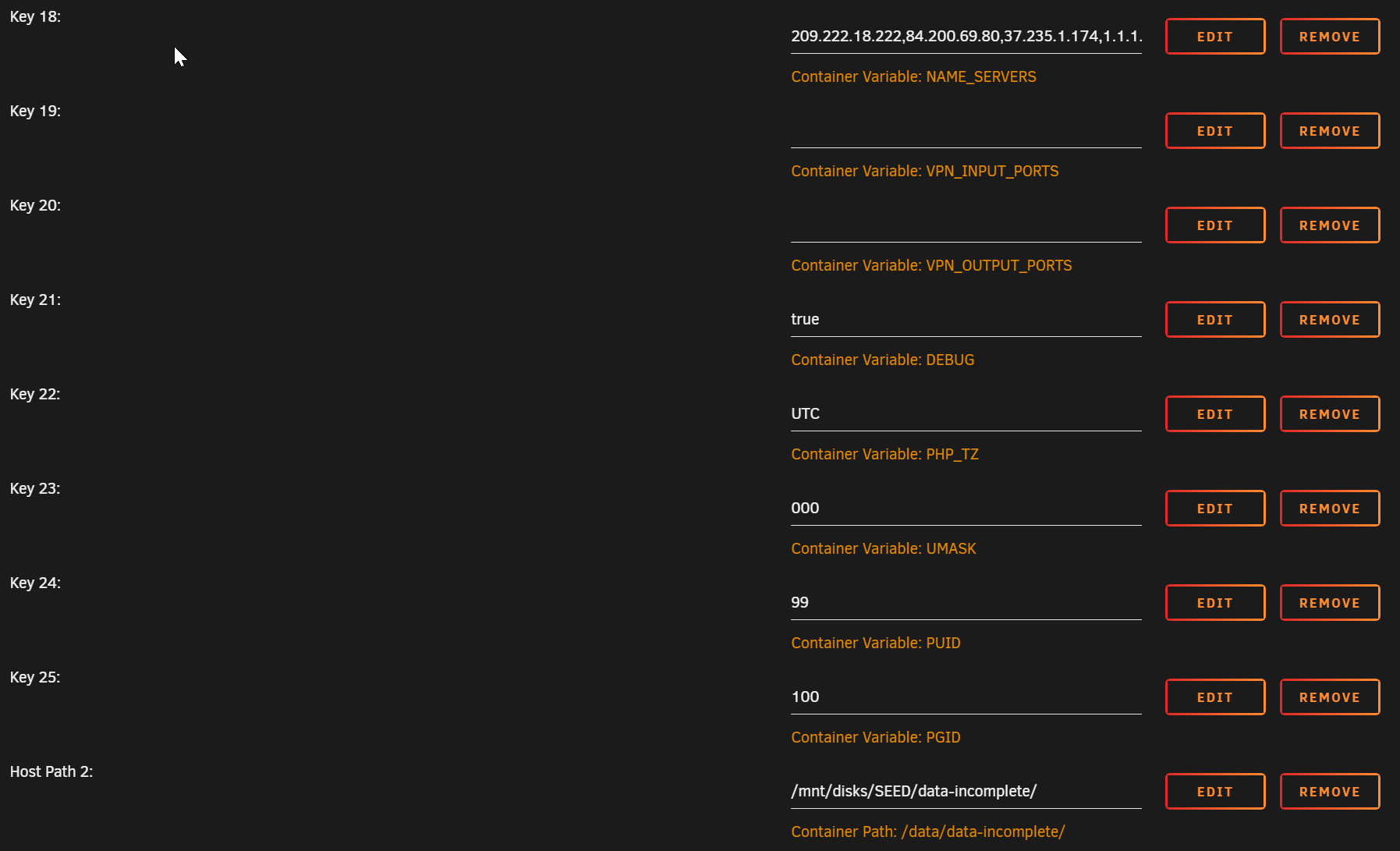

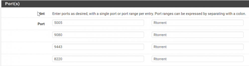

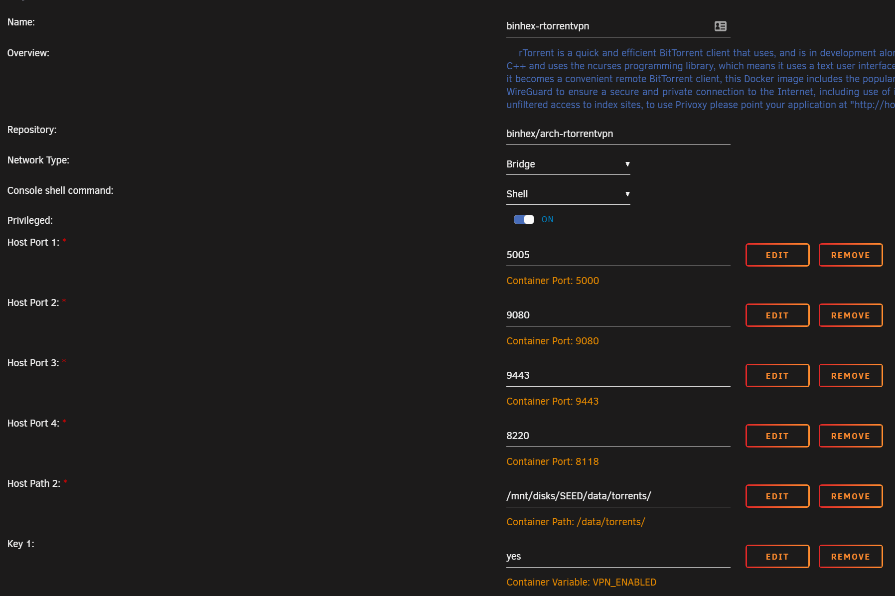

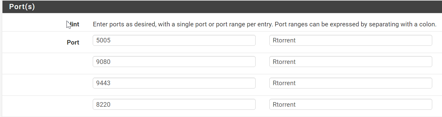

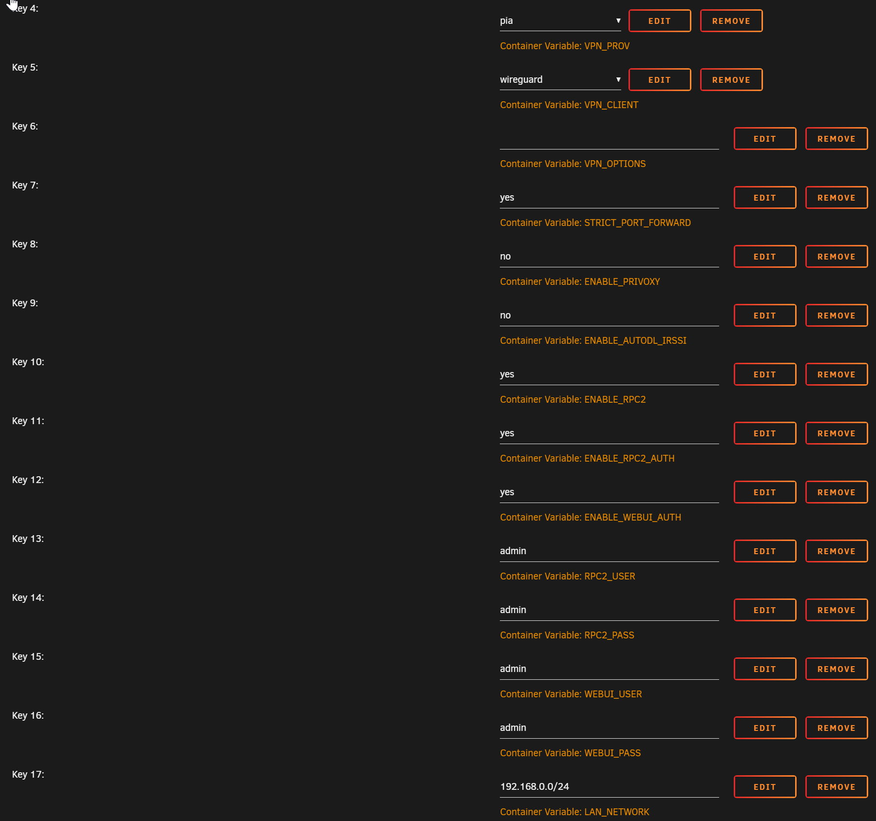

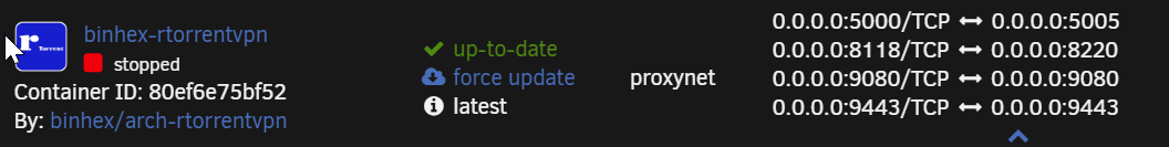

Just moved back to PIA (Black Friday) and I am following the Wireguard guide and I have everything working for Deluge
But for some reason rTorrent just dosent want to startup?
I have checked that the ports are open (Same as before) and I have enabled debug.
Also tried to re-install the docker and removed the App data
Error Log:
2021-11-26 23:10:29,752 DEBG 'watchdog-script' stdout output:
[debug] Waiting for rTorrent process to start
[debug] Re-check in 1 secs...
[debug] 3 retries left
2021-11-26 23:10:30,756 DEBG 'watchdog-script' stdout output:
[debug] 2 retries left
2021-11-26 23:10:31,760 DEBG 'watchdog-script' stdout output:
[debug] 1 retries left
2021-11-26 23:10:32,764 DEBG 'watchdog-script' stdout output:
[warn] Wait for rTorrent process to start aborted, too many retries
[warn] Failed to start rTorrent, skipping initialisation of ruTorrent Plugins...
[debug] VPN incoming port is 50344
[debug] rTorrent incoming port is 50344
[debug] VPN IP is 10.14.238.230
[debug] rTorrent IP is 0.0.0.0

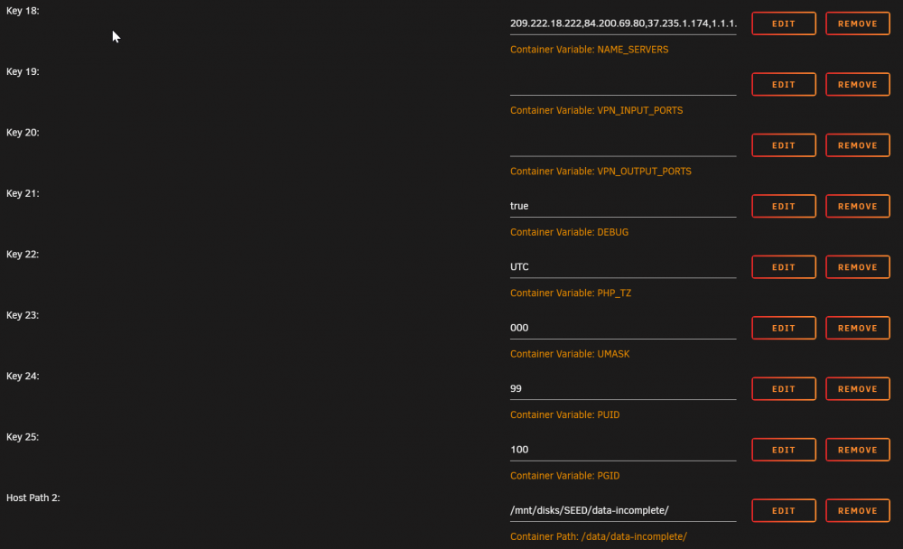

Tried to change so many things (I was sure I could get this working, if I just kept trying LOL)
I have tried changing the NAME SERVERS from
209.222.18.222,84.200.69.80,37.235.1.174,1.1.1.1,209.222.18.218,37.235.1.177,84.200.70.40,1.0.0.1
To:
84.200.69.80,37.235.1.174,1.1.1.1,37.235.1.177,84.200.70.40,1.0.0.1
Still cant start it....tried binhex-qbittorrentvpn and that also works just not rTorrent?
Update: I have them all on my "Proxynet" and only the binhex-privoxyvpn on "Bridge"
(I have 5 PIA licenses but I cant run Deluge & privoxyvpn at the same time?
My ports for the rTorrent is matching the ones on the docker:
Docker:
I can also see that the wg0.conf is generated !
Anyone have any input to what I am doing wrong? 🙂

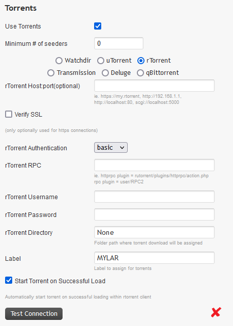

Question for you all-
I am trying to set up Mylar, a community docker designed to fetch comics.
It's designed to tie into various torrent and sabnzbd clients to perform downloads.
I am trying to set it up with this rtorrent container, but have not been able to figure out the required configuration.
I have confirmed that both rpc and httpprpc are enabled in the rtorrent webUI, but don't see any settings there to configure them.
I've tried a variety of combinations of settings in the Mylar settings (see image) with no success.
Using RPC2 on the webui port I get 401 Unauthorized, even with credential filled in.
Using httprpc I get 404 Not Found regardless of how I form the request.
Can anyone provide guidance on how to configure either rtorrent or Mylar to make this work?
To:
Docker:
Logfile:
I did try to add the above port:49184 but that didnt work either
Almost ready to give up and move on to another solution but I must admit I have most trust on Binhex and the security built in these dockers...Can anyone give any input on why this isnt working? Cheers
