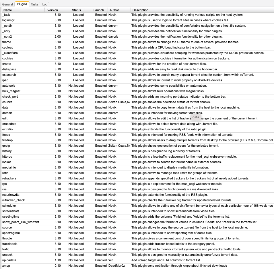

I have suddenly started getting the following infinite loop in my log, ruTorrent attempting to start over and over again.  See the attached for a full log
2022-04-18 20:32:26,728 DEBG 'watchdog-script' stdout output:

I've tried restarting, rebooting, reinstalling the docker image.  I'm really at a loss here
It looks like only some of the plugins are loading properly
On 1/4/2022 at 11:27 AM, ReDew said:
I'm not sure what's going wrong with the initialization, but it is not starting and keeps looping.
Did you figure this out out?  I am seeing the same issue suddenly, and I have not changed my config in months if not years
Edited by veri745
My symptoms were quite similar to yours. Working fine, no config changes, just stopped working one night. Never did find a fix and moved to binhex-qbittorrentvpn instead, which is working fine.
Edited by bonzog
My issue was changing the name of the /data directory in the during the install. You should see if you can find any clues in the logs file.
