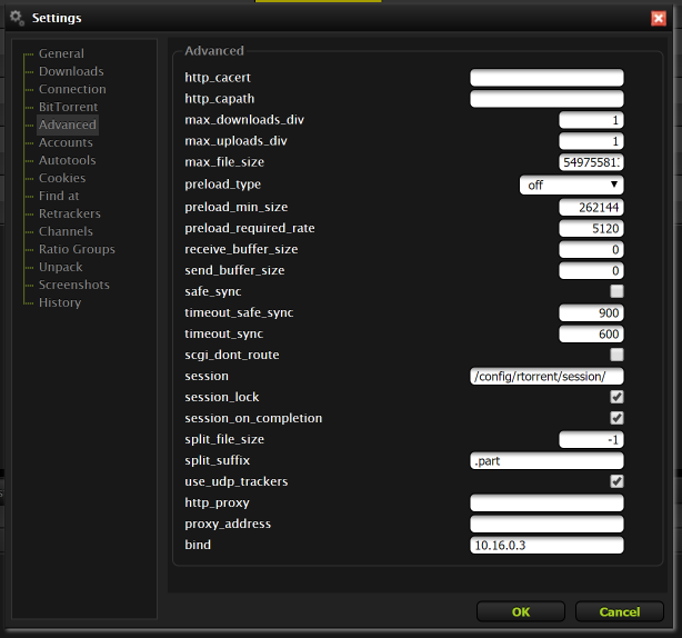

yep this is completely normal, in short rutorrent (web interface to rtorrent) allows you to save settings ONLY for rutorrent, so saving settings for any rutorrent plugin will work, HOWEVER if you want to save any settings for rtorrent, such as incoming port, then the only want to do this (and make it save between restarts) is to define it in the rtorrent.rc file, rutorrent does NOT write out settings to the rtorrent config file (rtorrent.rc) and never will (according to the author) - see my FAQ for more details.

On 11/2/2018 at 1:56 AM, Xaero said:
Try setting "-t" as an extra parameter in the advanced tab and seeing if you still see the abnormal CPU usage reporting.
Hi mate. Do you mean somewhere here?
Or do you mean somewhere in the container settings?
Thanks for the reply btw!
EDIT: Okay Binhex said it might not do anything, I guess I could just disable the CPU plugin then if I wish or wait until something is done about it. Either way I only wanted to know if it's something to worry about. I thought maybe I needed to give the container more RAM or CPU or something, but I didn't think that was even possible as I thought Docker containers run straight through the main machine's resources rather than like a VM, taking a portion of system resources. Anyway if it's nothing to worry about, then I'll ignore it.
Edited by plantsandbinary
