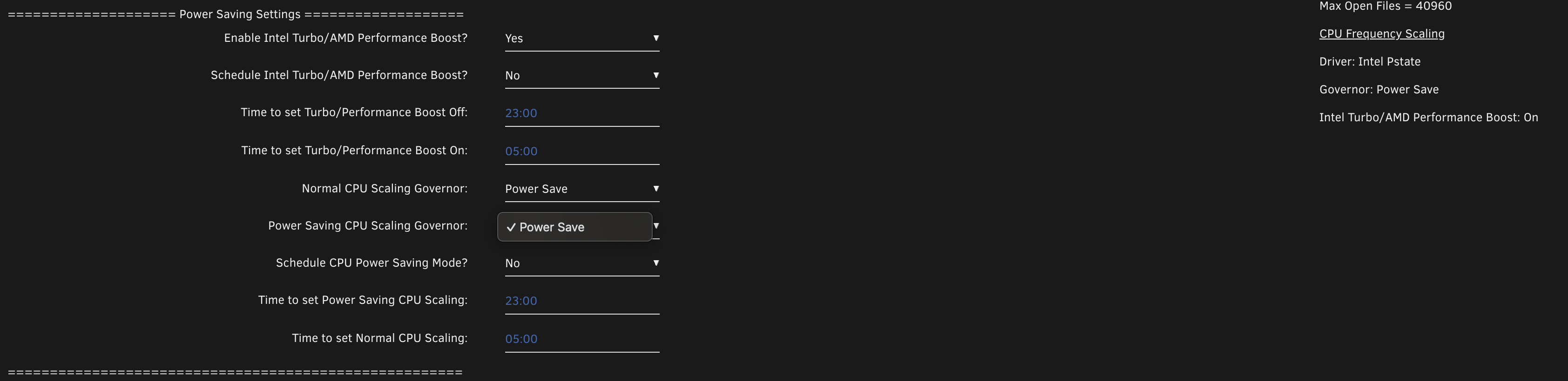

I think this is broken for Intel CPUs.  I am on Unraid 7.0.1 and just updated the plug in today.  I an running an i9 10900.  Before todays update I could select "Performance" for Power Saving CPU Scaling Governor today, my only option is "Power save".  Am I missing something? Also, my only options for Normal CPU Scaling Governor are still "performance" and "Power Save".  I did reboot after the plug in update for good measure, but it is the same.
What driver shows for the CPU Governor?
Under driver it is showing Intel pstate, unless thats not the one you mean? Is there somewhere else I should look for this info?
Edited by dilly120
to include screenshot
These are the governors available for the 'Intel Pstate' driver:
root@MediaServer:~# cat /sys/devices/system/cpu/cpu0/cpufreq/scaling_available_governors
performance powersave
Try that command on your server to confirm.
confirmed.  When I cat 'cat /sys/devices/system/cpu/cpu0/cpufreq/scaling_available_governors' it returns 'performance powersave'
That means those are the only CPU Governor choices for the 'Intel Pstate' driver.  If you saw a change since updating Unraid, then the driver for your processor changed with the latest Linux kernel.
OK so just to confirm, even though in the tips section it is written "If you set the 'Power Save' CPU Governor, you may see your processors stuck at 800 MHz. It is recommended you use the 'Performance' Governor for best performance and power savings." - I simply no longer have that option?
EDIT: Upon further inspection, it seems that no matter what I set the Normal CPU Scaling Governor to (performance or power save) the only change that has any effect on clock speeds is setting turboboost on or off. as seen with 'watch grep \"cpu MHz\" /proc/cpuinfo'.
Edited by dilly120
added more info
That comes from Intel.  They recommend Performance (you have that choice), for best overall performance and power savings.  The 'Power Saving' mode is good for after hours when performance is not important.  You can do this using Tips and Tweaks scheduling.  I also recommend turning off Turbo after hours with Tips and Tweaks scheduling.
Thanks for your time.  I appreciate you explaining it like that, it makes a lot of sense.

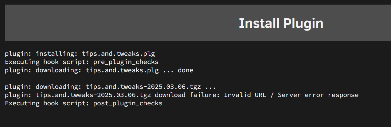

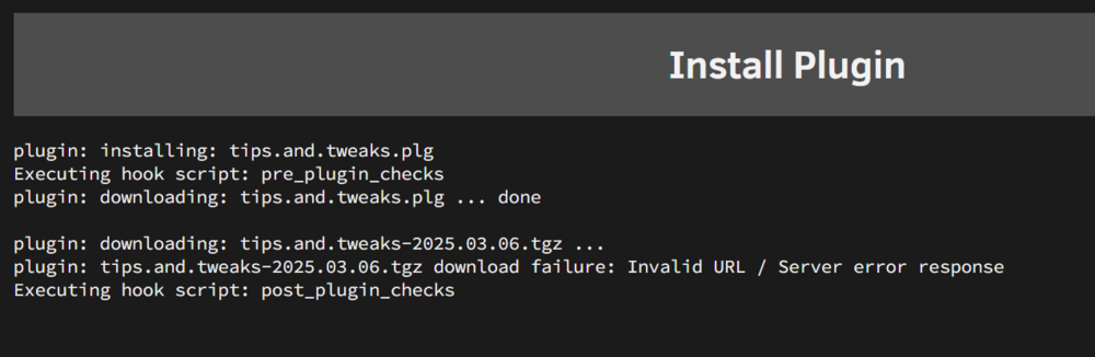

Good afternoon,
Tried to update to current release and it failed.  Uninstalled and attempting to reinstall and am getting this:
DC your dns network settings. when CA plugin file in download its 90% a dns issue. Otherwise, is a misconfigures network setup for unraid and home networking.
set dns to google 8.8.8.8 abnd try again.
