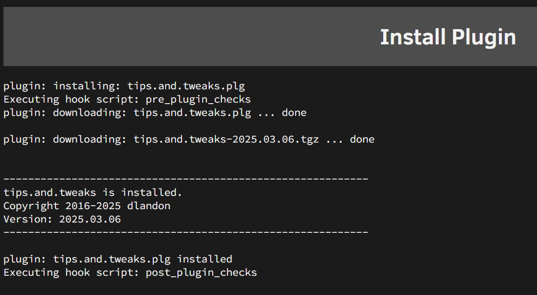

Tips and Tweaks Plugin to possibly improve performance of Unraid and VMs
Try it again.  There was an update to the pluginURL for this (along with cache dirs and recycle bin) and there wound up being a gap in time between the published new URL and when it actually became available
