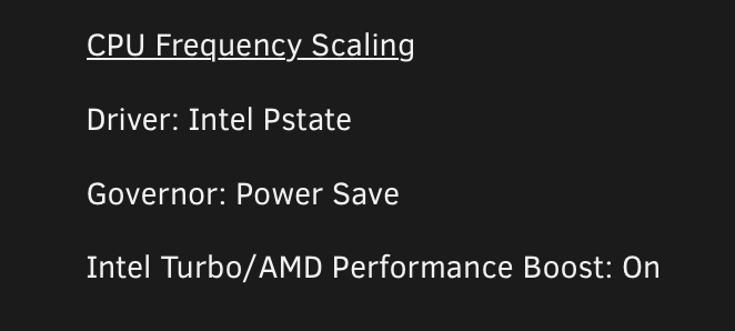

What driver shows on the UI?
CPU Intel 13500H
The issue is if I turn turbo off then turn back on it stays off until a reboot.
It's a minor issue but have seen it on 2x Intel cpus. First one is a 11900T & this one is a 13500H.
Does anyone else experience this? The new CPU is very good at stepping down so not such an issue.
1808809946_Screenshot2024-02-25at15_28_29.thumb.png.c6f5105cbe25a089fdc161cd71e62d34.png
1850571811_Screenshot2024-02-25at15_28_37.thumb.png.3971820c454e2a7b9854fec09cc062b5.png
Turn off turbo boost and then go to a command line and run this command:
/usr/bin/flock -x -w 1 /sys/devices/system/cpu/intel_pstate/no_turbo -c 'echo "0" > /sys/devices/system/cpu/intel_pstate/no_turbo'
Let me know if this command generates any errors.  If there are no errors, does the turbo boost turn back on?
Hmm thanks yeah turbo seems to turn back on with this command as now boosting back up past 2.6Ghz which is the turbo off limit.
Does the right side of Tips and Tweaks show the proper status of the turbo mode when you turn it back on?

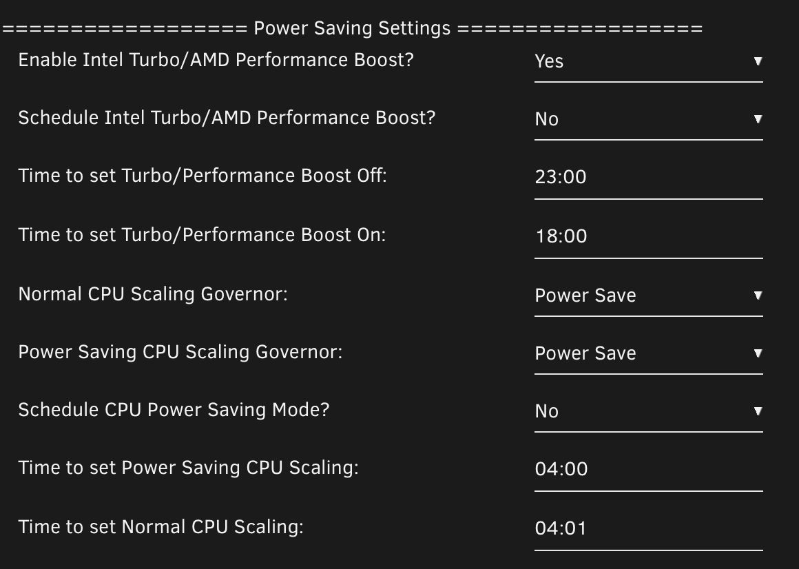

Hey, so I'm new, and this is my first install.
Before fully using it I want to make shure my 12700K never enters turbo mode, can't do this in my BIOS, and while I'm at it, if I can make it go into a low power state while I'm at sleep better. I might as well even consider turning it off, I'll see.
So I landed is this plug-in. After reading through it I came up with these settings:
However I got 2 doubts:
1. This line in the tips section:
If you set the 'Power Save' CPU Governor, you may see your processors stuck at 800 MHz. It is recommended you use the 'Performance' Governor for best performance and power savings.
If during my powersaving schedule I don't care about performance and all I'm looking for is power saving as I wont be using it, is it still ok to set it as I did?
2. From the Normal Governor tooltip
"Performance" - Set all CPUs at full frequency regardless of load. This can have a positive influence on performance and latency.
Will this still comply with the Intel Turbo configuration I set? Like will that "full frequency" ignore my config and push it to turbo levels?
Thanks in advance!
