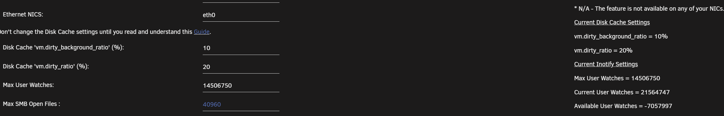

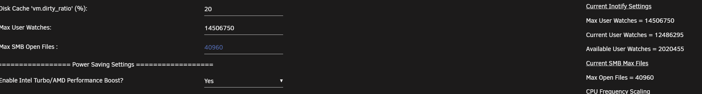

Having huge amount of User Watches ,after disabled plugin Fiile Activity still have Current User Watches = 12486295
is it normal size ?
is it normal size ?
That shouldn't be a problem.  File Activity is not the only process to use Inotify Watches.
Yes i know , but i was thinking after disabled the plugin should be less , but after boot today is even more !
 Pretty normal. Anything you have that 'watches a directory for changes' will add to this list - Plex, Tdarr, Sonarr, NZBGet/SabNZB, Radarr, etc. In the end, it's just a number, albeit one that's useful for keeping the number of disk spinups down.

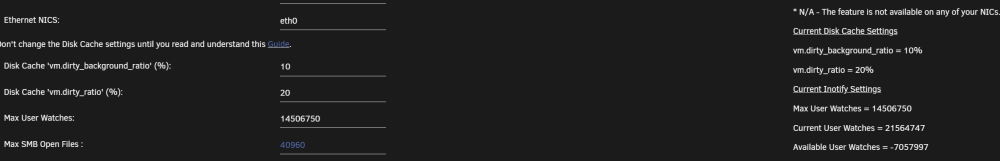

its strange but found :
Because each watch is a structure, available memory is also a bottleneck for using inotify. In fact, a watch can take up to 1KB of space. This means a million watches could result in 1GB of extra RAM usage.
https://www.baeldung.com/linux/inotify-upper-limit-reached
Also when changed to 14506750 i didnt saw memory use increased .... for now i was set back to default ...
That's also expected - watching the filesystem isn't free, for sure! Pretty rare it'd take 1KB/watcher though.

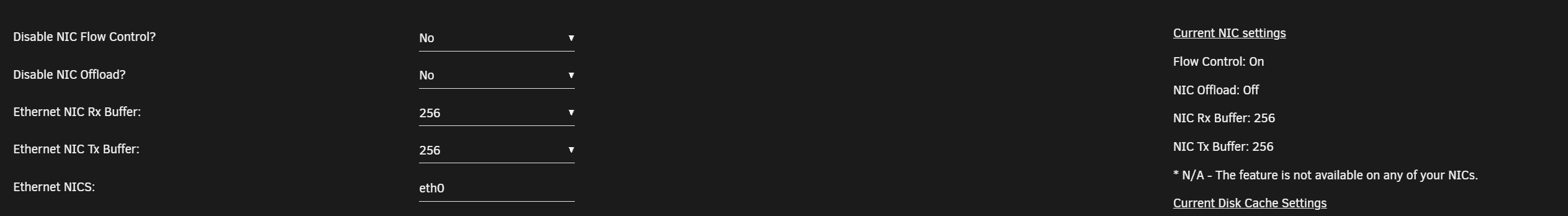

i moved dockers to br1 becose of macvlan problem:
befor i had bond0 of two interfaces and they was both in ethernet nics, now only eth0, should i add also eth1 that is docker network ...
Also interesting why custom network br0 or br1 in docker does not have internet access from local net ?
Yes, if you want to make adjustments to that NIC also.

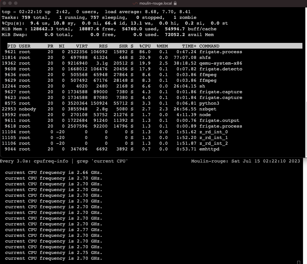

What should I set the governor to for a Ryzen 3700x?
I'm not worried about power or temperature, I just want the best performance.
Load type varies; Plex, MC servers, Home assistant, other dockers, etc.
Seems to be an issue with changing scaling governor. It seems to get stuck on one or the other.
Right now it's 2.24am so it should have swapped to power save.
Anyone else having this issue/s on 6.12.x

What Governor shows on the right side.
Can you switch the 'Normal' mode and see it change on the right hand side?
