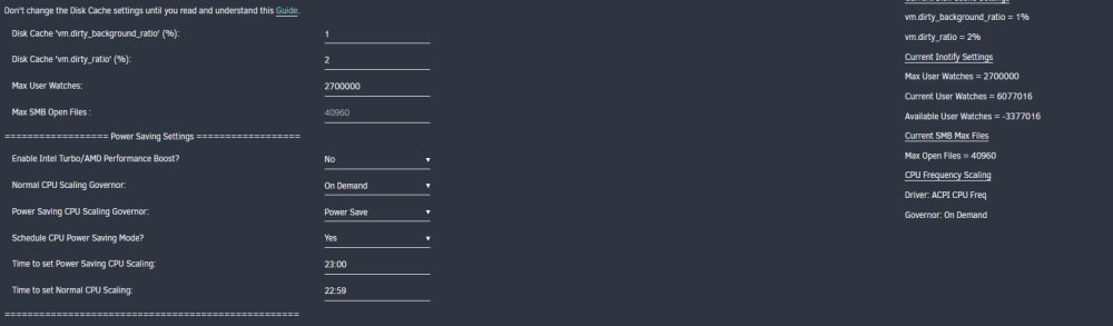

Hi there and thanks for the great plugin and support. I'm not experiencing any issues with it or my system. BUT, should I be concerned about these numbers? 😋
You don't have enough user watches.  Increase the 'Max User Watches' to at least 2,700,000.

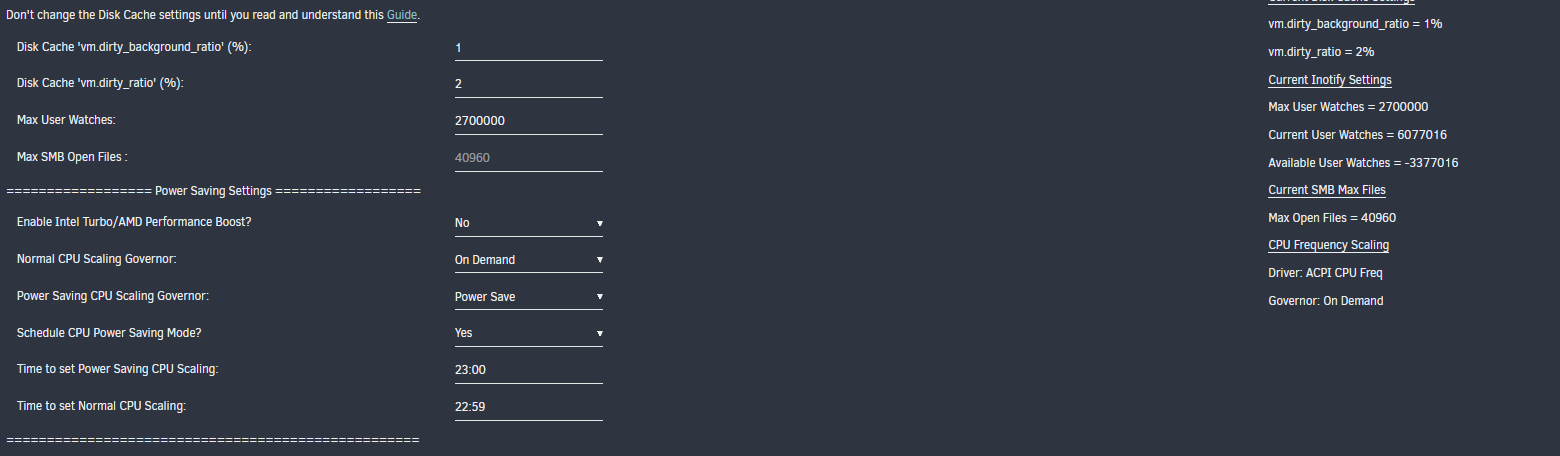

This plugin is the best!  It has saved me so much money.  I'm not sure this is the place to post issues, but I have just have one problem.  It seems the "Schedule CPU Power Saving Mode" isn't working for me.  I made sure my Unraid date and time are correct, set the schedule properly, but it still won't change to "Power saving" mode during the schedule.  I'm on Unraid 6.11.5 with Tips & Tweaks plugin dated "2023.02.01".  I att ached my diag file.  Thanks!
skynet-diagnostics-20230418-0915.zip
Please realize that if you make a change to the settings, the CPU mode be set to "On Demaind" and will not change to "Power Save" until 23:00 hours.  UD sets up crons to switch the mode, but doesn't switch the mode if it is in the timeframe when changes are made.
I previously had it set to 23:00 for "power save" then 09:00 for "Normal (On demand)". So you're saying that the cron won't trigger until it goes past 23:00 or 09:00.  It was set last night before 23:00 but didn't trigger/change when I checked at 07:00. I'll give it a couple more tests and see if I can figure it out.
